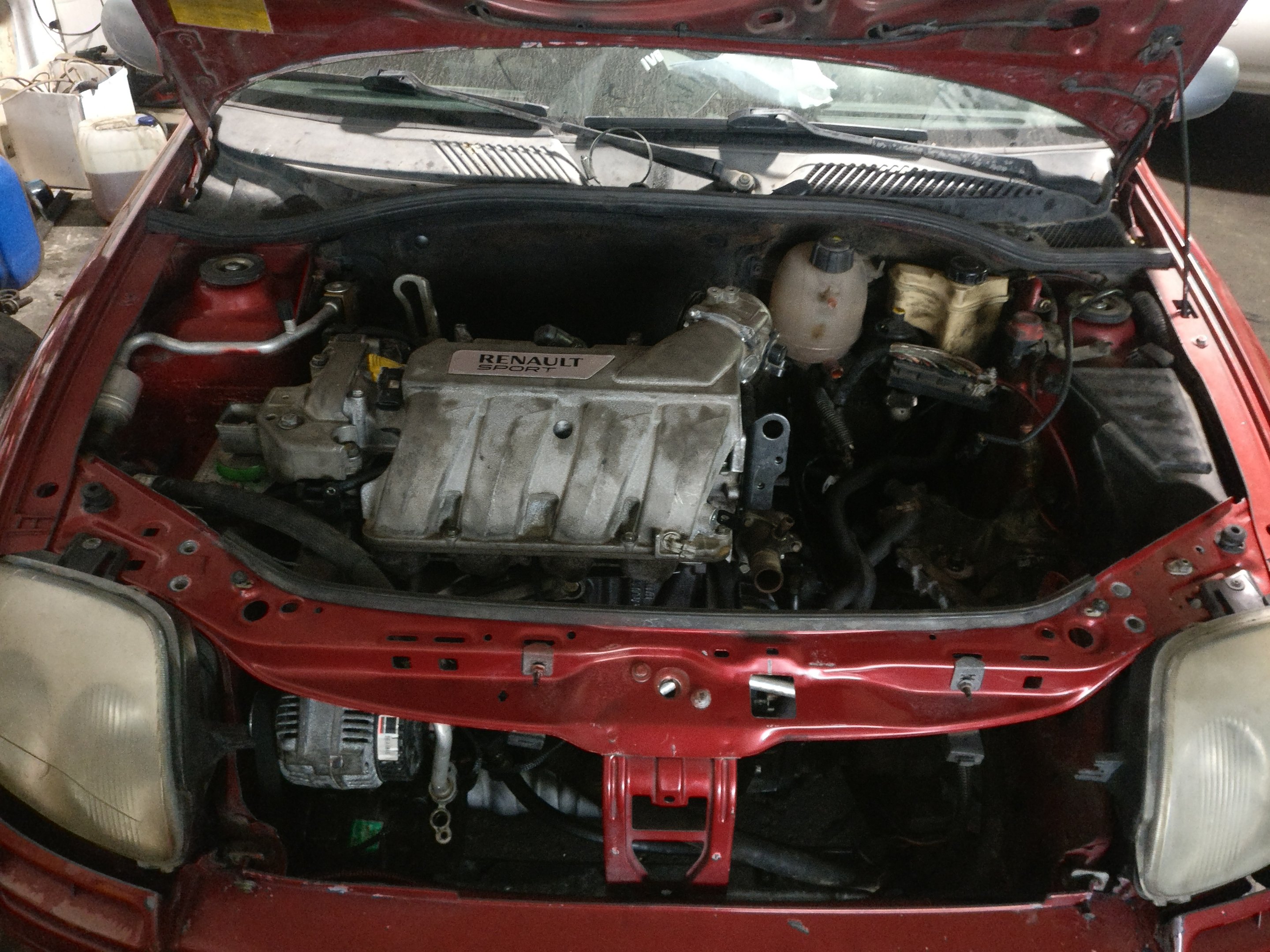

I've took the engine out of my clio yesterday to be more comfortable when I buy the second one. Has anyone the part number for the
OEM Main bearings
OEM big end bearings
OEM valves (or put uprated?)
and seals I need after change the parts. I try an online catalog but without any succes
