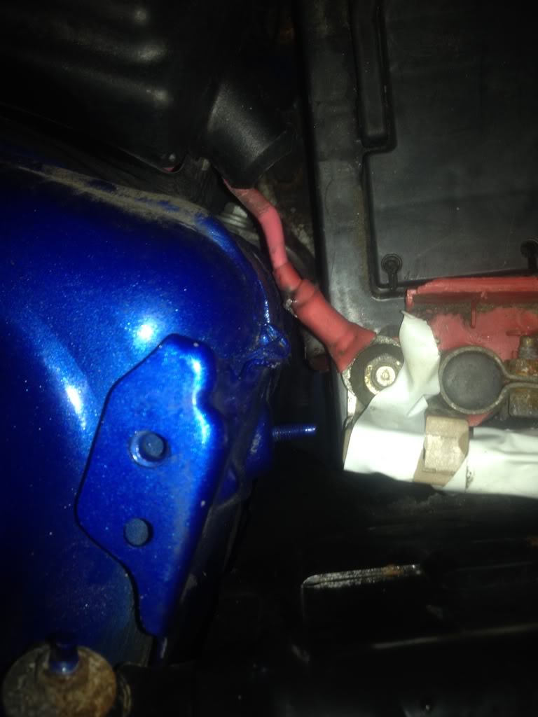

supprised the car didn't set on fire the sparks coming off the battery

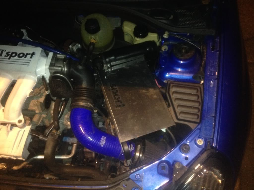

first I thought it was the battery cover joining the + to the ecu cover
until I seen this bugger! The + wire must have been rubbing on the strut tower for a while because it had removed the paint and insulating wire cover
as a temp fox i have covered the wire in a lot of insulating tape but what can I do as a more permenant fix?
