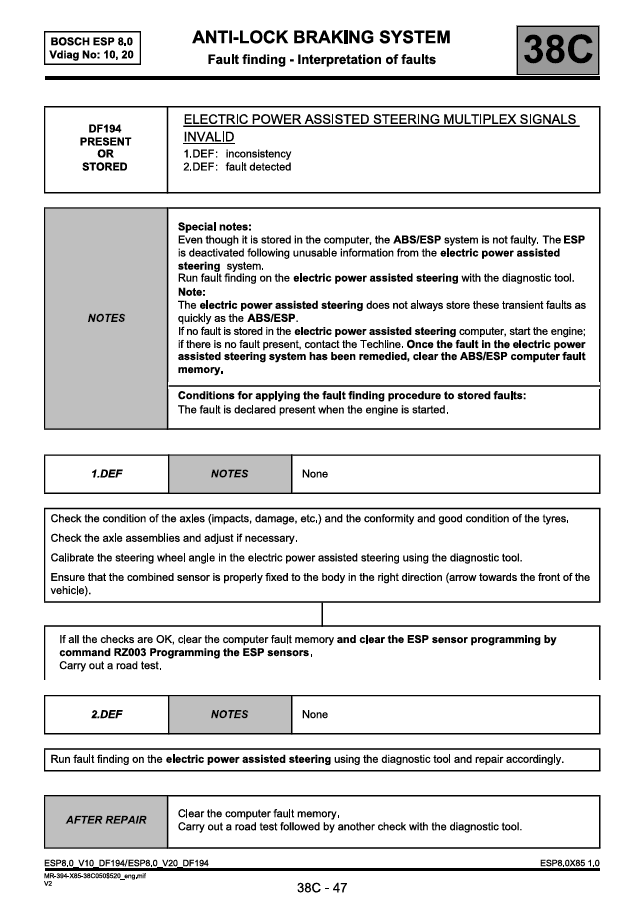

hi, im getting this on icarsoft, DF194 Multiplexed Electric Pas information invalid, incoherence.

hi, im getting this on icarsoft, DF194 Multiplexed Electric Pas information invalid, incoherence,

Found this now from the workshop manual.

thanks for your help, i take it the solution will need Renault clip to clear memory, and the tech line will be Renault? where will the combined sensor be located? thanks again
Try clearing it with your code reader.
I'm guessing everything is factory and you haven't messed around with the steering wheel or something.
Does the car steer straight? Had an alignment recently?
Can't see it being the combined sensor it mentions unless the car has been stripped out and it removed.
Not sure where it is on the Clio 200, but on others it's around the handbrake/centre console area. A little box with an arrow on it.

i believe it had a new return spring fitted before i had the car but cant be sure but yes stock rs 200 i think
Mr Trailer Man
yes been coming on all the time i had it ive been chasing the abs/esp lol
You'll have to get the steering angle sensor checked.
You should be able to read the angle with the iCarsoft reader. It might be under the sas reset function.
If it has a crazy angle reading when pointing straight ahead, it might be dead but worth trying to reset it to zero.
