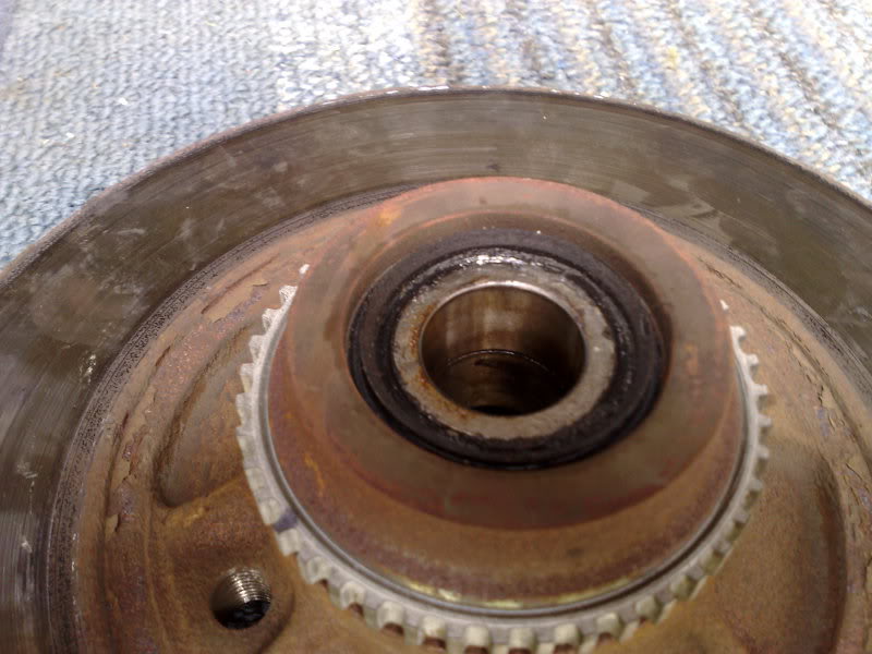

Is there a part number for this washer just incase I need it?
Also is the bearing the same both side or does it have a rubber bit, as below, the whole way round
You can kinda see it

It looks like youve got a bit of a lip on them discs, Id get some new disc (which incluide bearings) from Renault. They have recently dropped the price.
