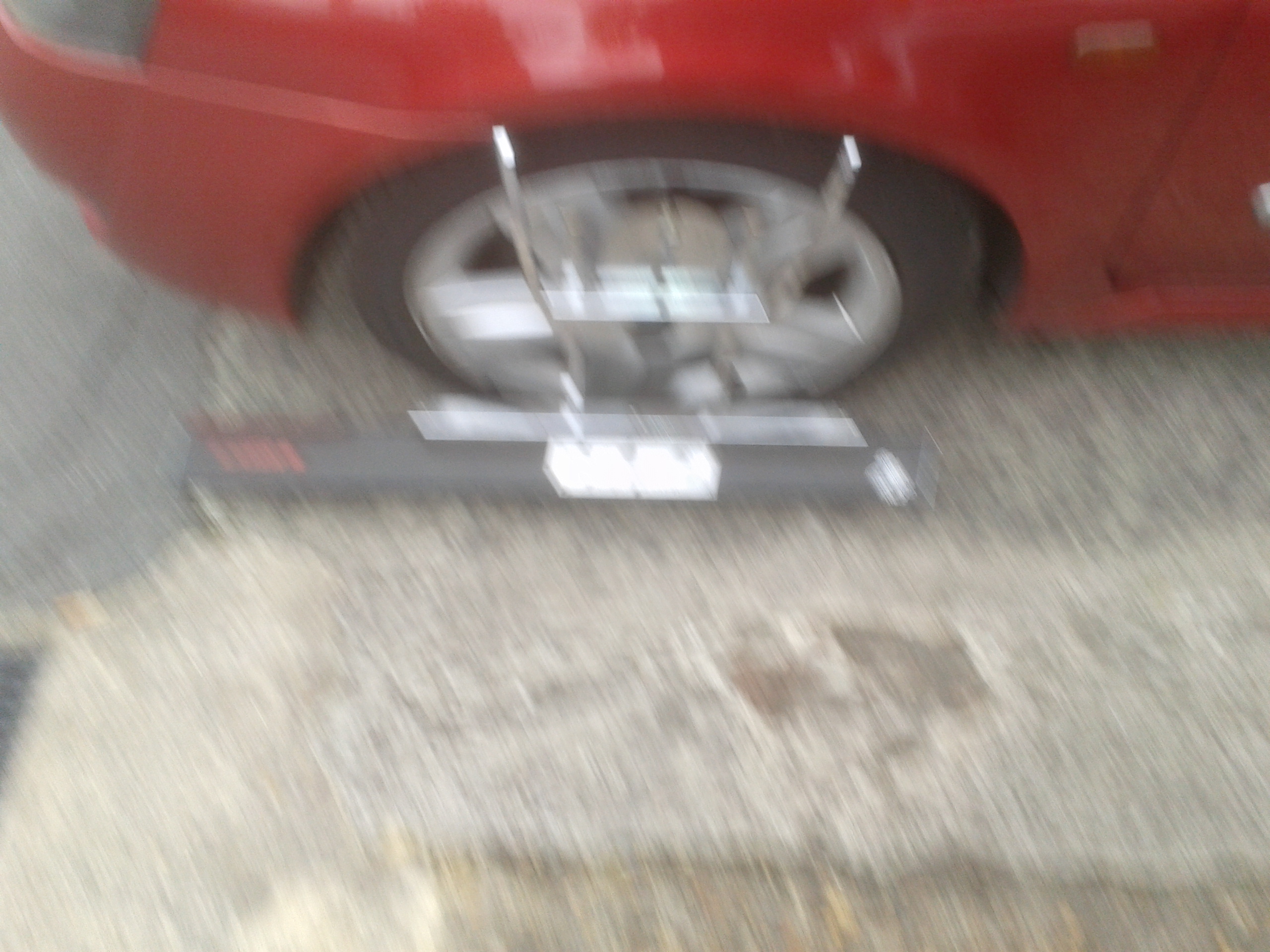

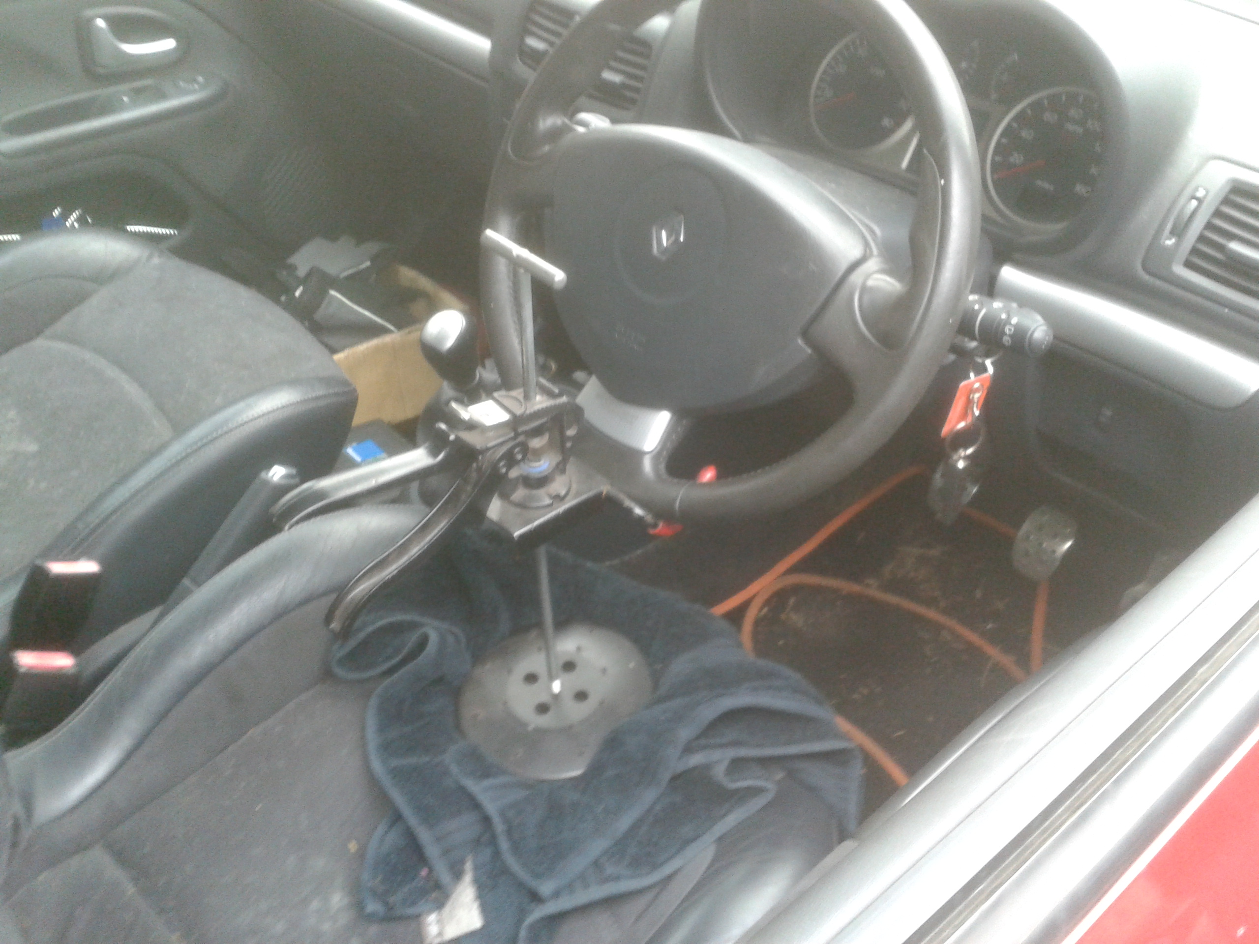

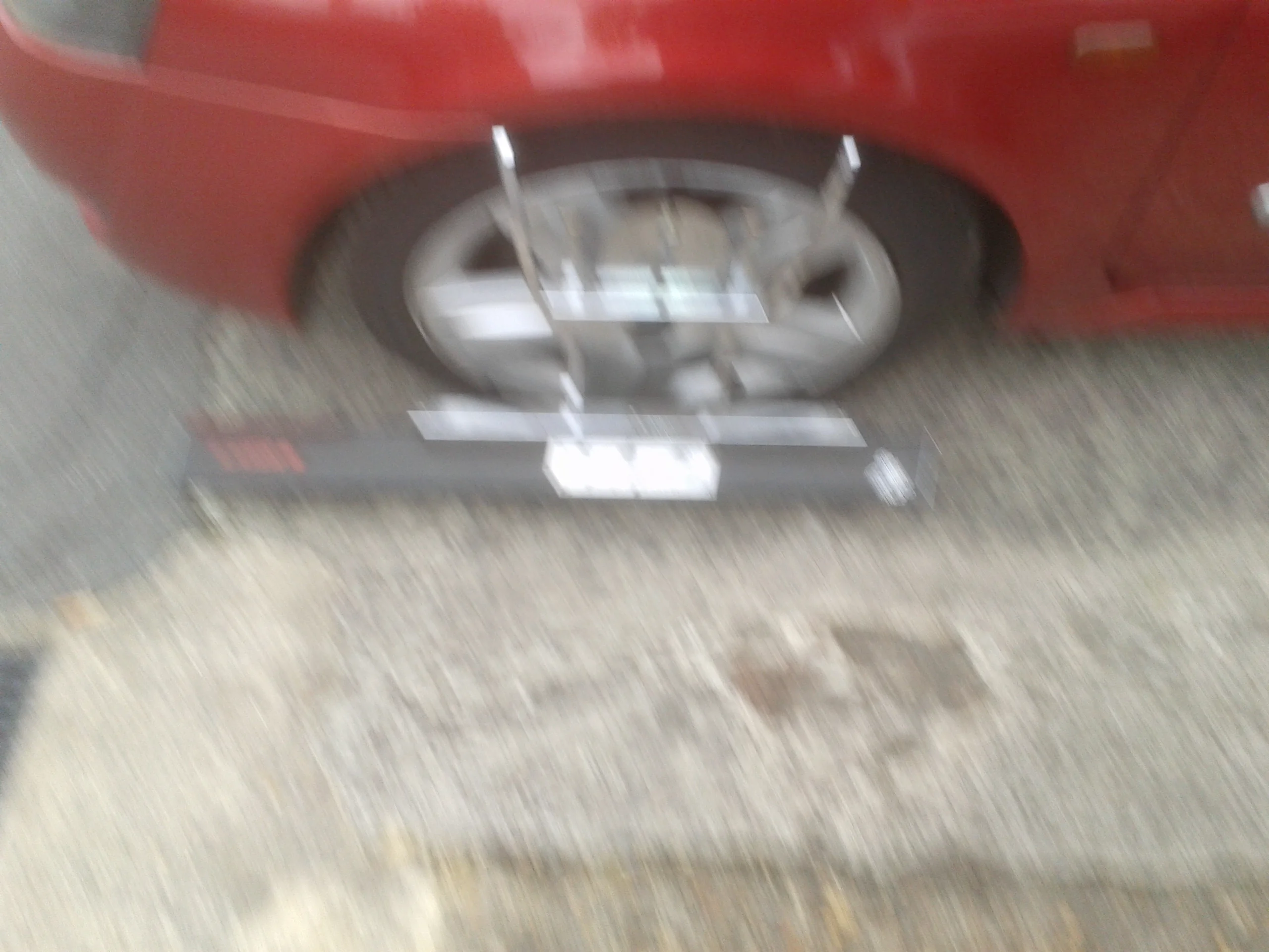

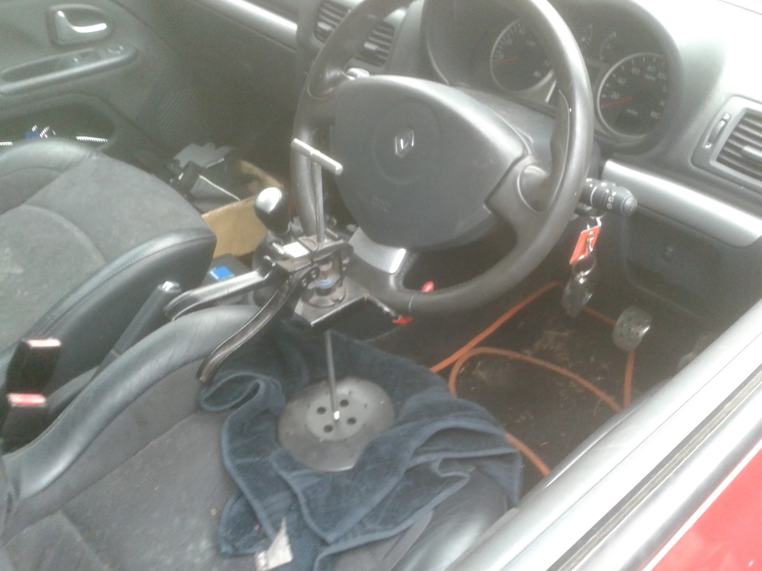

tracking 2.jpg tracking 1.jpg I can recommend Ruislip tyres in Ruislip Manor,HA4 8NS in North West London to do a proper job for £30 including adjustment on a Clio.
