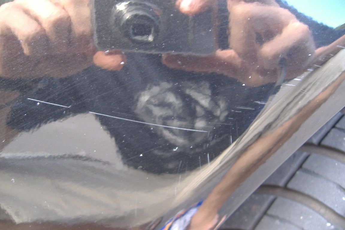

got a pic of the worst ones need to get shifted. Bat died on me camera so couldent get the rest
these are the worst ones. will scratch x make a good effort or mininising these
Is that primer showing through? Does your nail catch in it? If you wipe a damp finger over it does it seem to disapear?
If that's not primer it's a bloody good gouge in the clearcoat!! Will take approximately 10 years to do by hand with scratch x. lol.
I doubt it is correctable with scratch X or a pc, will need paint by the looks of it.

How deep are they? - If they are deep enough to catch a nail in you wont get them out as a rule.
no not deep atall, still blue! just like scratch in the clear coat, you can only see them in some light/angles but i know they're there!
soz havent got bk about the pic. It looks a lot worse in the pic but ive had a feel of it and some of the scratches are worse than others. but i did what Rich asked bout them catching on the nail, some do do slightly but nothing deep and others dont some do disapear a bit when you rub a wet finger over them. think it old polish stuck in them.
most of them just look like scraches in the clear coat
do think id be able to get them out?
Cheers Dave
The ones that catch will not polish out, the ones that disapear when wet should polish out.
