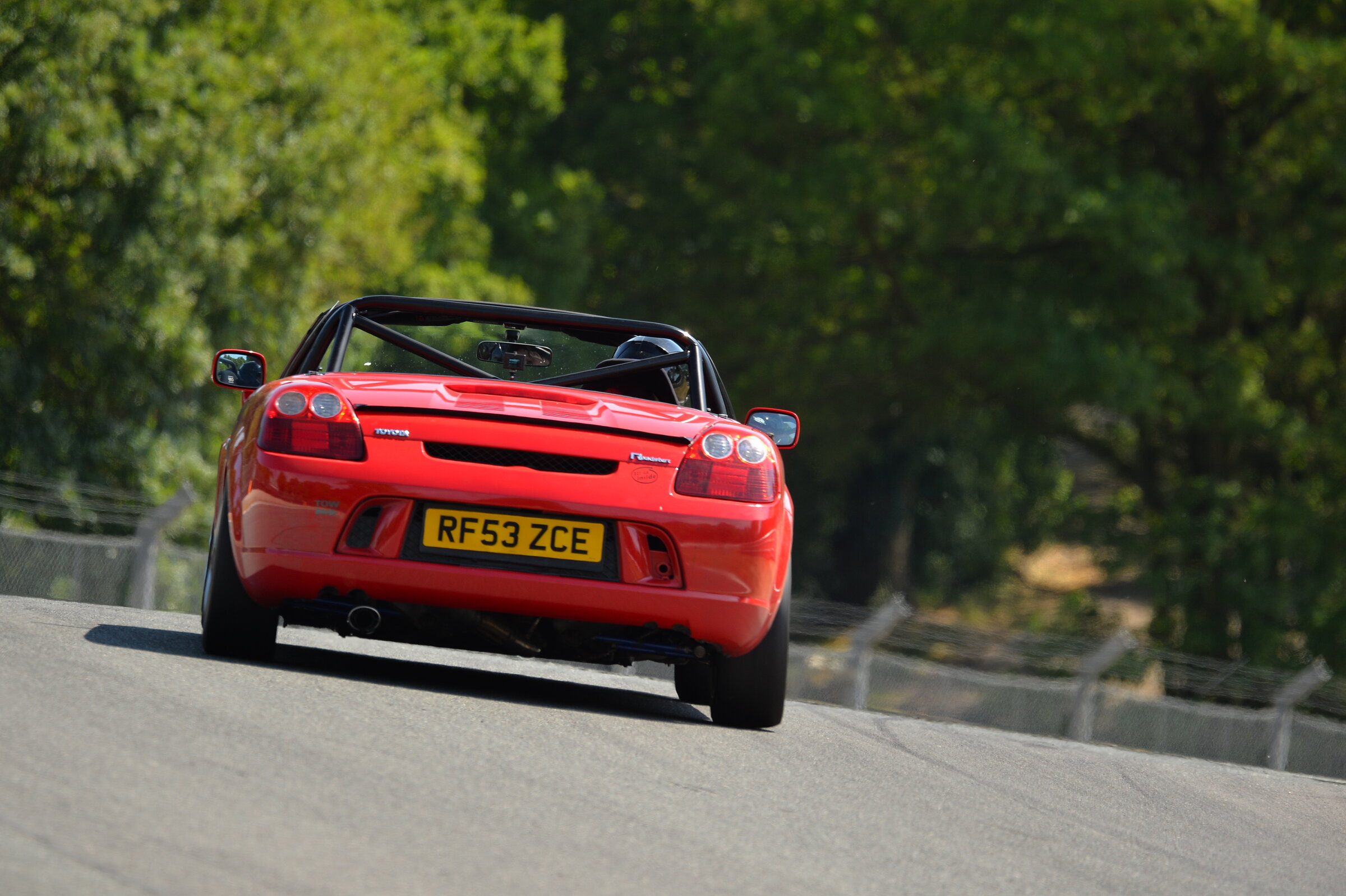

Ive heard this a lot about spring rates and slicks. I'm running pretty basic coilovers in Meister R's with what are considered very soft springs 5kg front/7kg rear and was worried about how the car would perform on track using slicks. No issues what so ever, even temps across the tyres and performed really consistently. Entry to Lodge at Oulton park below at full tilt and coilovers not even set and max damping. Looks pretty flat for the rates I'm running, could be running a bit to much rear camber at -4 as the OSR tyre hasn't got full contact to the track. Maybe the ARB's, full chassis bracing and 6 point cage helped keep it flat? I don't feel the need to up spring rates anyway.

As you say, with chassis bracing, cage, ARBs etc you've already got a pretty stiff car and a mid engine car is always going to have an advantage. The key to slicks is getting heat into all 4 of them evenly. Difficult if you have the nose diving at every corner and all the weight transferring to the loaded wheel all the time, especially on a FWD car.
Mr Trailer Man
Plus the MR2 will have a completely different roll centre to a lowered Clio.
That's the main issue with Clios, you fit coilovers but then need to correct the roll centre in order to bring some of the handling back.
