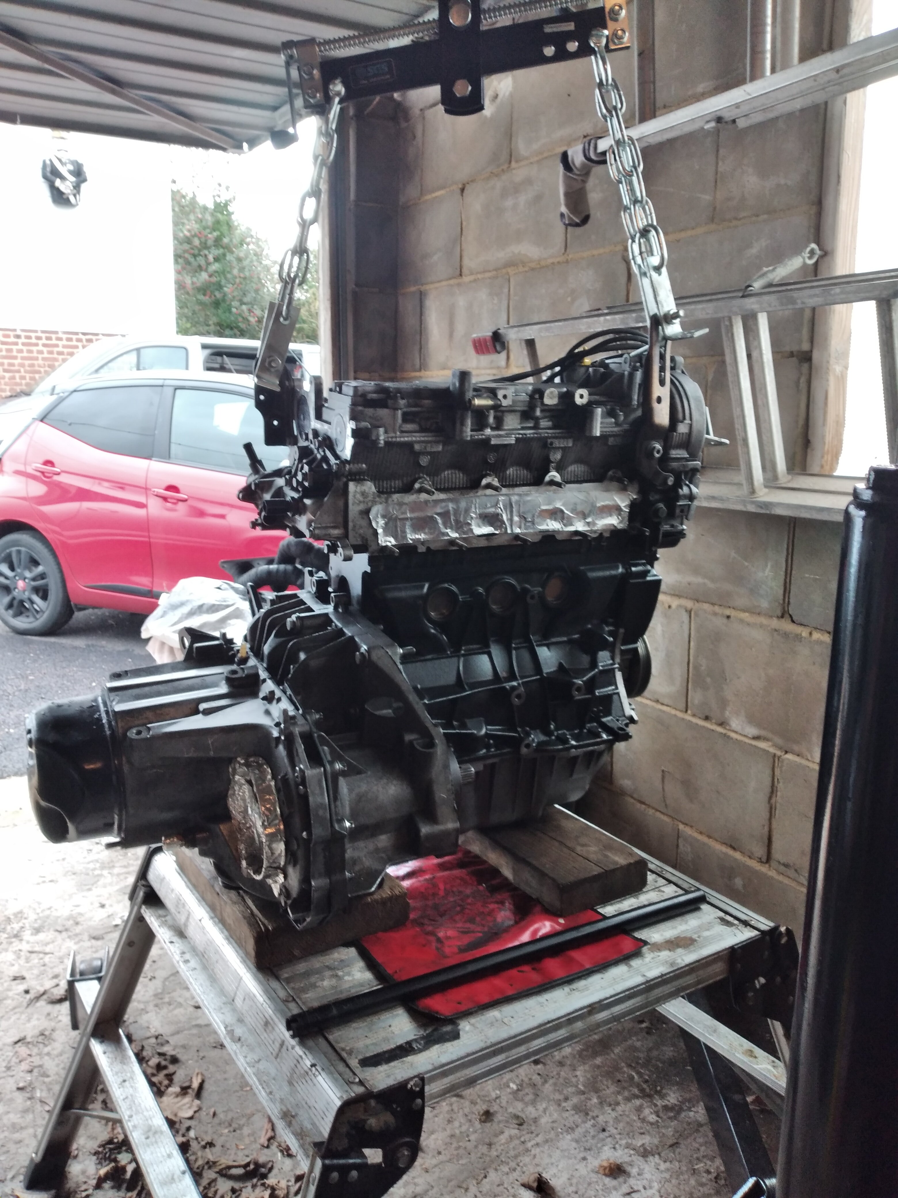

While the engine's out I've had the intake manifold vapor blasted and am currently polishing the tracts.
I've ordered a 64mm throttle body, which doesn't sound much increase over 60mm, but if my school boy 'pie are squared' is correct is almost 14% increase in intake area.
I have DEI titanium super duper lava rock exhaust wrap for the manifold and decat pipe!
I've read that these mods will gain me at least 75bhp:)

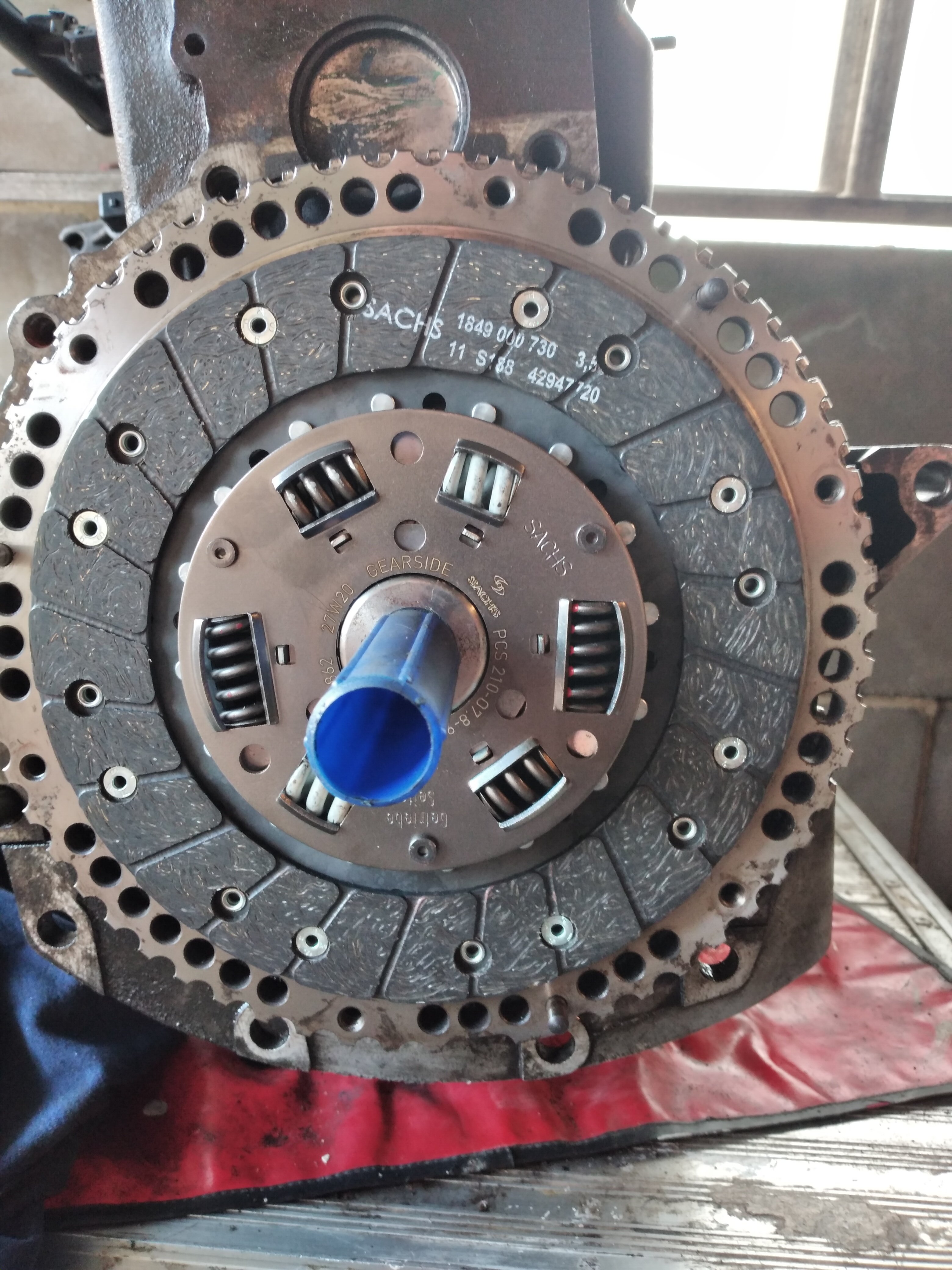

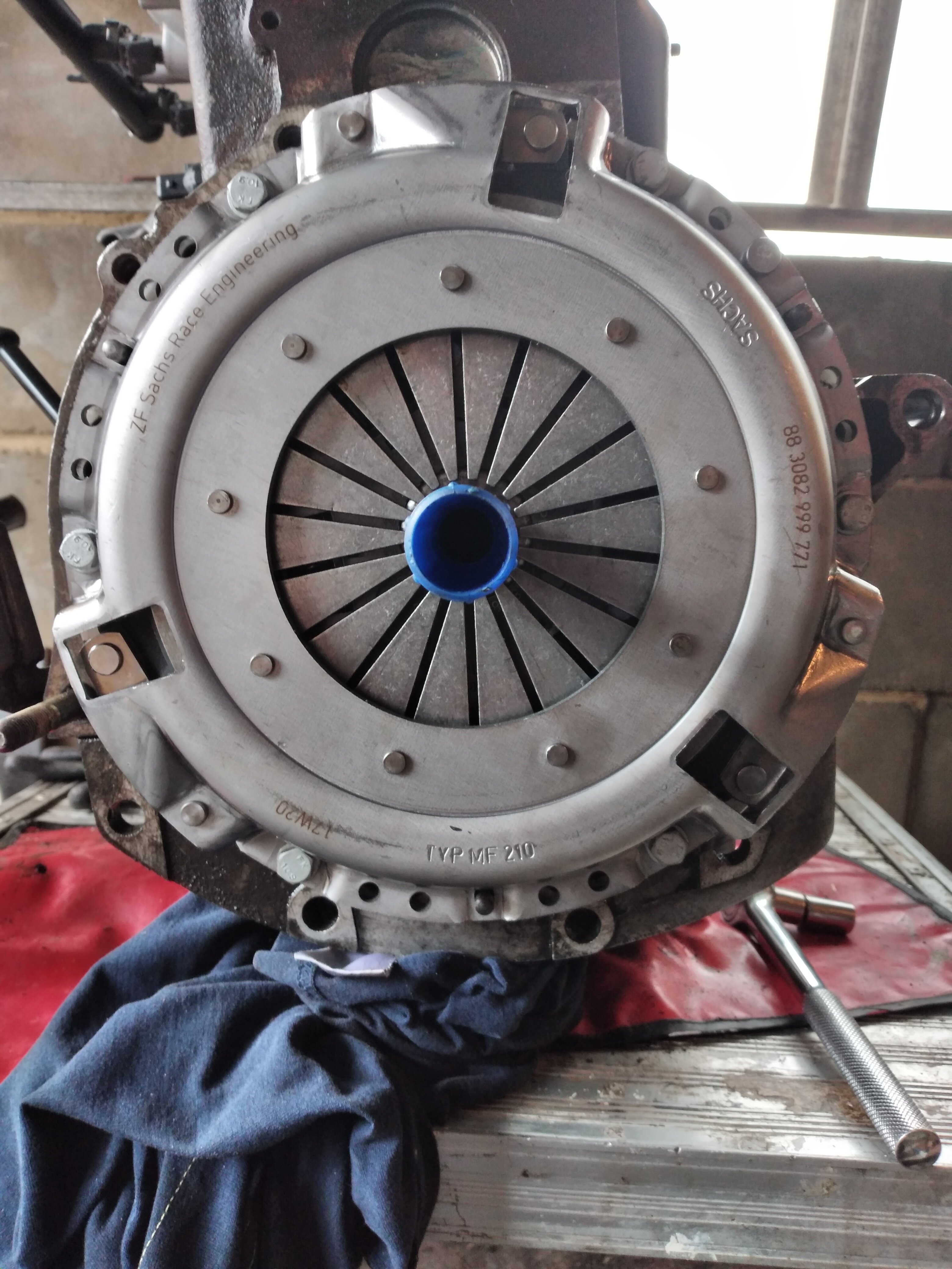

Before buying the Sachs clutch I spoke at some length to Nick at PMS about the flywheel and clutch.
Reportedly there is no historic or physical reason to blame the flywheel.
We also discussed using one of my two perfectly good friction plates in a Sachs cover, but after a measure up they are both thinner from new, and clamping force could be compromised.
It seems the Sachs clutch cover up to some pretty severe abuse, but I hate the idea of fitting a stronger part just so I can carry on beating the s**t out of it. I do try to be a mechanical sympathizer.

Sachs Clutch fitted

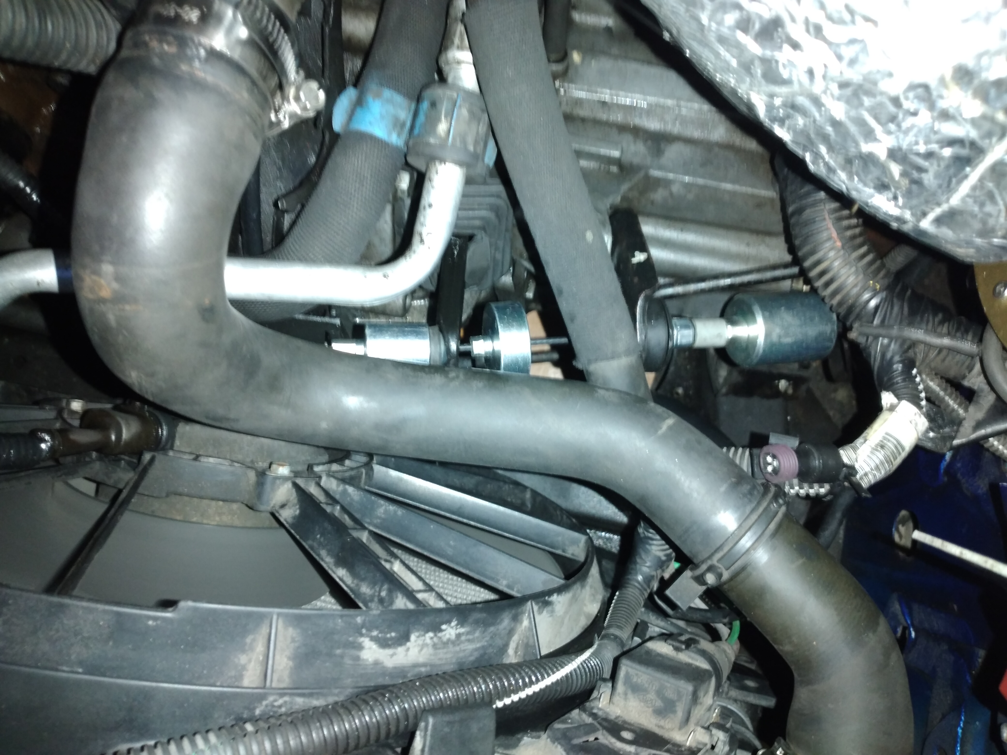

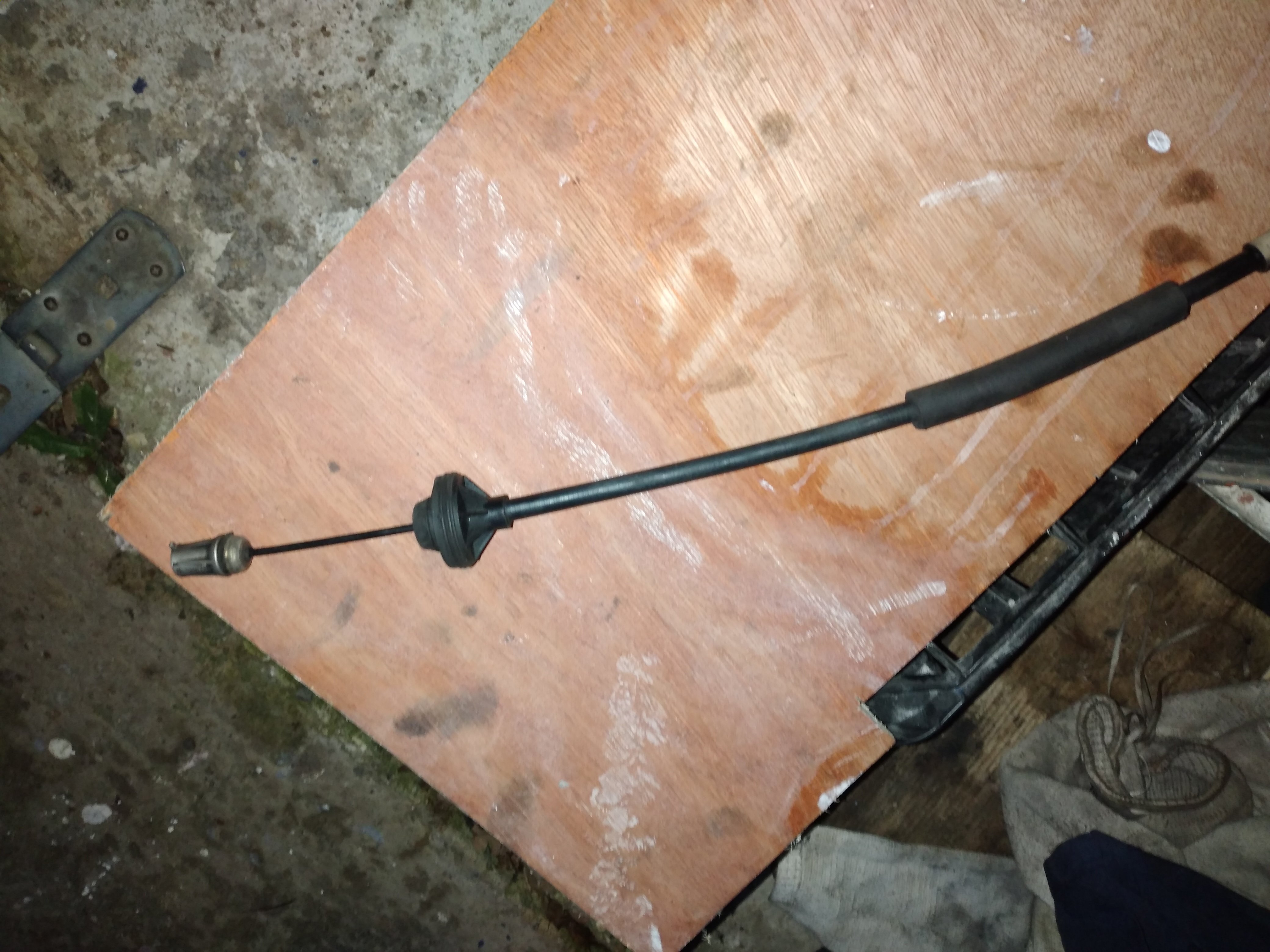

I just want to eliminate the cable, which I have replaced with a new one that is supposed to be OEM, and has all the fandangly damper bits on the end. But the one I took off, which I though was OEM has none of that.
Please see pics below. Can someone confirm which is the genuine article:
New Cable
Old cable
Many thanks
Andy

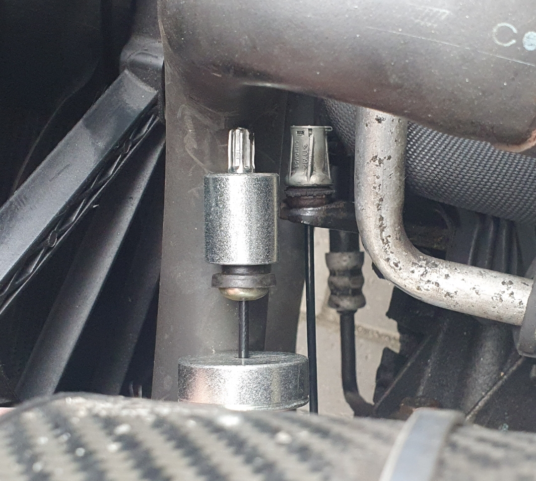

It's a few years late but I found this thread through searching trying to find my issue with not being able to get into gear when engine running, or when off and put into gear it would move when starting because of not disengaging.
I bought a new cable from RPD and I too was confused if I had the correct one but couldnt find anything here about it. I had bought the top photo but the one on the car was that of the bottom photo.
Using the guide on here to change the cable, I found it extremely good and am amazed, like yourself at just how much free and decent knowledge this forum has between all of its members, a true blessing to the Clio enthisiast.
However after changing my cable, it won't engage as said and I need to find out why?

These are the 2 clutch cable ends

There are the 2 clutch cable ends
Quick update.
Sachs Clutch fitted
Gearbox re-fitted and ready to go back into the car
I'm happy to report that having fitted everything back into the car, drip-fed the gearbox the special MT-90, and re-filled the coolant and PAS fluids I finally plucked up the courage to start it.
Bloody hell.....it all fired up okay and after bleeding coolant and PAS I tentatively drove it forward and backward and it works!

One thing that is immediately noticeable is that the clutch is so much harder to depress. Think I'm going to have to go to the gym! It won't be a problem on the track, but i don't think I'd want to use it in stop-start traffic.
It makes absolute sense that a clutch that can transmit more torque would have heavier springs, and therefore be harder to release.
I was surprised because this is a 350nm clutch and I had a 1000nm clutch in the Subaru which was lighter on the pedal, but that was a hydraulic system.
So really I'm asking can anyone else with a Sachs clutch confirm that it's a lot heavier on the pedal?
New Cable
Old cable
Many thanks
