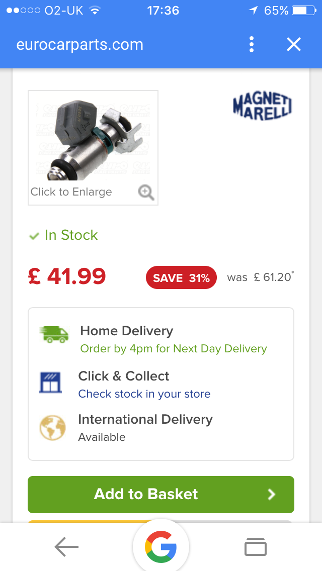

See look 41.99 at Euro car parts EACH!!

Went on line and chucked a promo code in to get the discount price. £38 of the top of my head. Phoned them up and said I know others have had them cheaper and he done it for £32 with out arguing.
I did order a few other bits so might not work out so great with postage if your only ordering 1 injector.
