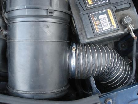

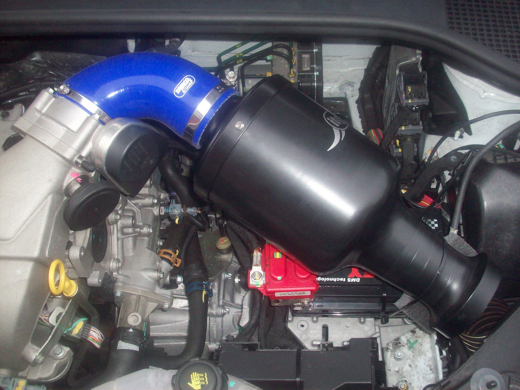

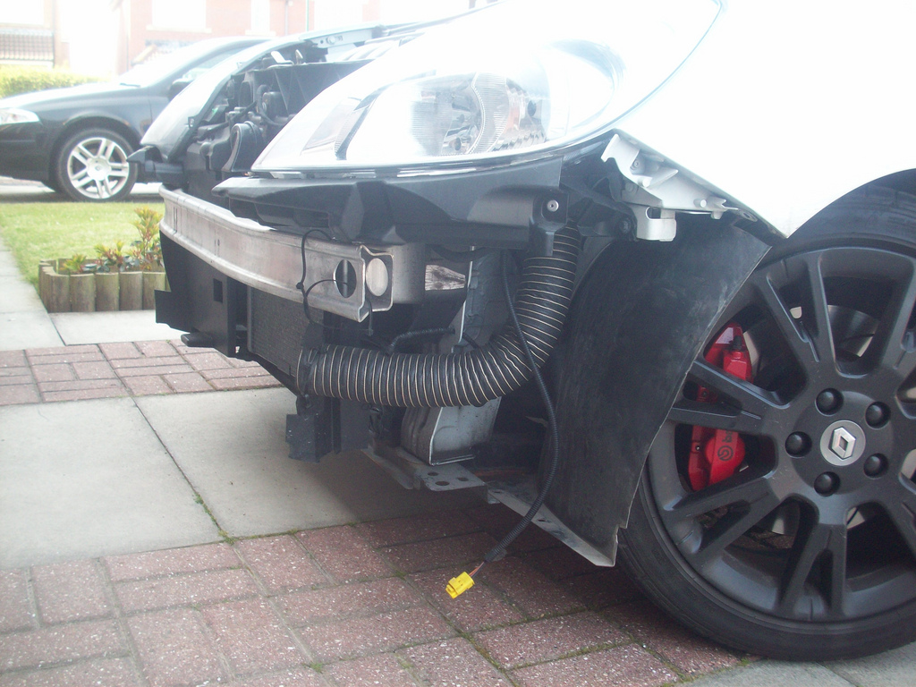

i fitted a smaller battery to my 197 to free up some space and fit a CAF
plenum temps by scott1532, on Flickr
maxogen setup by scott1532, on Flickr

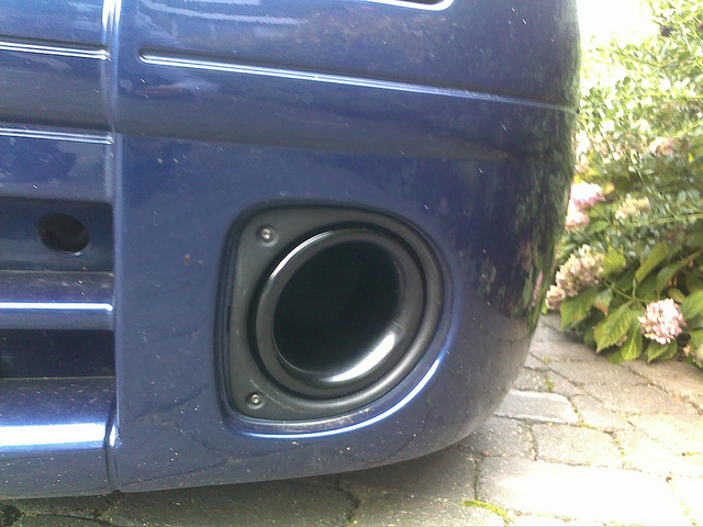

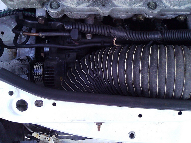

V6 cold air feeds i did on 2 of my phase 1 Clio 172s
The first i ran down to the passenger foglight.
Sony 018 by Ricard o1, on Flickr
Sony 015 by Ricard o1, on Flickr
04092010618 by Ricard o1, on Flickr

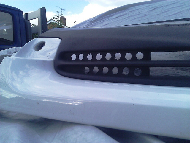

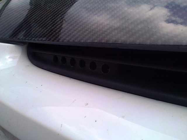

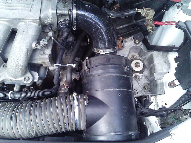

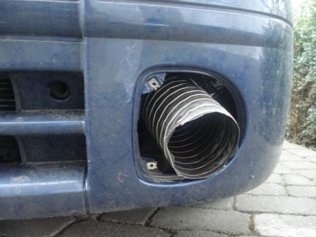

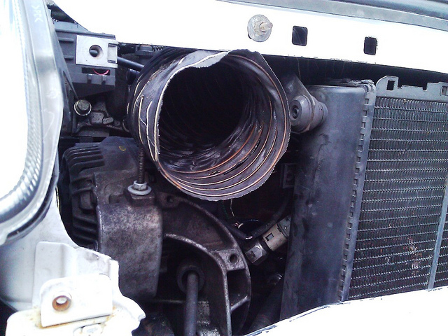

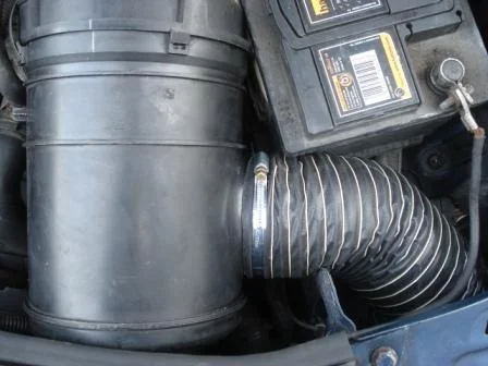

I did this setup on my white track Clio 172
Same airbox, but directed the 100mm diameter air feed from the drivers end of the grill
WP_000488 by Ricard o1, on Flickr
WP_000419 by Ricard o1, on Flickr
WP_000418 by Ricard o1, on Flickr
WP_000438 by Ricard o1, on Flickr
WP_000436 by Ricard o1, on Flickr
