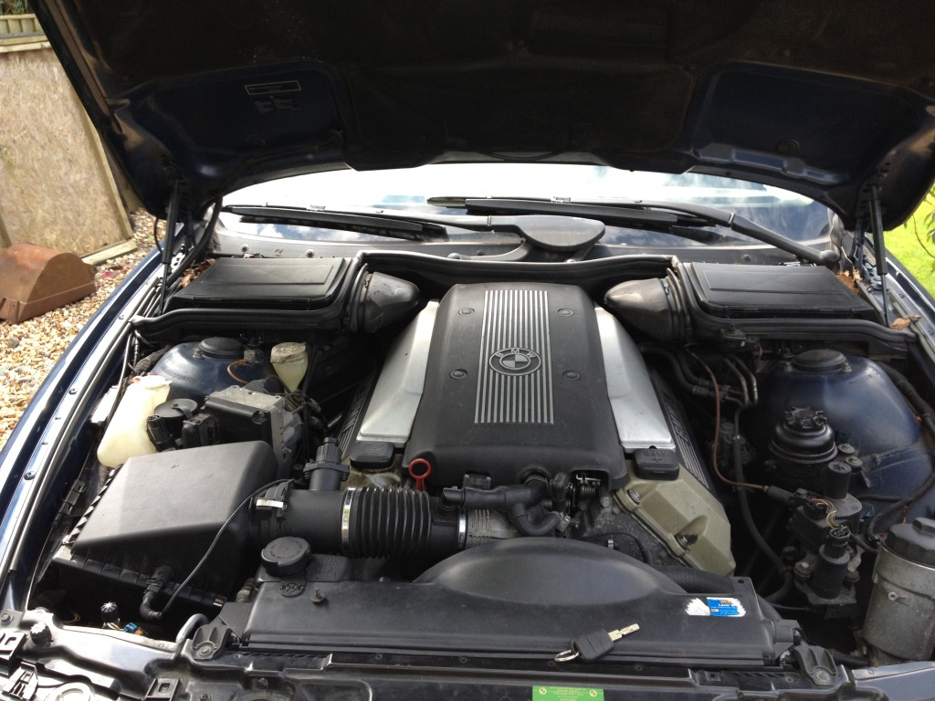

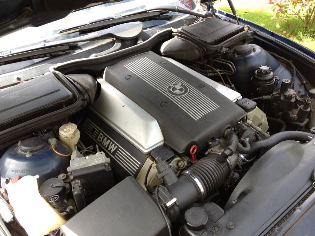

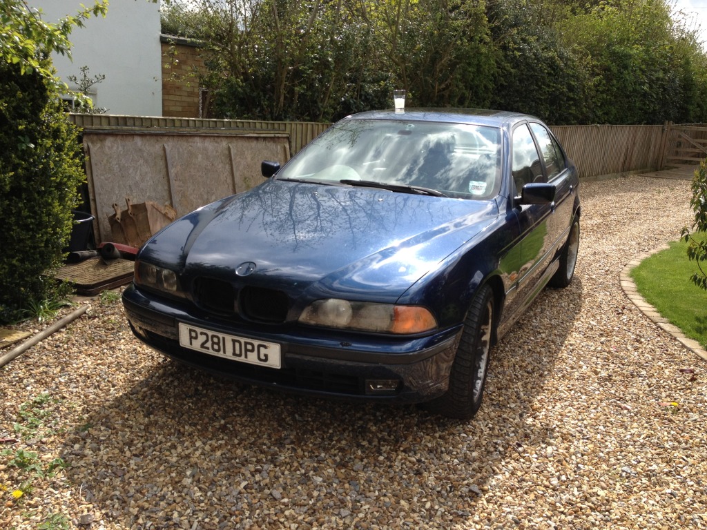

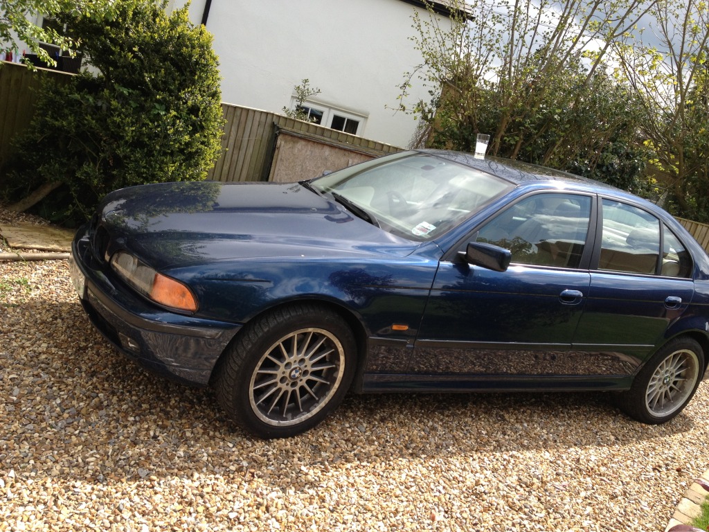

Now that I am about to finish University I can be at home and finally start on a new project, i found a bmw 540i with a 4.4 v8 for next to nothing so I had to get it. The plan is to use it as a donor car for an e46 coupe which hasn't been found yet but on the hunt for any cheap coupe.
Here is the car when i got it back home ...
Lovely looking engine, cant believe how good it looks for the age and milage
