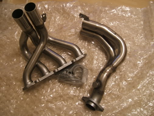

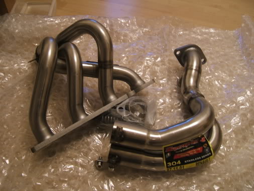

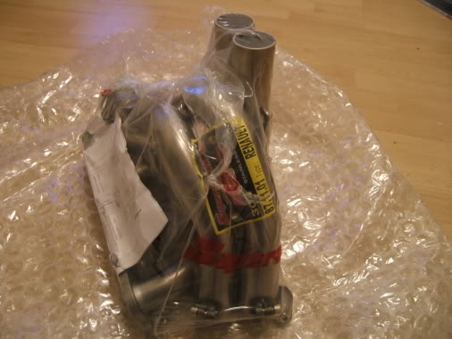

ive had the conversion done on 2 valvers and they were but plug and play. got to agree with the valver manifold being s**t on the 2.0l, reckon mines not up to scratch with it on, seems to be down on torque with it on so went and bought i of these this week...

you get them from k-tec although they call them ktr manifold.. thier about £300??? i bought mine second hand for 170.
