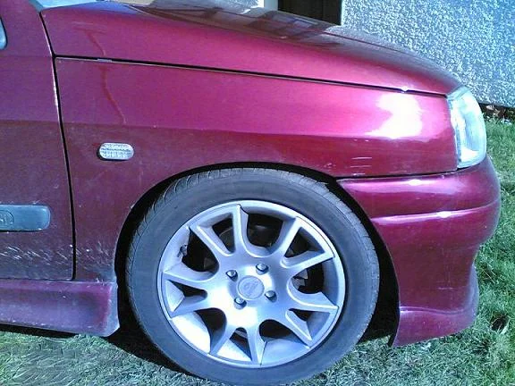

I got a phase 3 (With the different headlights) I wanna put 16v front wings on (Only £75 pair from Renault!) I know they will go on, but it's just where they meet the light, I might have a bit of trouble. Can someone PLEASE post a close up pic of their valver wing where it meets the headlight, so I can see if it will fit my phase 3. Thanks! :D
it wont! lol
As Tom says they won't fit unless you get phase 1 or 2 headlights with indicators and a phase 1 or 2 bonnet all of which is cheap unless you want a valver bonnet
You can keep your phase 3 bumper on when using the phase 1/2 headlights and bonnet
Thanks for the pic Tom. Looking at it, it looks VERY similar to mine. It might fit, if not, just a little modding I think....
