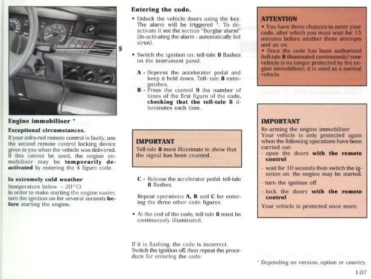

MK1 PH2 Valver,on the wipers switch theres a lil button on the end?has any one got a clue wat its is?looks like cruise controll or suomething lol,press it and it doesnt work??any 1????
If your car is fitted with a factory alarm/immobiliser it allows the ultra-sonics to be disabled while still allowing the alarm to function, for instance, if you were leaving a dog in the car.
Mat.
are you sure on this button, i have heard so many views on what it does....
thought it was a universal part that worked the trip computer on the 19's and 21's
thats what i was told when I had mine, it did nothing on the valver (m reg car) mine didn't move at all (you couldn't push it in)
Arround 95 on it was there for the immobiliser.
