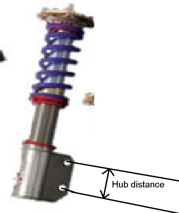

bit of a noob question, whats stud spacing?? wher can i find out mine?? or is it 54 mm on all phase3s?

Sounds like it you need to measure this distance on your hubs but they are likly to be 52 or 54mm. You measure between the center of both bolts.
