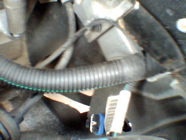

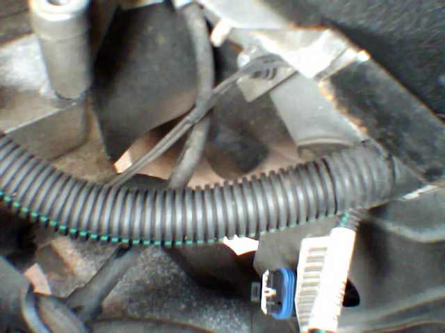

Heres a few rubbish pics...in the top left hand corner it seems thats where the problem is.... Please excuse the shite pics... i think my mom got the camera out a frosties packet...
Kiza

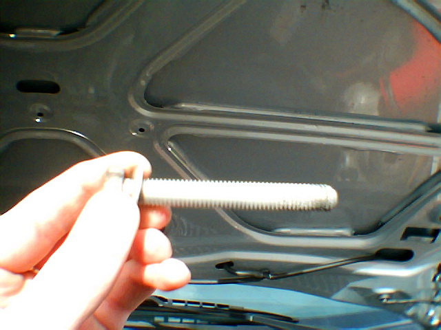

Back to the top lads... Have had another longer look and have thought...could this be the gearbox mount??
Kiza
:dapprove: I got the mechanic round from next door earlier on tonight and he confirmed my thoughts...a bolt had been forced out of the gearbox and pulling all the thread with it...He managed to tighten the bolt up a tiny little bit which means there is the tiniest bit of thread left in the bottom for it to hold on to...so now its time to say good-bye to the clio!! I was getting rid of it after FCS anywayz but now it cant wait as i havent got £400 for a gearbox...
