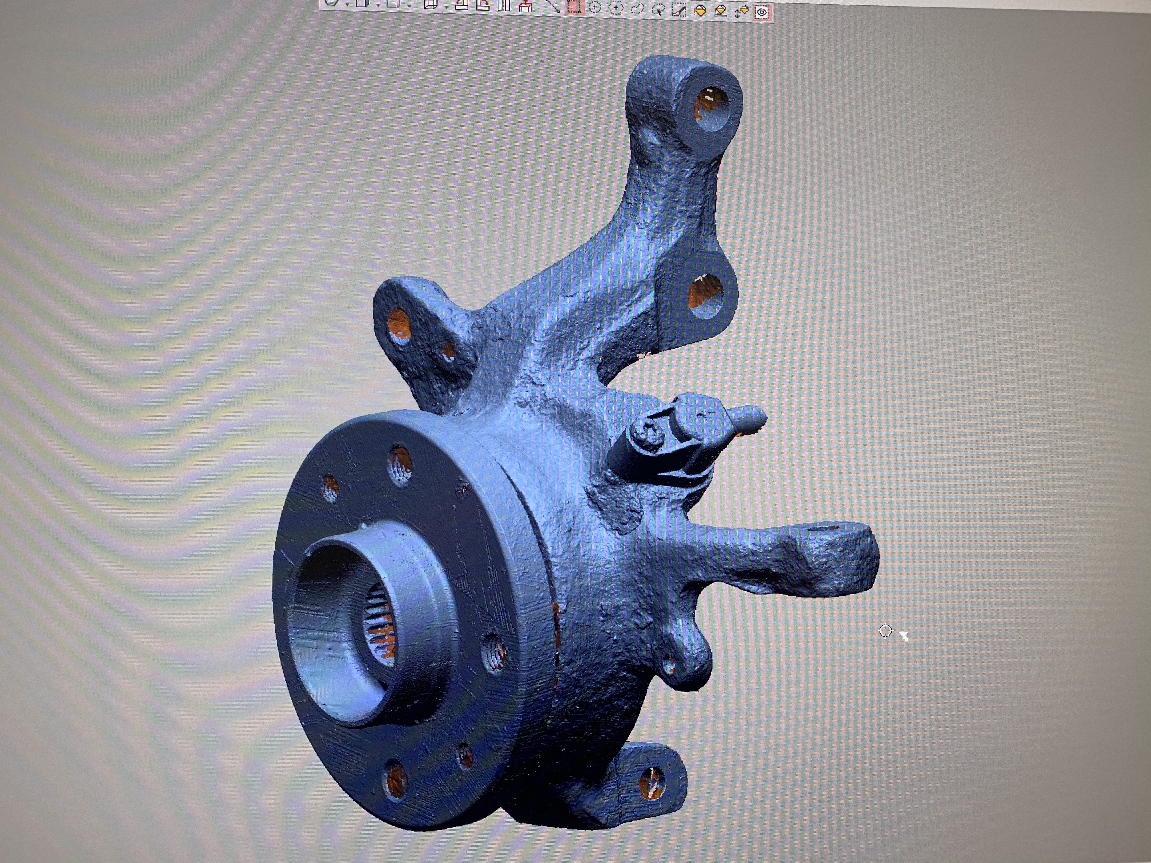

So my new company told me to find something to do this afternoon so I decided to scan up a cup packed hub.
Since my cars currently in pieces I’m aiming to get a full model of the engine done as “learning exercise”.
  2014 Clio 200t edc

That’s just a relatively simple 3D surface model good for checking tolerances vs the manufacturers specs.
Once I’ve got the H&S out the way I’ll be sticking it on the X-ray to see the quality of Renaults casting, if there’s voids etc.

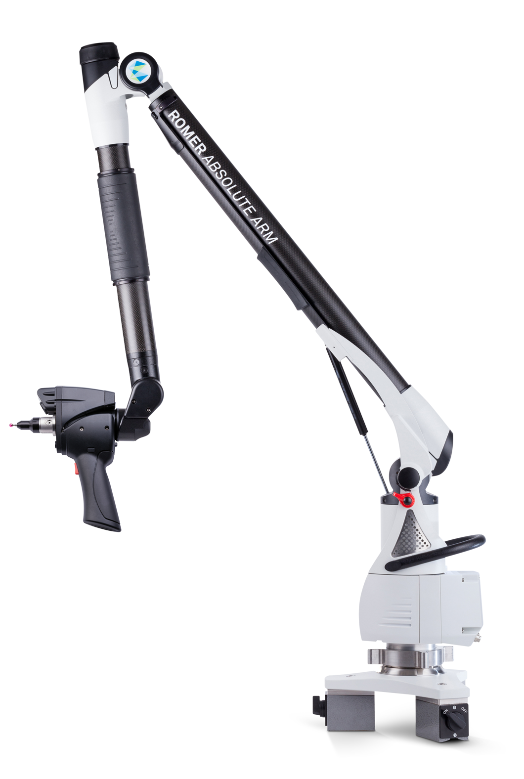

What hardware are you using to scan the parts?
We’ve got pretty much everything but I used a hexagon arm to do this so accuracy is in the microns.
That's proper cool! Is the part on a rotating bed or does this just completely rotate around it?
So much potential for different parts.
If you imagine painting something with spray paint that’s exactly how the arm works, the part stays still and you move around it.
Then you can move the part if you need to get something from the bottom for example and the software will be able to join those scans together to make the whole part.
