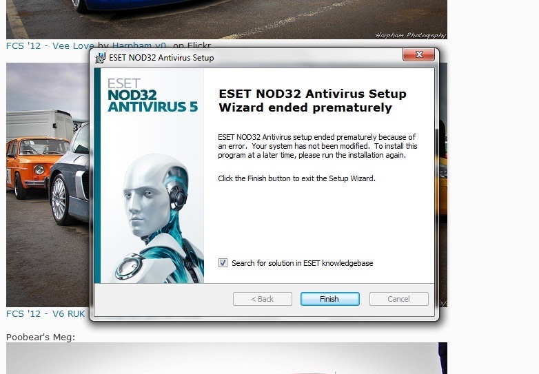

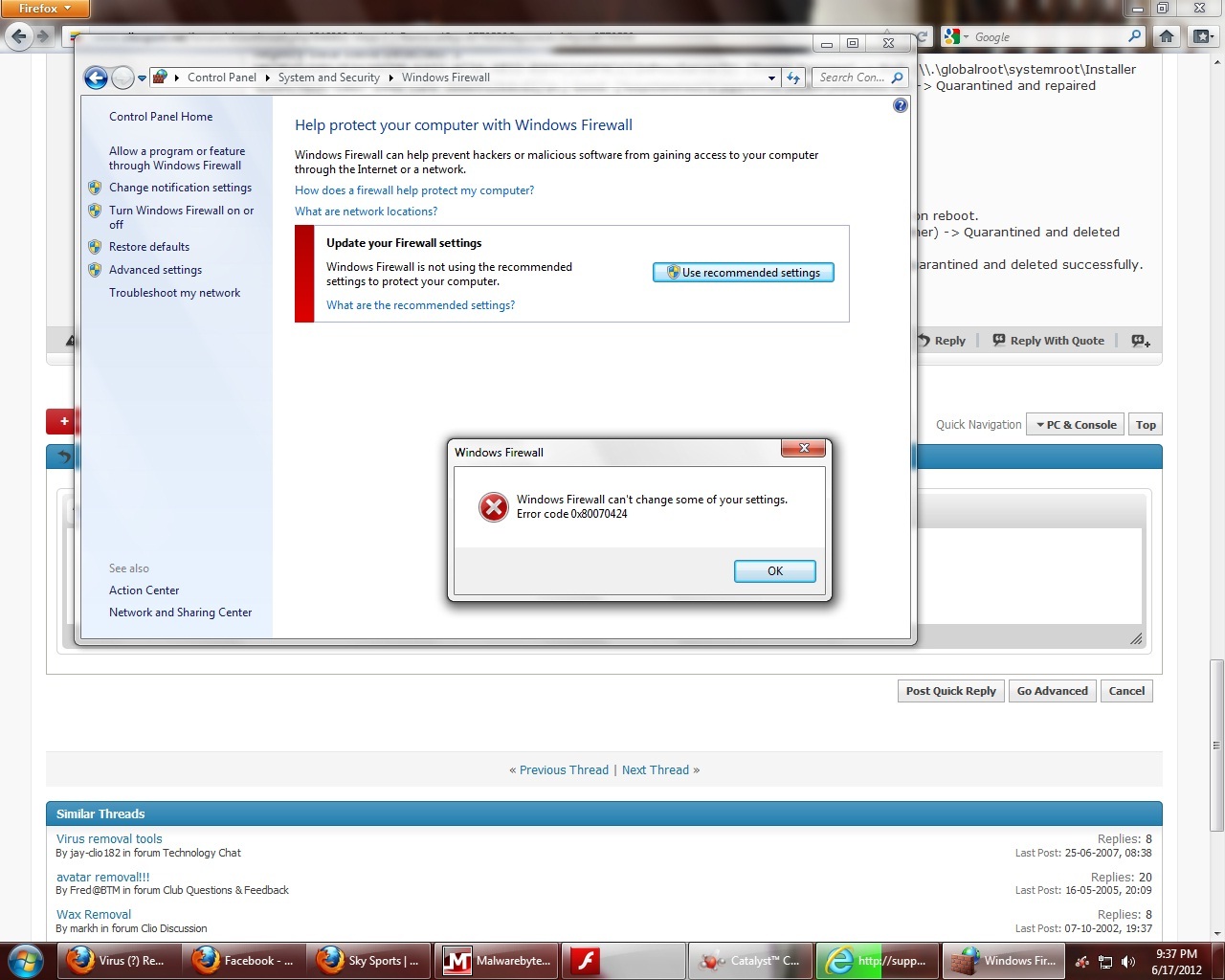

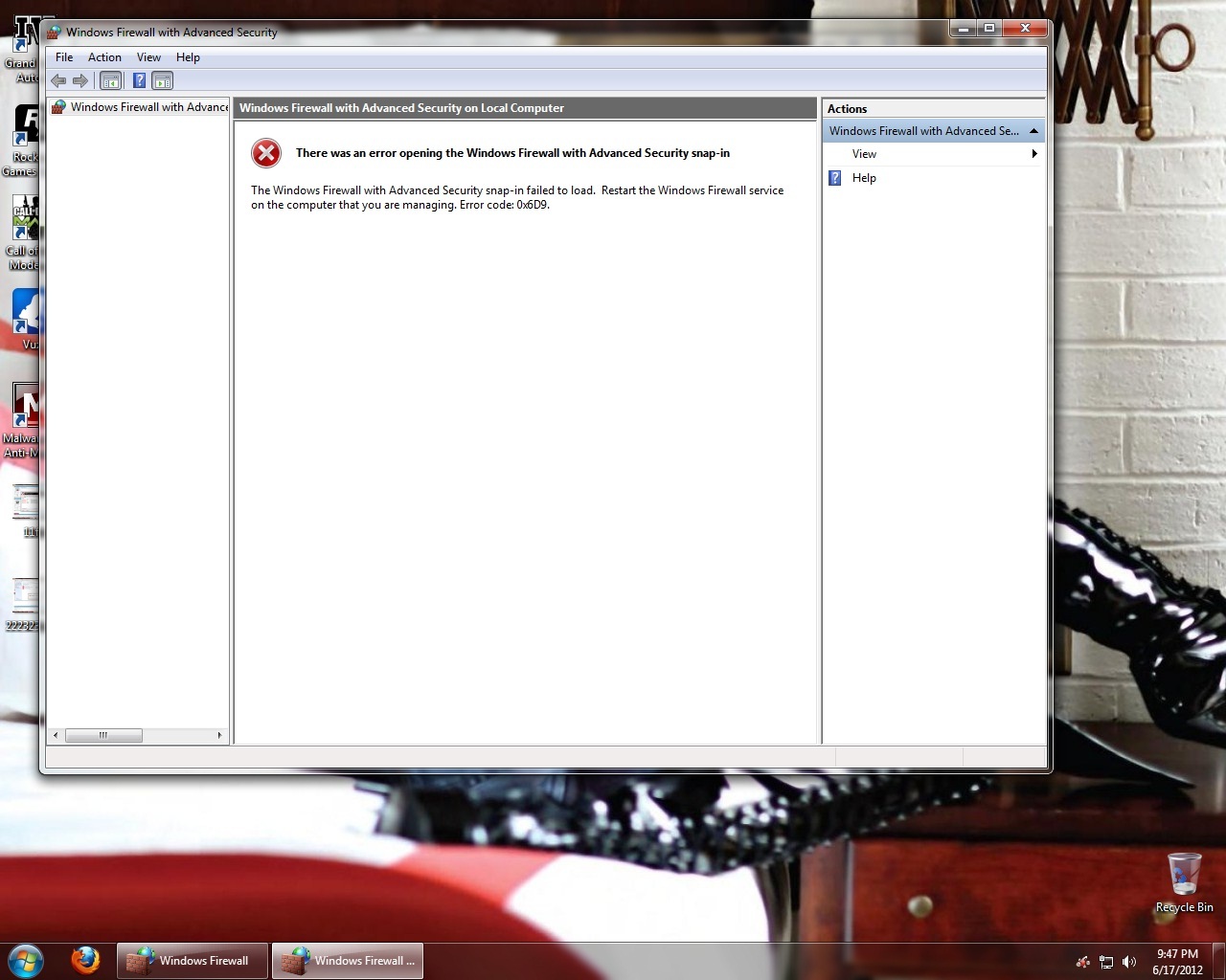

have a virus i think, firewall is not working properly and im unable to change settings on it.
tried to install AVG and i just get an error when i try to install.
when i goto websites like ad aware download it just redirects me to spam pages.
so cant install avg and cant get my firewall on, where do i start? cheers

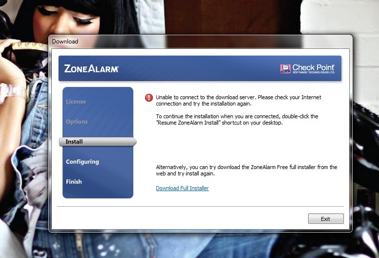

cant install zone alram either
