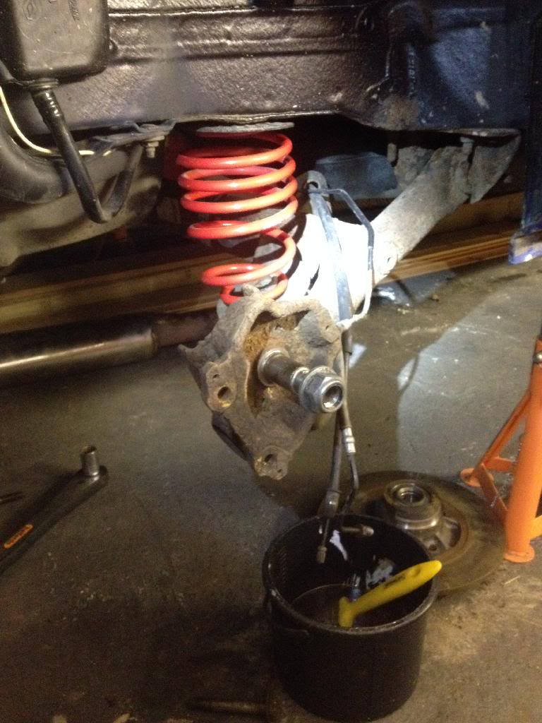

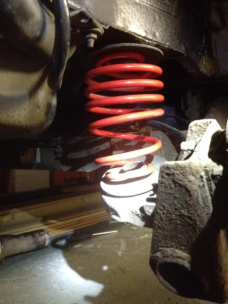

I've put these on tonight and not sure if the spring is the right way round?
That's the rear adjuster for height, but you can roll without it. Yours should look like mine without the adjuster (4 coils towards the top)
You should have the adjuster if you bought them new.
Feates, vmaxx are only camber and height adjustable, but the damping is fixed.
