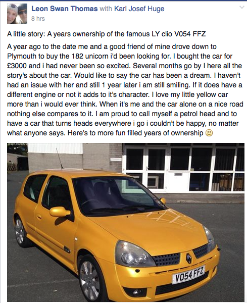

new owner is extremely happy with the car, he said he got it for a good price, the remnants of the 'disability mod' is gone, and he has taken it to a renault specialist who has confirmed it has a PH2 engine in. He quite often posts pics of it up, looks good.
I know but he will always have that niggly feeling in the back of his mind that the car is a known lemon.
And the moment any potential buyers google the plate they will run a mile.
Im pretty sure he doesnt. He seems to be really enjoying the car. I dont see how it is a known lemon unless your referring the fact its yellow? Its not like its been cut and shut lol.

I dont get what youre trying to say? the new owner does have a perfectly good car. And im 90% sure he said he got a good deal on it too.
