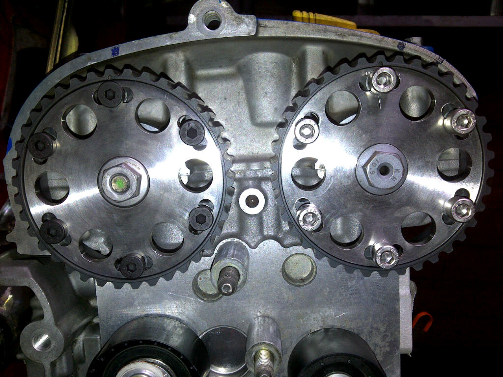

Did you ran custom pulley ?? or are there adjustable ones made for vvt cams ?
You can machine a spare exhaust pulley out to fit fairly trivially I believe, although I havent personally tried it.
I had these made up to remove the dephaser. Machined exhaust pulley would work too.
