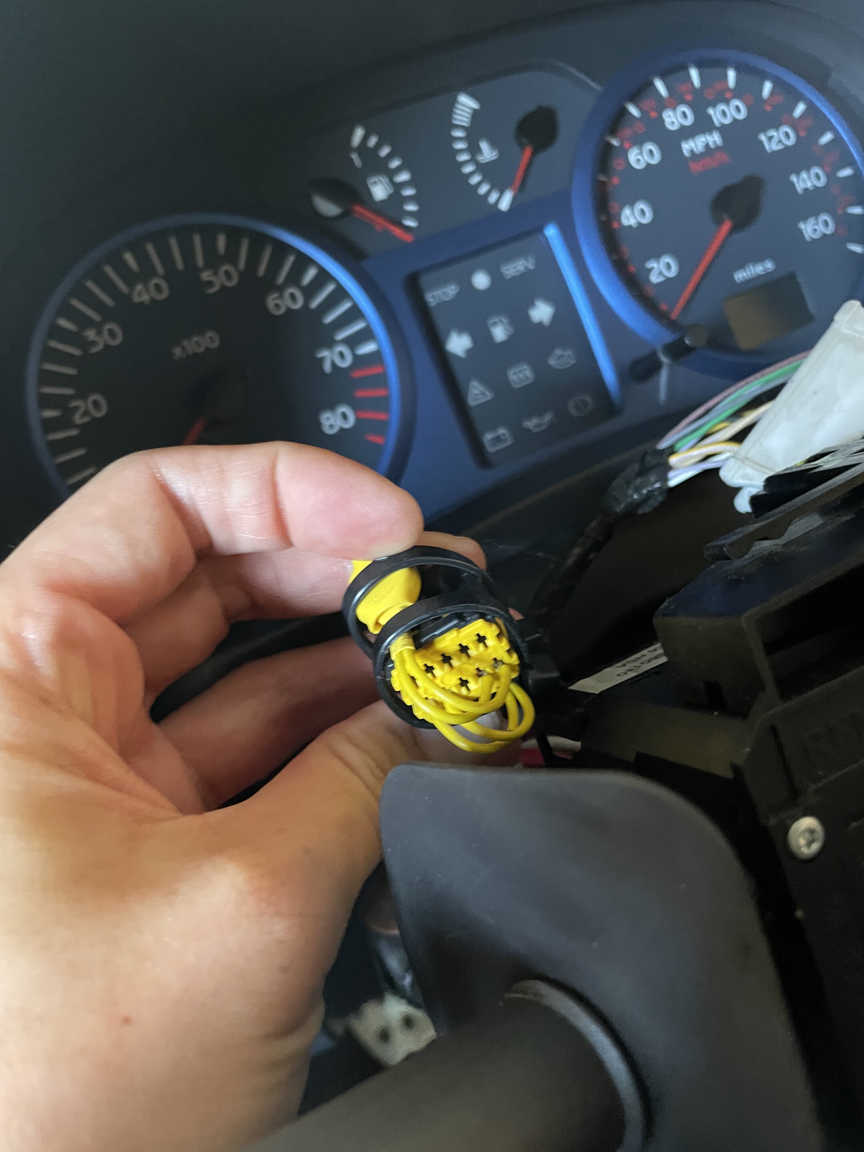

I would just use some resisters off eBay and then you can easily return it to stock
