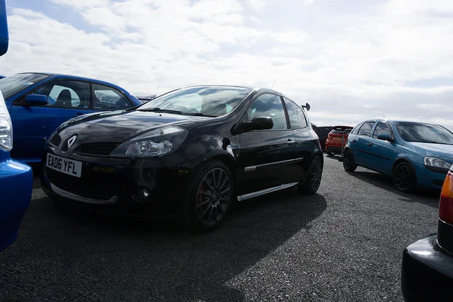

Hey ClioSport.

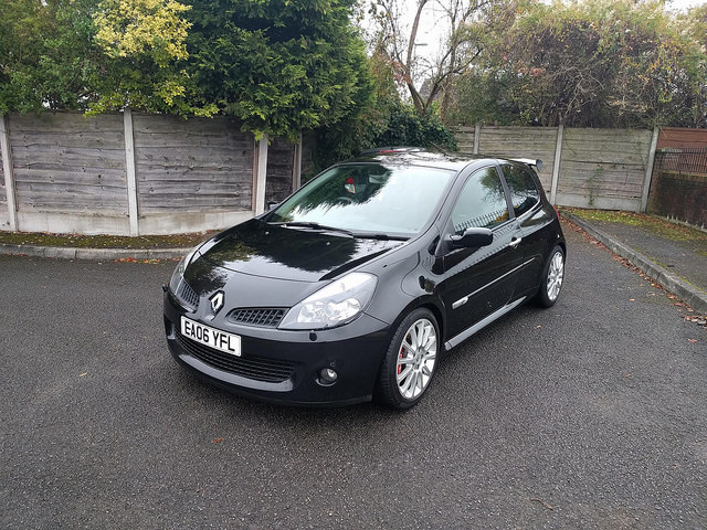

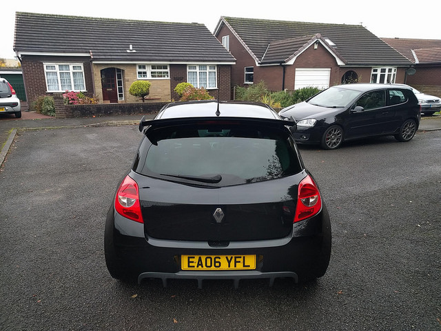

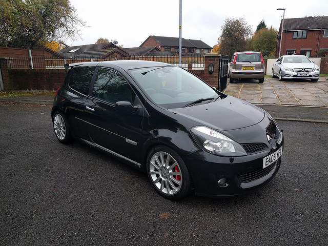

Picked up a black Clio 197 at the weekend, from @welshname (a really nice bloke). I've wanted to startup a thread, but wanted to take my own photos first, the weather isn't allowing it so I shall use the photos he sent me for now.
My plans are as follows
  • New Plates... I don't like the screws and one of the covers is missing.
  • Sort timing belt, it's been due for a couple of months (booked into Engine Dynamics, going to get belt, water pump and dephaser pulley done for peace of mind). I wanted to do it myself but with the weather and lack of time, it makes sense to book it in (and the price is pretty reasonable IMO). Going to pray it lasts until then

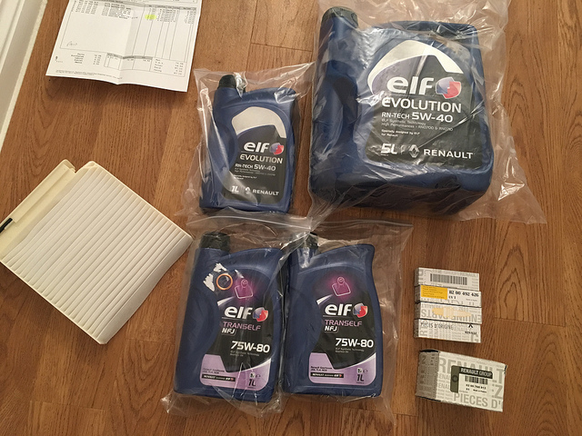

  • Service! Ordered the following from Renault Parts Direct, no air filter as it's got an ITG. Going to try and get this done before it goes to Engine Dynamics on the 21st.
    • Oil
    • Oil Filter
    • Pollen Filter
    • Gearbox Oil
    • Spark Plugs
  • Sort out the lights... it's got Xenons and they seem to be messing around with auto adjusting, and end up pointing at the floor. Occasionally they work OK, so I wonder if the connection to the sensor is a bit crappy... need to look at this as it's really irritating.
  • Proper clean, wax and polish. I've already chucked a bit of trim restorer on the black bits, but would like to give the car a good wax before the really bad weather sets in.

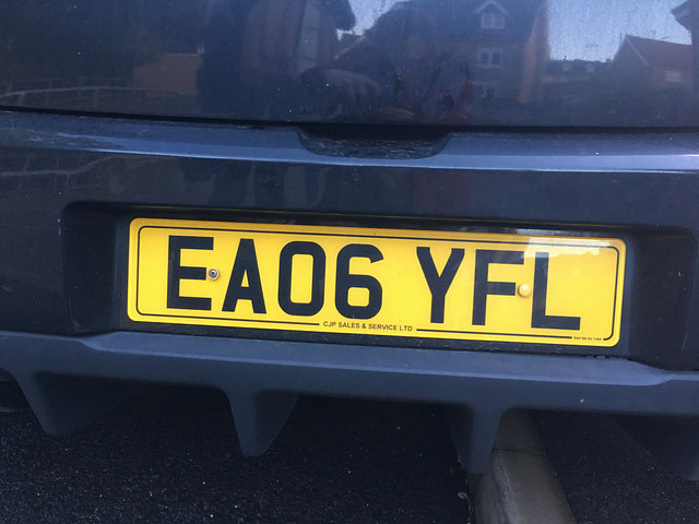

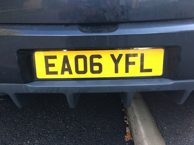

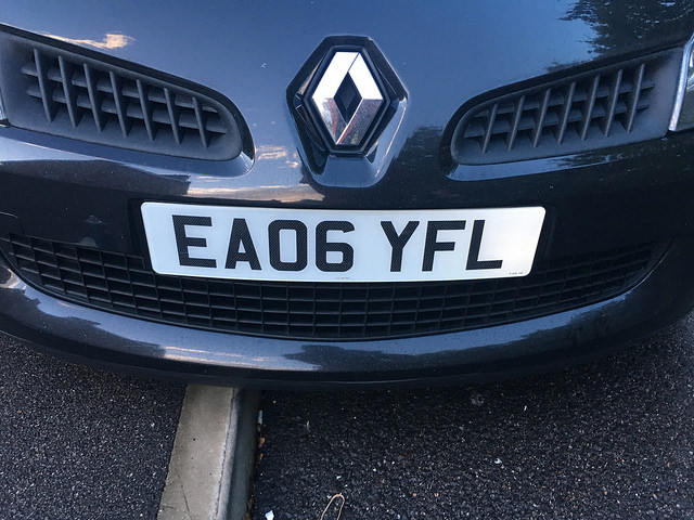

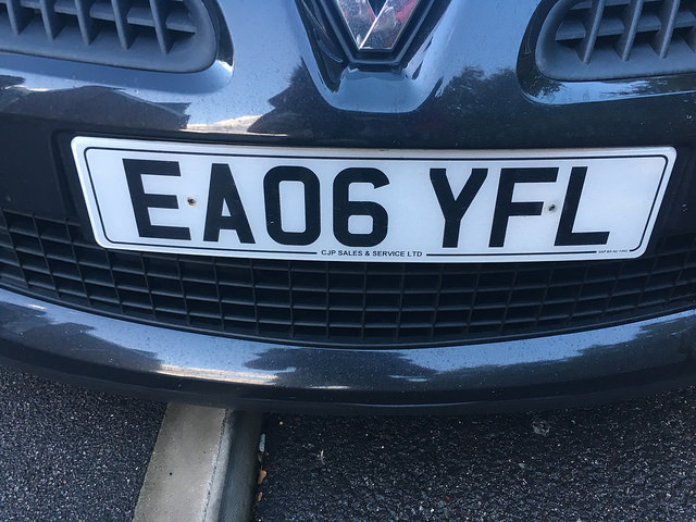

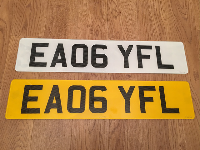

Just found an opportunity to go and put the plates on. Really pleased with the quality - £14.94 delivered from eBay (hardridden), includes all the required markings to be legal (whilst keeping them small and discreet). Beats paying £38+ for the equivalent from Halfords like I did for my previous car, infact I think the quality of these is better.
Front Before
Front After
Rear Before
Rear After

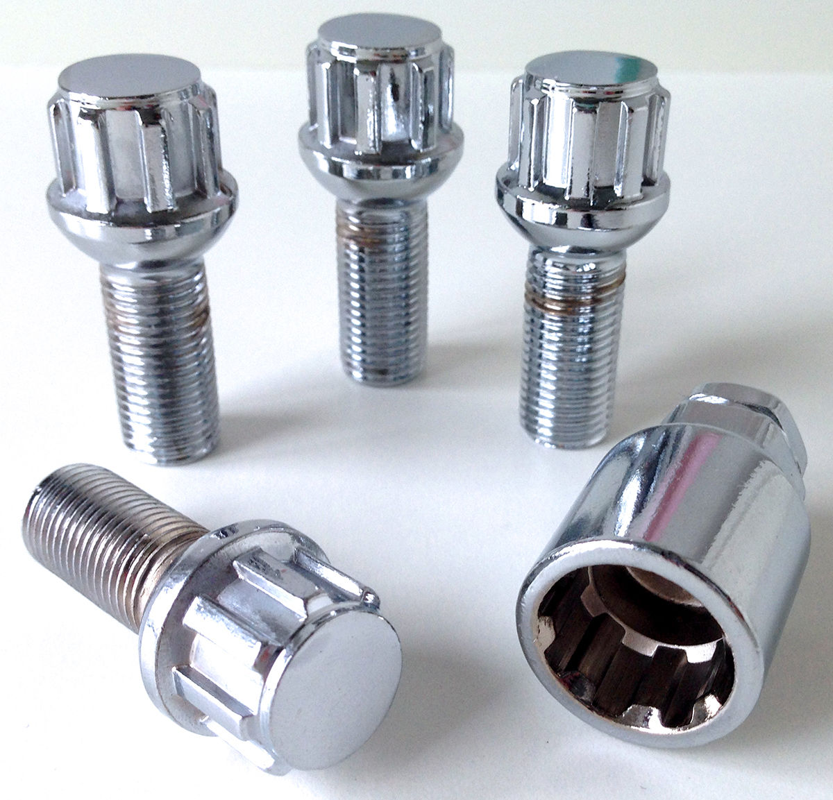

Minor setback - looks like myself nor the previous owner can find the locking wheel bolt key lol! Will need to get these removed prior to the timing belt change on Monday. On the bright side, I've bought a 20 TPI bolts to replace the aged ones.
If anyone local to Colchester has a locking wheel bolt key which looks anything like the following, or knows a good place to get them removed, please comment!
  Suzuki Swift Sport

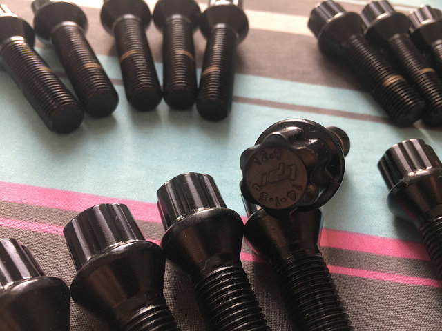

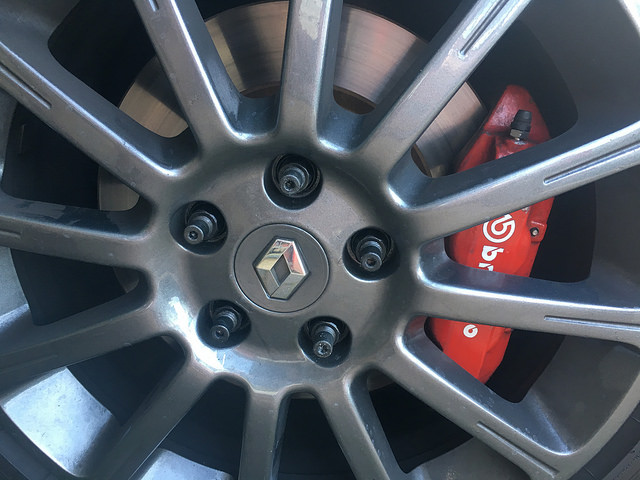

Locking wheel bolt dilemma sorted. Replaced with a set of black TPI standard bolts. Much prefer the look of these compared to the aged, rusty silver things!

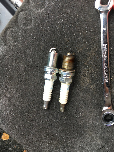

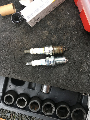

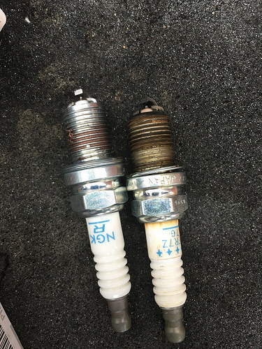

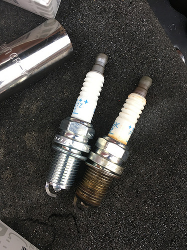

Some more progress today, got the spark plugs all sorted, also changed the rear high level brake light bulb, it's W16W for reference. Old plugs looked OK, but good to have changed them for piece of mind. Timing belt tomorrow. Will need to get around to gearbox oil replacement, brake fluid replacement and a general strip down and cleanup of the brakes over the next few weeks.

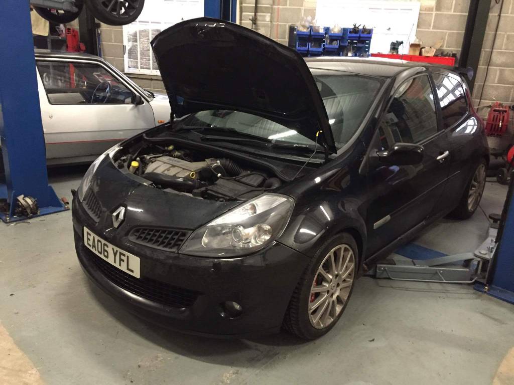

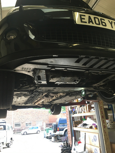

Indeed it was! Timing belt, aux belt, water pump and dephaser changed at Engine Dynamics today. Great service, dropped it off early this morning and picked it up just after lunch.

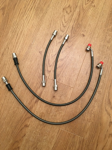

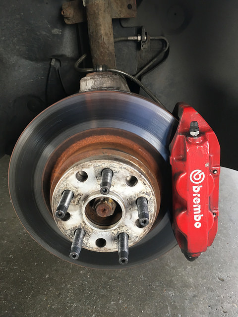

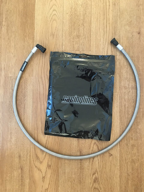

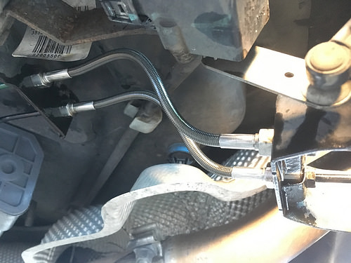

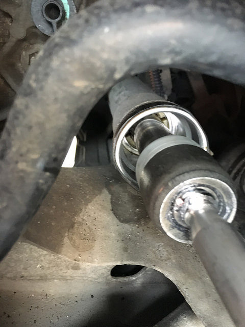

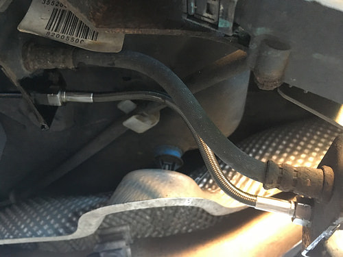

This weekend it was time to change the brake fluid, and the brake lines too as it happens. I picked up a set of the braided lines from Pro Line Motorsport for £40 on Black Friday!!!
Really happy with them, they look awesome and give a nice consistent feel. Changing was brake fluid is also a good idea regardless, it looked a bit past its best.
For those interested 10mm, 11mm, 13mm and 14mm spanners are all that was needed. I didn't encounter anything too daunting, though one of the bleed nipples seems to have a lot of crap in the thread, or is cross threaded so I went easy with that one, and will look into replacing it soon.

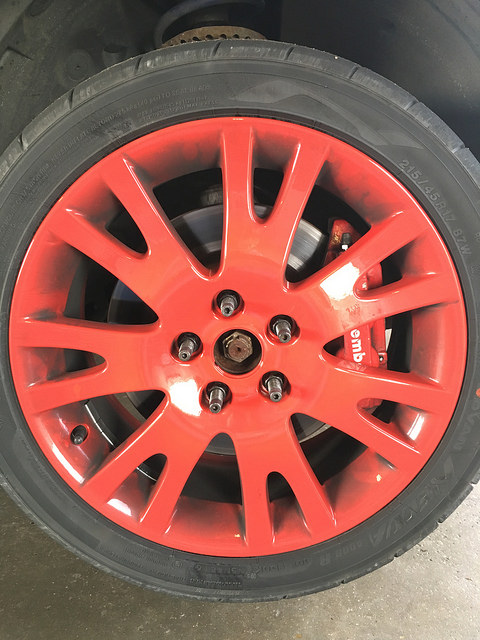

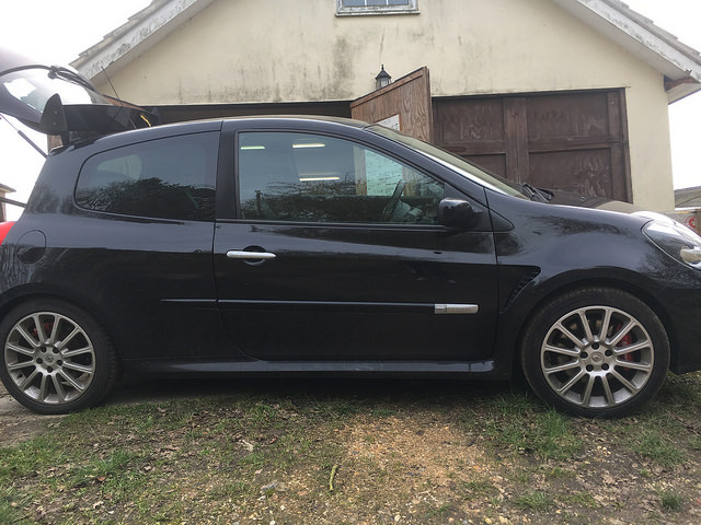

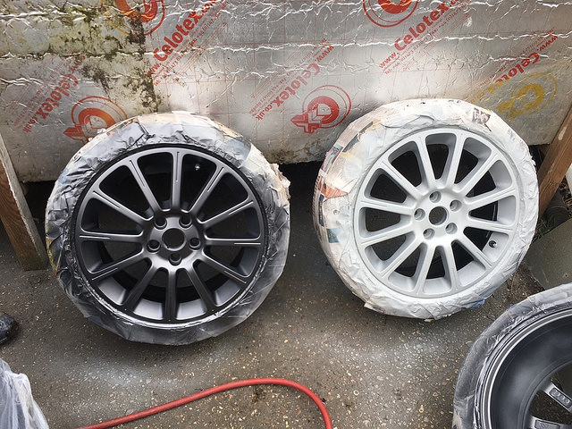

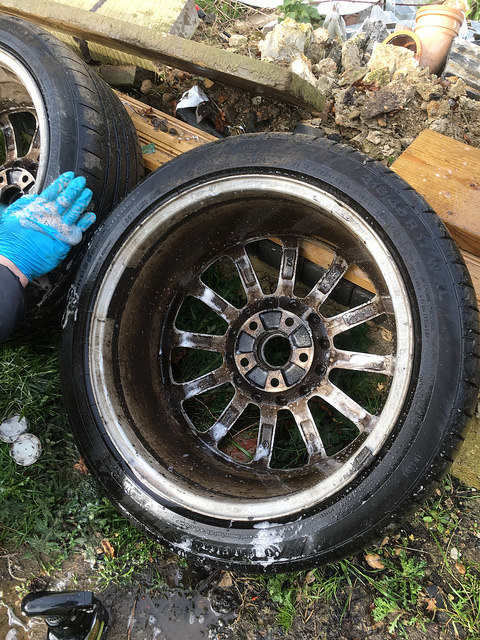

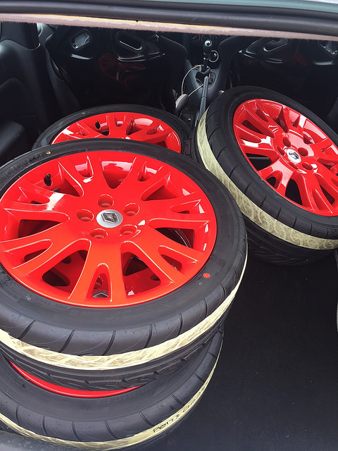

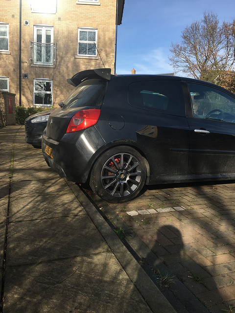

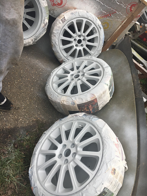

Not that much has happened over the winter, a clean every now and again, and lots of fuel. I did however give the wheels a refurb, there was some pretty bad kerbing present on one of the wheels, with a small amount on the others, this has been there since I bought the car so I decided it was time to tackle it. I've never really painted anything before but I thought I'd give it a go, not displeased with the results, it's far from perfect but a big improvement on what was there.

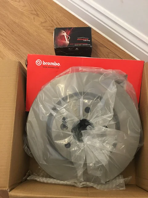

I also ordered quite a bit of stuff this week, planning on tackling quite a few jobs pre MOT this weekend. I'll try my best to take photos as I go. Any tips/tricks/advice welcome.

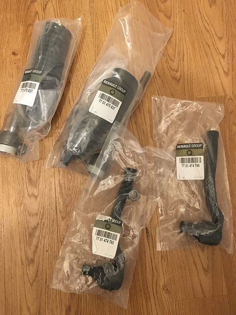

  • Genuine track rods
  • Genuine track rod ends
  • Brembo High Carbon front discs
  • Mintex 1144 front pads
  • Stainless HEL bleed nipples

Images of the wheel refurb below.
Side before refurb
Inside wheel before cleaning
Wheels after prep
Wheels after primer
Primed and painted
Side after refurb
Fast Show - front
Fast Show - side

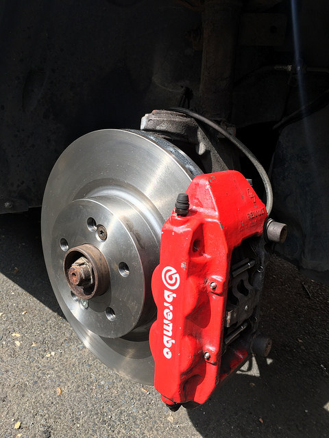

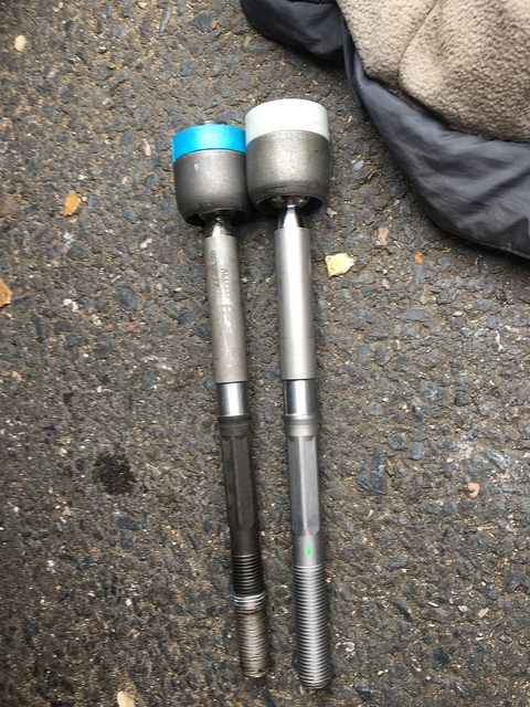

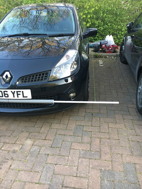

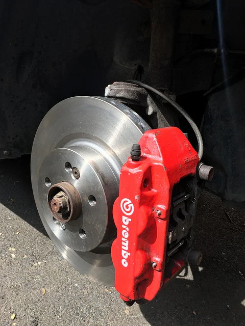

Time for another update. I got the track rods, track rod ends, discs and pads changed in preparation for the MOT tomorrow. I did also replace the clamps on the exhaust. I spent some time tonight sorting out the alignment, running approx 0.8mm toe out on each side for now. Didn't change the bleed nipples/fluid yet - simply haven't had the time. Hoping to get the braided fuel hose I bought fitted on Sunday, possibly the bleed nipples and fluid too depending on time. I also bought some new p clips to sort out the braided line routing, it's very close ATM but not actually rubbing thankfully.
Track rods, track rod ends, discs, and pads
Alignment

Set of Laguna Silverstones and AD08R (thanks Ben Patey) for track.
Stud conversion - no spacers on track (the laguna have a decent ET anyway).

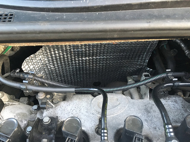

Made a heatshield to replace the POS fiber thing which was torn apart. Will make a proper nice one when the engine is out...

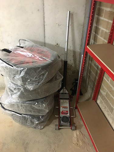

New parking space - warm and underground for the Clio :smiley:
Stuff storage - will need to look for a unit soon, it appears people are not happy with this stuff "being in the way"

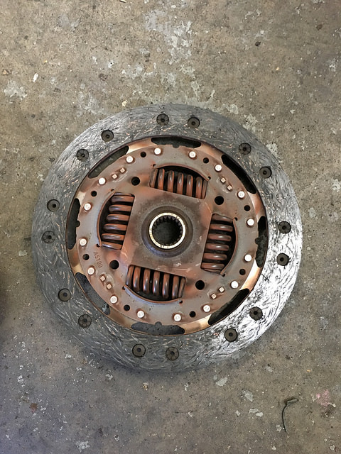

Another trackday booked, Snetterton on the 16th. Replacing the clutch tomorrow morning, got another genuine manifold with decent flexis too which I'm going to put on whilst I'm at it. New fluid and general check over too.
  Suzuki Swift Sport

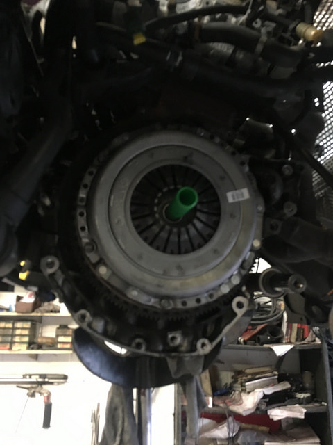

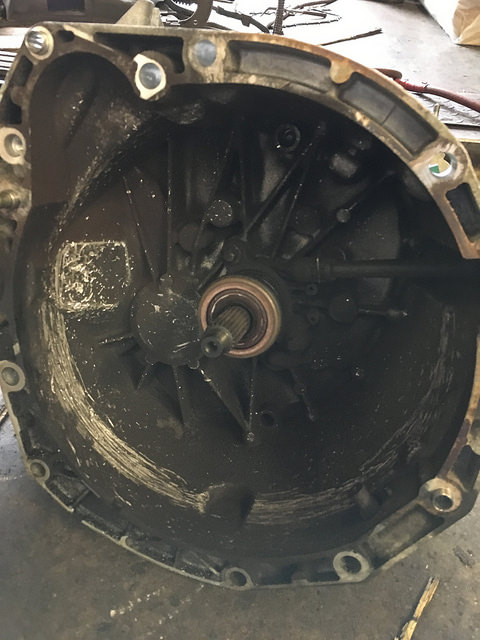

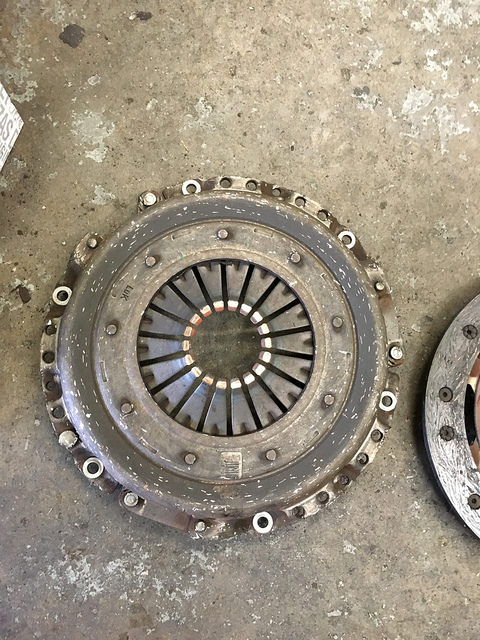

So clutch and manifold all done. A friend who has done a fair few helped (well I helped him). Took around 3-3.5 hours to do both, and that was going fairly steady, and included a break for lunch.
The clutch had some life left, but the cover... it was properly fked, part had broken off, which was evident on the inside of the housing. Luckily - no adverse effects. I suspected something like this had happened a while ago, combined with the judder is why I decided to replace.
The previous owner had to replace the crank sensor as it got damaged, this is quite possibly when it began to happen.
No more pics unfortunately - had other stuff to do afterwards so didn't really stop to take too many pictures.
Regardless, the clutch is quite possibly the best thing I have done to the car, it's so much better. Upgraded the gearbox mount whilst I was there - not really noticed the difference but worth doing anyway IMO, £16 from Euro Car Parts. One other side effect is that there is close to no vibration on idle now, even with inserts in upper, lower and gearbox mounts.

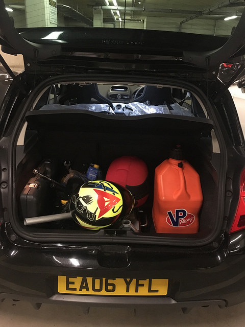

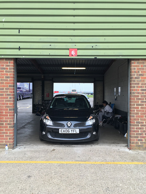

So Snetterton on Monday was brilliant. Really really happy with the car. I think there were 5 sessions which were red flagged whilst I was out, which was unfortunate, but no major delays really.
Got some instruction (free with Opentrack) - got myself 20-30 mins with adamchristo.com - really nice guy. Races, and actually uses a couple of 200's to teach in - which meant he knew the car well. He showed me how much later I could brake and generally pushed me a bit which was great fun. I previously got instruction at Bedford and was left underwhelmed - so this was great! He then took me for a few laps in my own car which was awesome!
Bedford some friends next on the 4th - also a lot of people from the forum going which will be cool! After that it's time to do some tidying up/maintenance. Rough idea of what I want to look/tidy/replace over winter includes:
