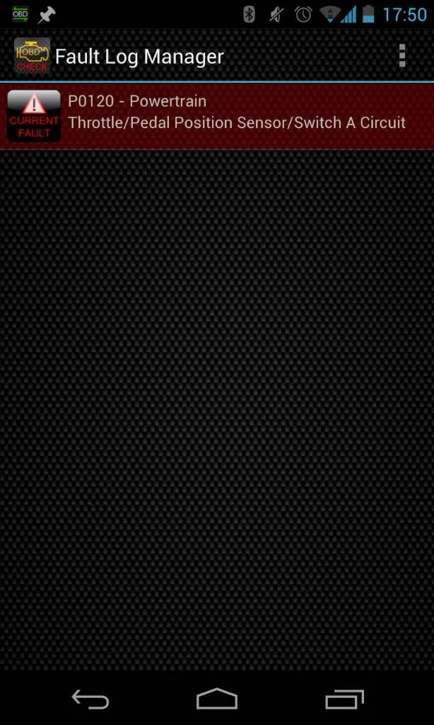

I have used Torque for android and it has produced the following code:

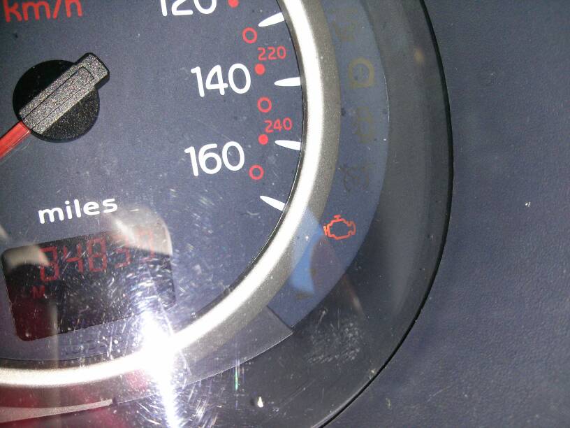

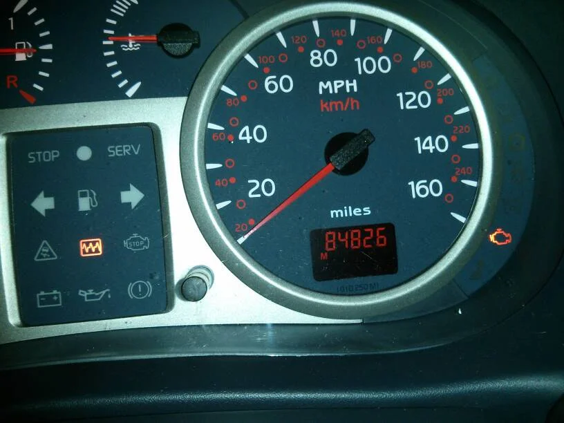

This is the lights on my dash:

I could be wrong here but although it logs as a fault im pretty sure the pedal/throttle sensor isn't actually a fault. someone correct me if in wrong but sure when I used my rs tuner a while back it had that same fault but with brackets next to it saying not a fault or something.
This does ring a bell tbh. 100% certain my 182 displayed a similar fault with (Not a fault) next to it.
Maybe someone with RSTuner can verify if its this exact 'fault?'
