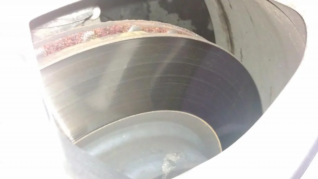

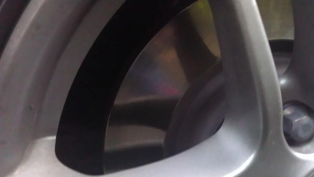

Here is a few pics of the discs just for info...The darker image is the drivers side and on it I can see a darker ring the full way round the outside of the disc about 1cm thick, you can maybe see it in the pic?
The lighter image taken with a flash is the passenger side, do you reckon that is deposits all round the disc? Just curious what you lot think of these images, car is going back in anyway so I will be asking them to be inspected.

Hmmm, not sure actually, must check that out, what do you think about those images? Normal?

I agree and correctly functioning Brembos are amazingly sharpe to and the pedal being spongy is text book seized pad(s)
The pics don't look too bad

My bet is the inside pad is seized! Mine were exactly the same when I bought it. I had a fair bit of travel and poor braking until I stripped and cleaned them, then they were awesome!!
