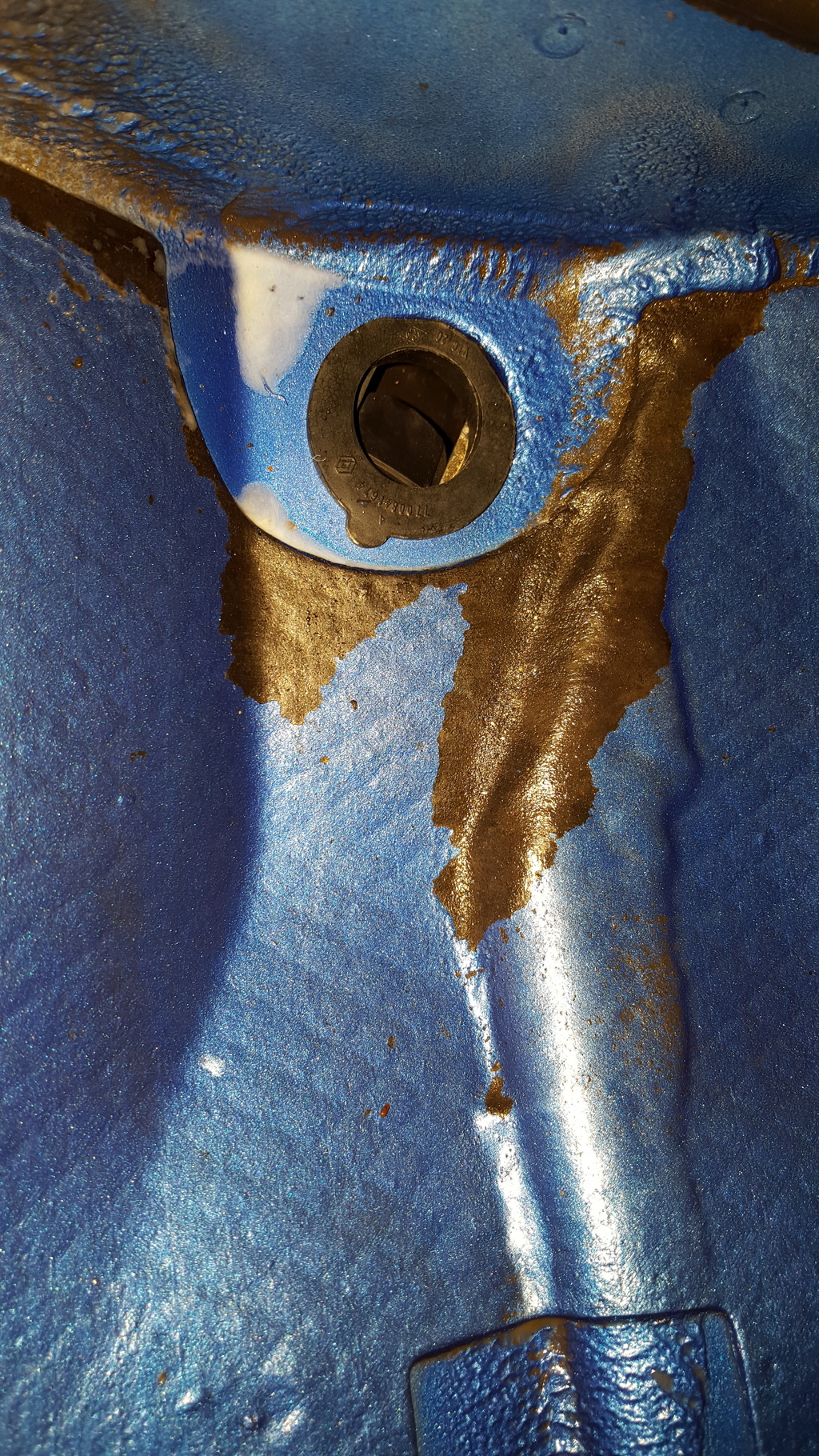

This is the drivers side. There is one passengers side under the windscreen washer bottle and one in centre.
The centre one is probably the issue. As a tempery fix, if you can locate the rubber drain pipe thats half way down behind the engine and get some wire and try and dislodge the chap and allow to drain. Then have a proper clean when the weather improves. You can also get to both the drains either side via the wheel arch.

Thanks for replying,I did manage to locate the 2 grommets/drain plugs behind both front wheel arch liners.both seemed in tact and no water drained when I removed them.I cant see the middle one (the one behind the engine)at all.Is there's anyone in the Herts beds or bucks area that could solve this for beer tokens as the weather is looking bleak and its going to fill footwells up again
