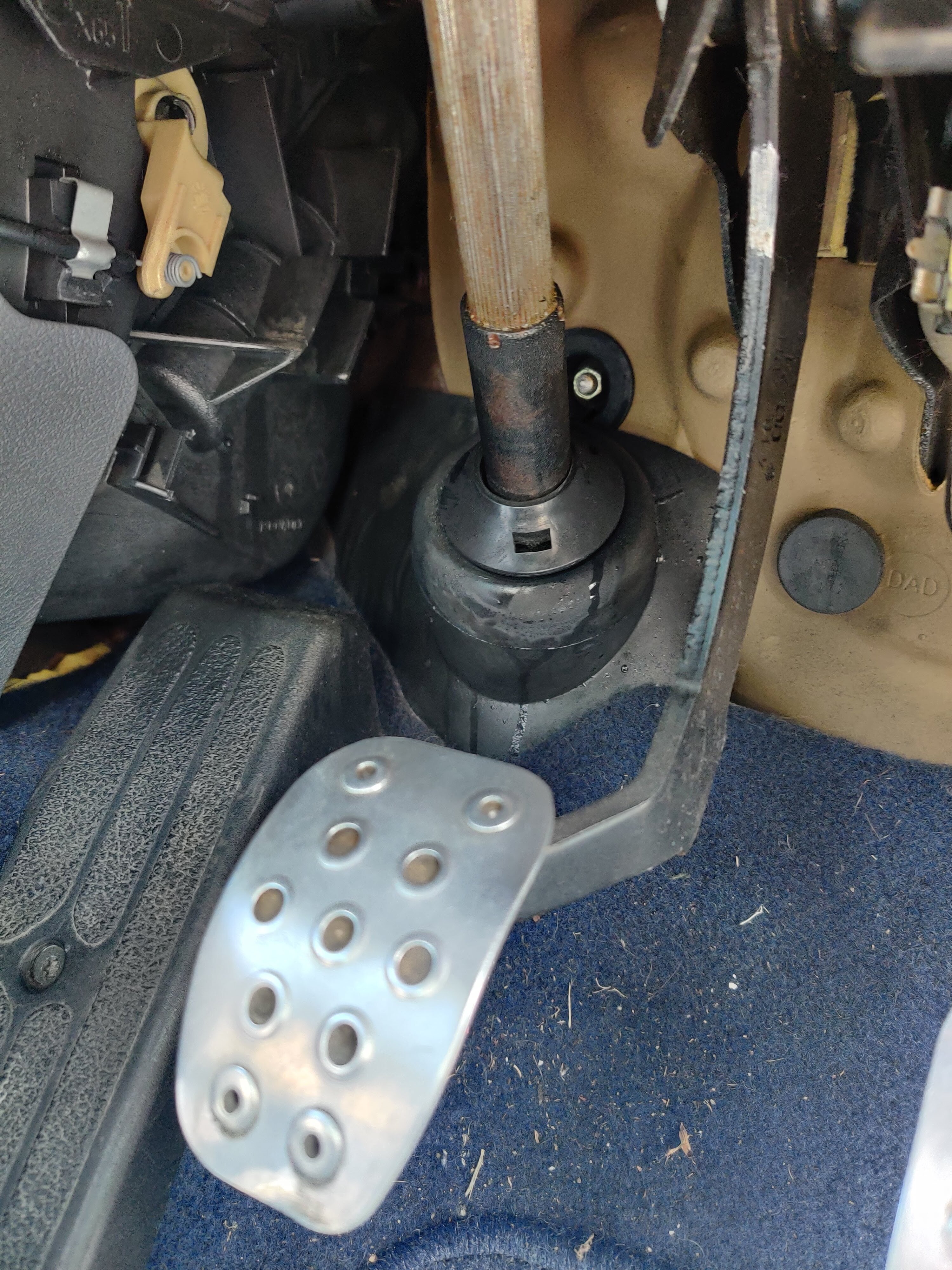

There was water leaking from a shaft thing behind the pedals? But it seems the amount of water leaking from it is quite low compared to the drenched foot well. Any help is appreciated, thank you!
That’s the steering rack mate.

How do I check to see if its the heater blower leaking? Is that the plastic tube thats under the driver seat?
