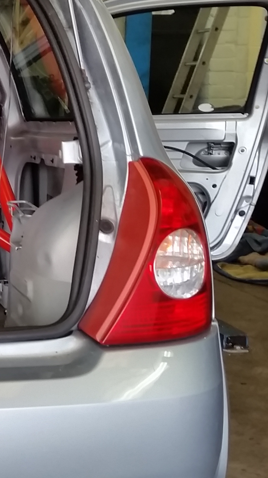

Just can't find where it's getting in. With the boot matt in place the water is pooling on the left rear of the matt. Can't see anything obvious neither can the garage. Could it be the left rear window seals maybe or maybe the arial?

Could be but the more common place is the plastic/rubber boot stops, there's one each side roughly level with the rear lights
The little bung as can be seen in the photo by the light, try re sealing these first

Yup as the others have mentioned, it is the boot stops. You can either buy new ones and replace them, or buy some clear silicone and apply around the boot stop and that will cure it too.
