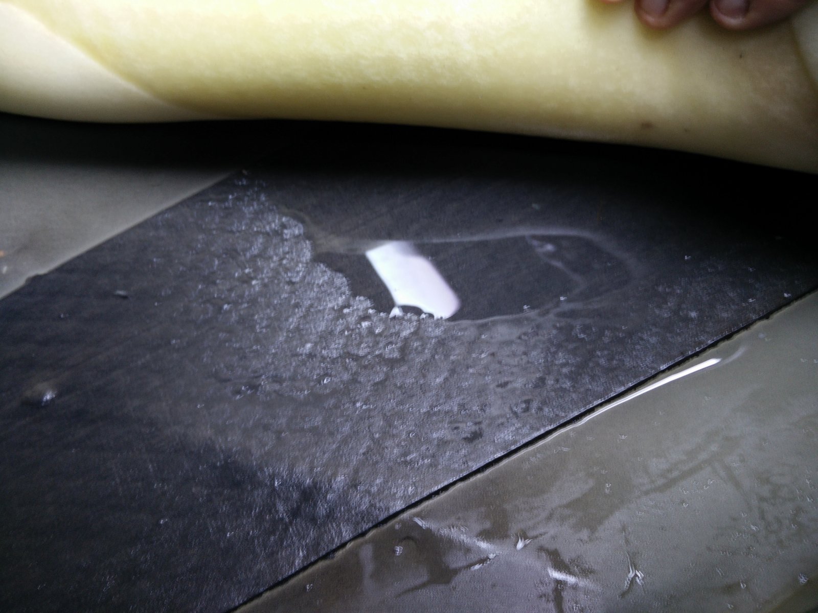

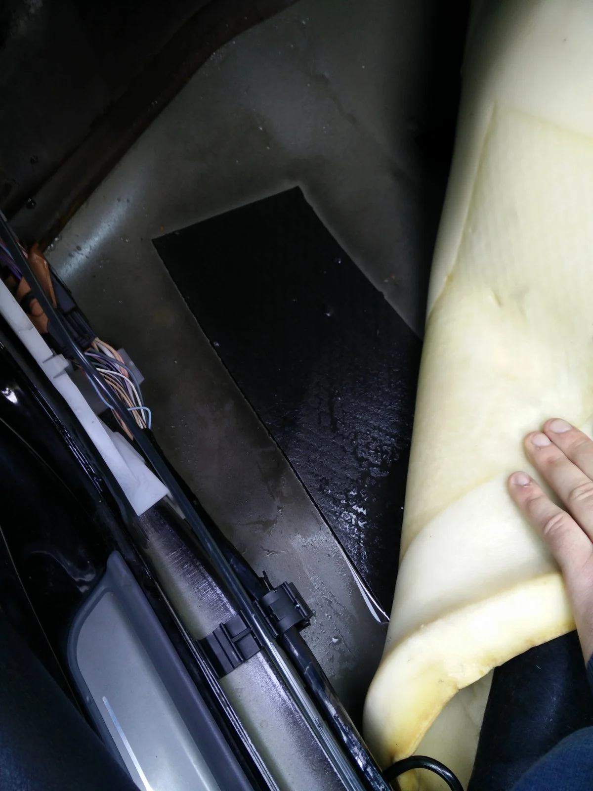

Hi all, so have been putting this off for the last week or so, but it's getting worse and today is dry.
So water is getting under my passanger seat, so have done the normal by checking the little plastic gromits near the rear lights, and clearing out the scuttle panel and all the crud that was in the arch liners. To no avail.
Also it's not the heater matrix.
And its only on the passanger side.
I've checked the rear washer line, and it's bone dry so water can't be running down that.
All the water is sitting under the passanger seat and foot well. The sound deadening sponge is sodden.
No one's had continance issues either....
I'm stuck for ideas.
Could anyone shine light on this?
But of an update as I'm tinkering, although the scuttle is clear, the brown sponge thing that's behind the glove box has been hiding things, moved this out the way, and when water is poured on the screen, it comes right back into the car... Trickling from high behind the brown sponge thing?
So found out the issue. Under the washer bottle is where the rear washer line enters the firewall. The rubber grommet appeared to be perished, so I've just cut the line out and filled the hole with black sealant, I don't use the rear washer anyway.
I think that's the issue, tomorrow I'll spray more water at it and see what happens...
