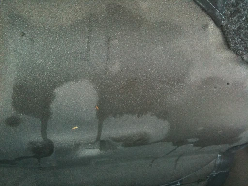

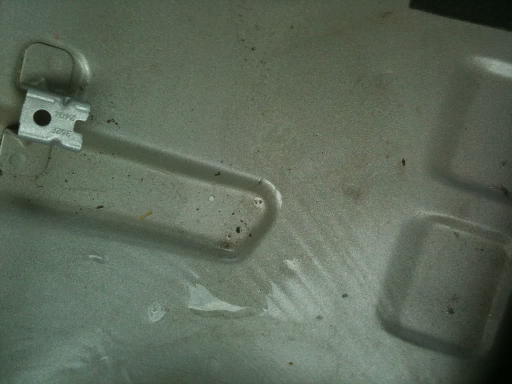

Past couple of times i have lifted myvrear bench up to fold the rear seats down I've found small amounts if water in the seat well and on the under side of the seats. From past readings I'm thinking Door seal? Thing is I can't find water anywhere else so why only under here?
It'll be coming from one of the rear lights.
Stick your hand under the carpet right in the corner of the boot and I bet you'll feel a nice little puddle. It'll only be there after it's rained though as it tends to dry fairly quickly.
To cure it just take the unit out and re-fit. Usually it's just the seal that isn't 100% secure.
