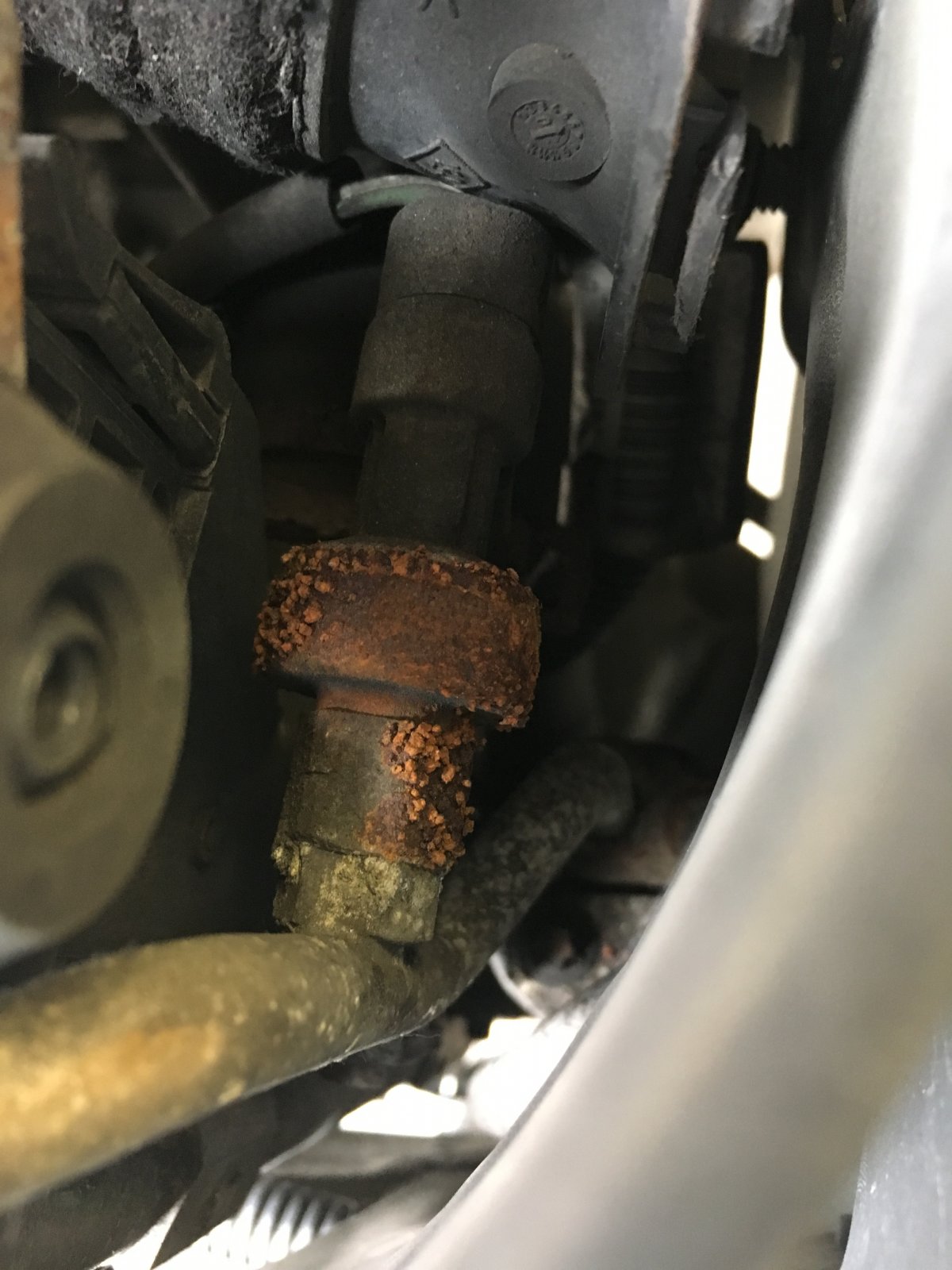

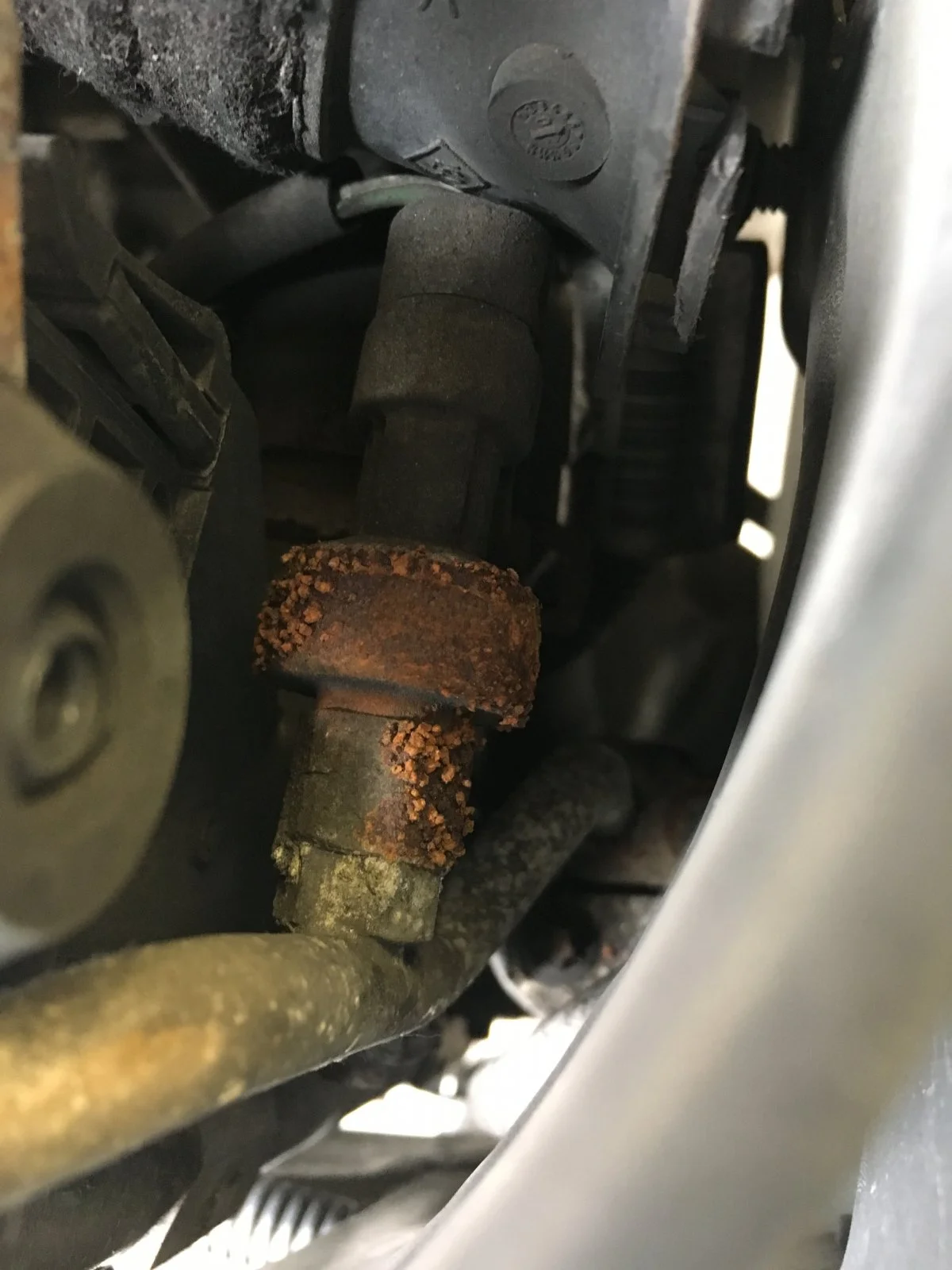

had a nice early finish today so thought id do some investigating on the air con system, pulled the front bumper off and checked over all the connections and managed to spot this, some kinda of powdery rust around what looks like a sensor? could this possibly be what is causing me to leak the gas? if so does that whole length of piping have to be replaced (runs across the top of the condenser) or is there just a seal between the pipe and sensor, looks as if its all one part to me?
