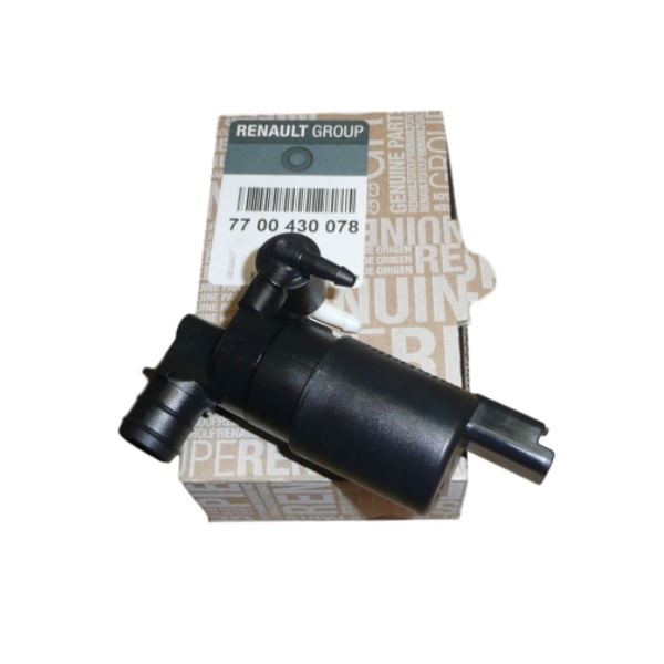

Best sticking with Renault for the pump or are any aftermarket options worth a look?
It ain't cheap for what it is.
Not fitted yet mind, but I bought one of these. The price Renault want is ridiculous and it looks to be an identical design.

Have you fitted this yet?
I've been delaying replacing mine but looks like I've sprung a mega leak as topping up the screenwash resulted in it pishing out from the left hand wheel arch liner. Made noticeably worse when using the washers which at least looks to confirm it was indeed playing up.
Not sure whether to go for that Febi Bilstein one or the extorionate Renault one.
