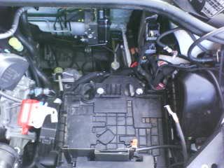

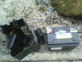

Weight saving!
  172 5HED
Too dark to get pics of what went in its place [:(]

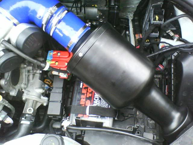

Hi Franx, I presume its ok, as once started the alternator will keep the charge up wont it?! Only thing it runs is the little alarm LED when "off" so Im presuming its ok??
All done, positve terminal needs a plate fabricating when I have time!!

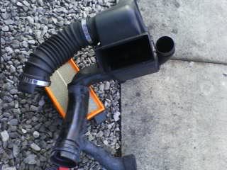

Old airbox out to take battery tray out...

Very nice mate, im tempted with the smaller batter as i want to reocate my BMC cad from being rammed up against the ECU !!

I was worried after the comment on the other page about it not holding charge so asked a mate of mine that runs a race team. Response was....
"Redtop will hold a charge for longer than a L/A battery. They have a 5 year stand by life as they are military batteries really then have been commericalised."

Can be seen here on its side as it is now, usefull little thing!

No mate its the LRAB65 not the AB65, I was looking at the carbon AB65 but this works just as well and with a proper feed runs just as cold!!
Redtop was about £110 delivered IIRC mate!
