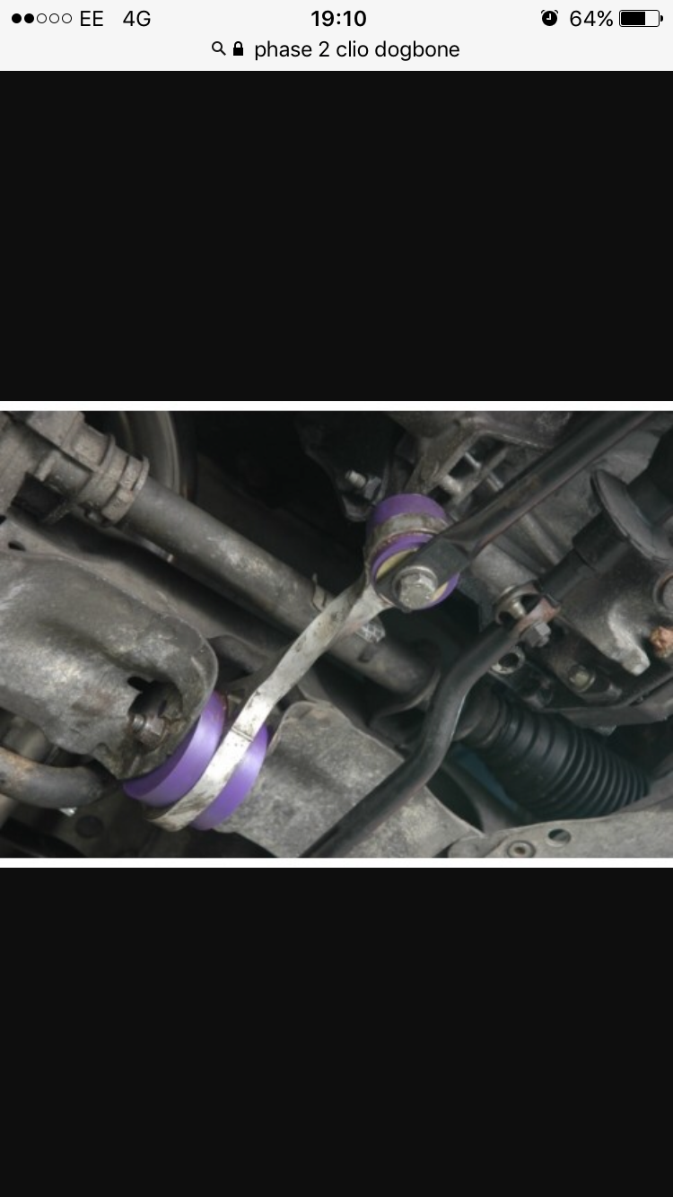

It's like there's no dog bone lol. How has the dogbone been fitted? Assume the smaller piece bolted upright?
It's fitted right, I even bought a crappy replacement dogbone to rule it out .

is the bolt that connect the tripod to the batt mount still in one piece?
mine started banging too turned out to be that bolt had been slitghly loose making the hole in the tripod oval and breaking the bolt.
due to the Vibratechnics there was no sag on that side so very hard to diagnose....
