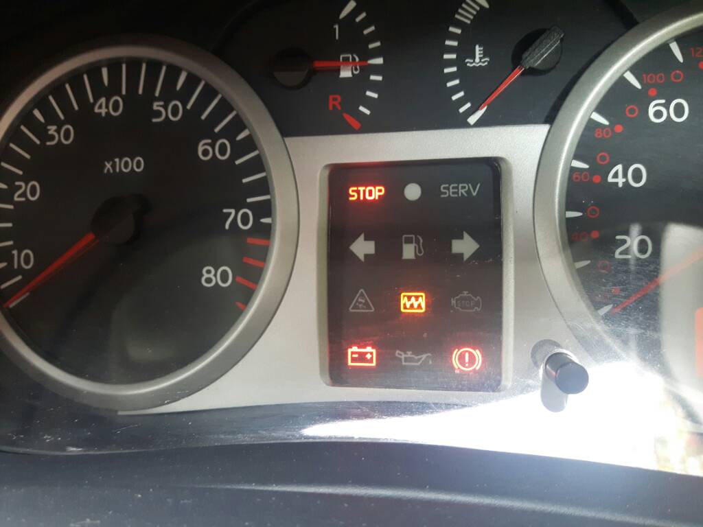

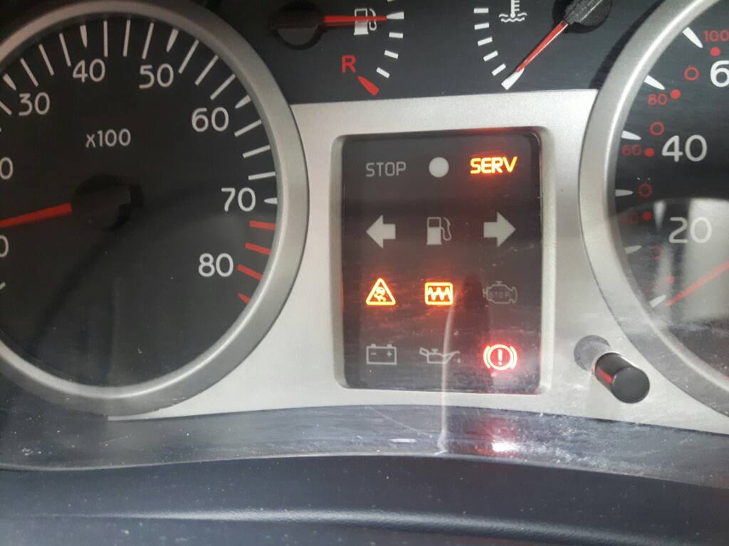

I think I put this in the wrong section before but basically my 182 has just gone into limp mode with some odd symptoms.
With the ignition on it looks like the first photo them once started the second photo. It won't rev above 3k is a little hesitant to start and the rad fan comes on permanently. I've got an abs ring that needs replacing if that could be connected to it but the shaft is stuck in the hub!

that's electrical fault light. first guess with you mentioning the cooling fan coming on is problem in the loom.

One thing I haven't mentioned is that the cruise control is showing SET.....

When the cc is switched off? I can't make it do anything from the steering wheel controls

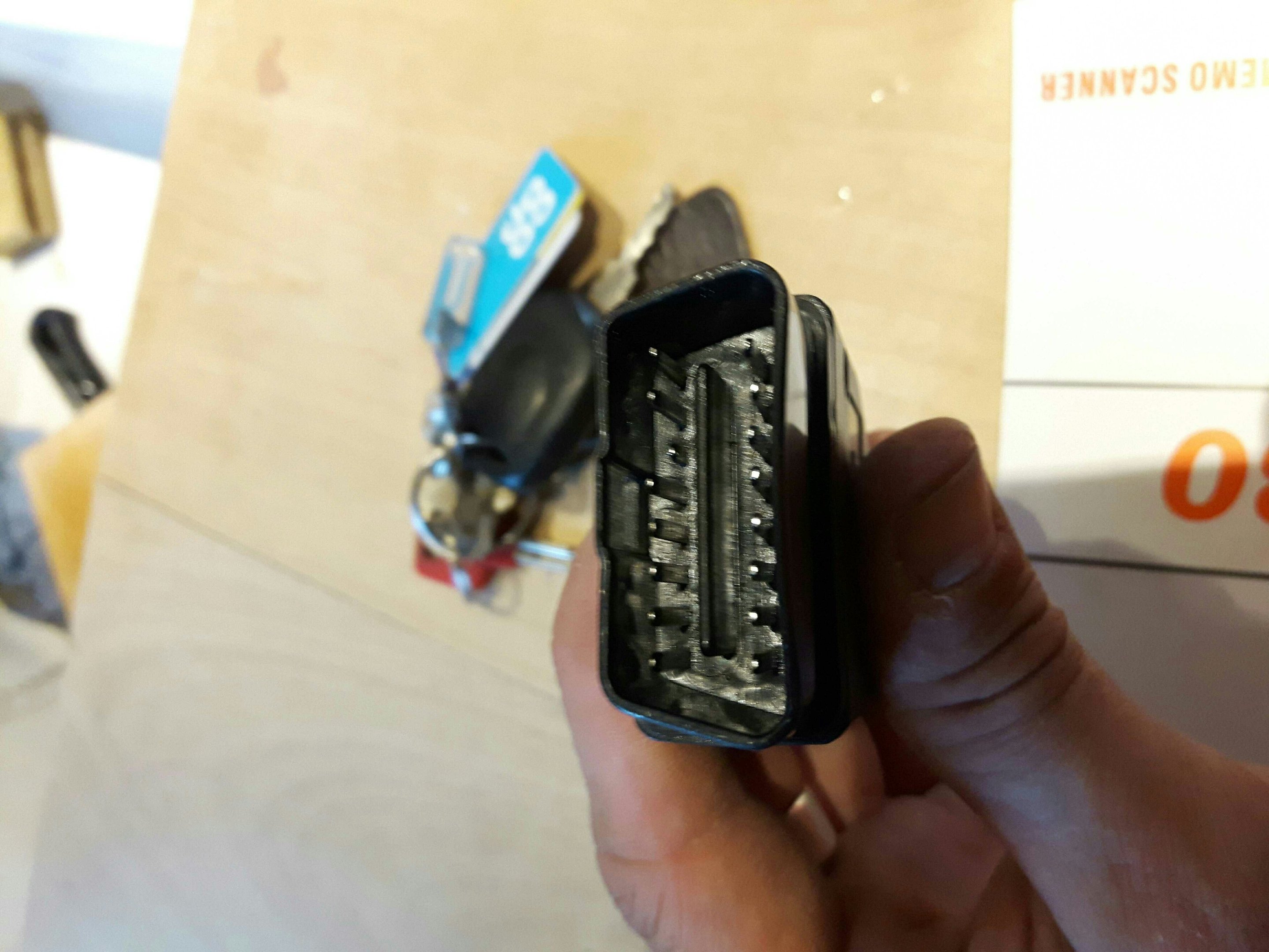

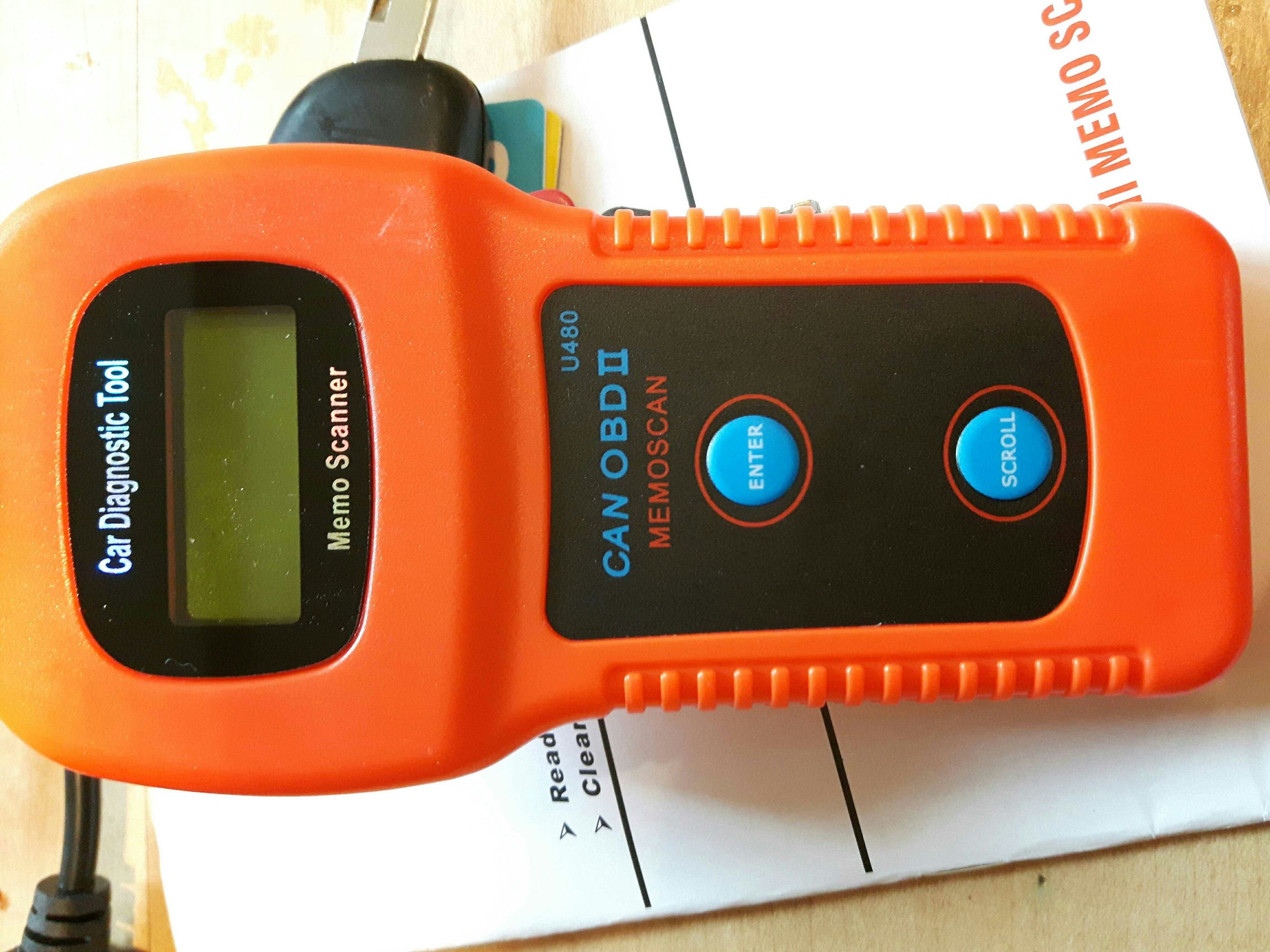

So I tried using this code reader, it said I have 1 recorded fault but just said N/A when I tried to retrieve the code. Reading the instructions I'm dubious that it is the right reader even though the eBay description said it was.

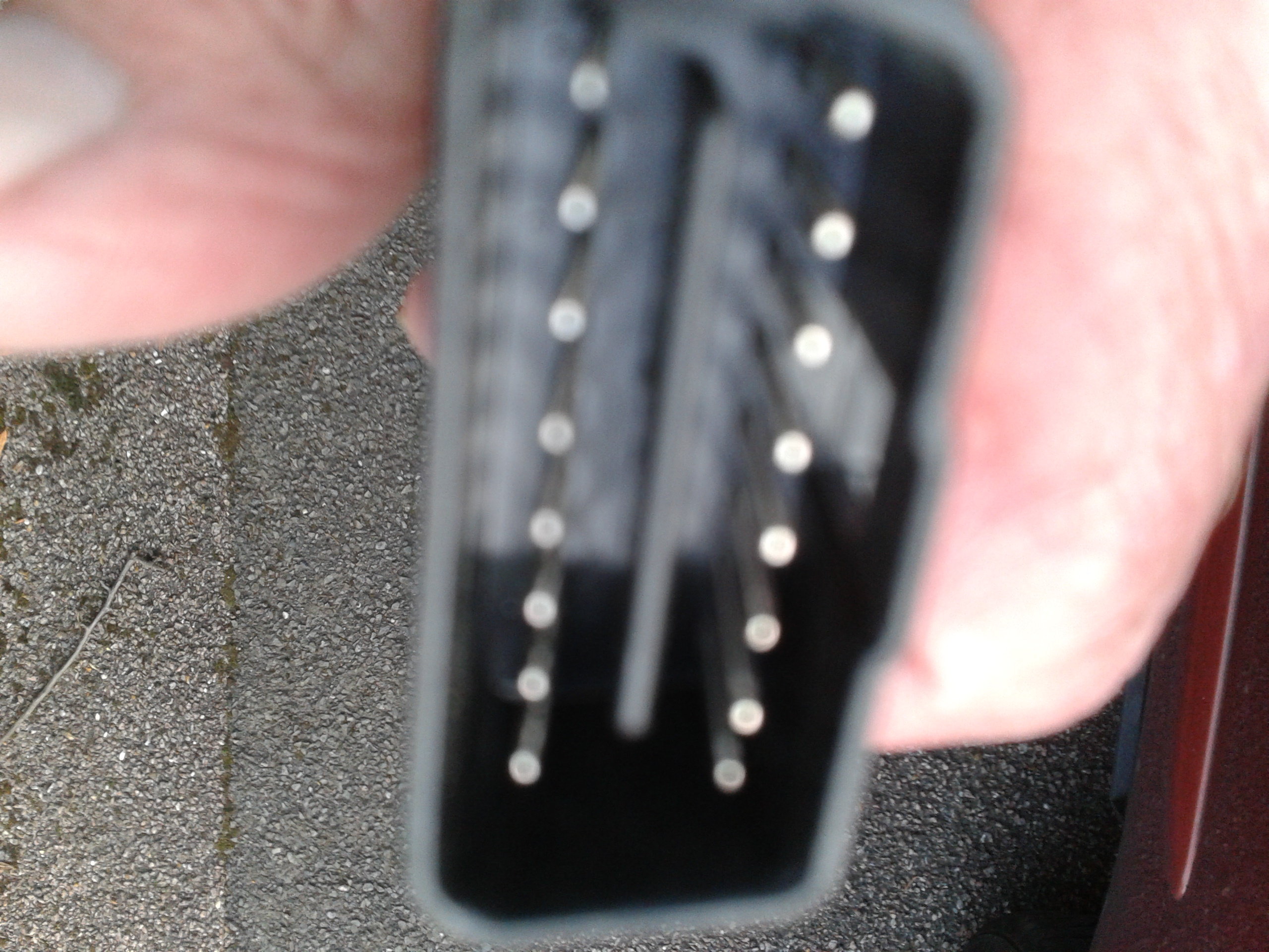

I`ve got one of those & have never had a N/A reading come up, but then I have not had an ABS fault.
Disconnect the throttle pedal to check you get P120 displayed to confirm its working correctly.

Would help if that one pin wasn't pushed in! I've been reading that it may be a Renault specific code.
Thanks for the help but I had the limp mode before I had fitted the shocks but I does seem abs related. However it really doesn't like starting which makes me wonder from go ogling it if it's CTS or MAF sensor?

I`ll check mine in about an hour to confirm that pin is displaced.

Yes, that plug is not assembled correctly.
I see it is held together with screws, so correcting it is a possible if the pin won`t pull through.

That or send the seller a pic & hope they agree to send you another FOC.
