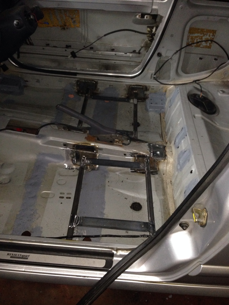

I made my own, 25mm box and 50mm flat, cost less than £20 for material

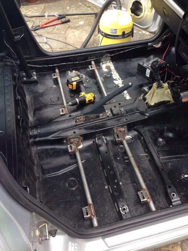

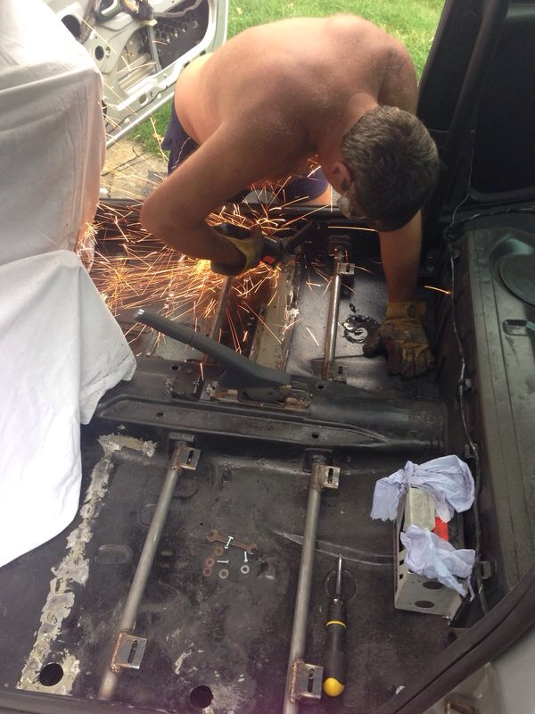

My brother did mine, but only cos I asked him to. It's a bit of a muck around job getting it in the right position. Be careful when removing the original seat mountings as I ruined my floor doing it!
Any confident welder should be able to do it I'd say. Only picky bit is getting the measurements and positioning correct.

If you're interested, give them a call, sure you could get it done whilst you wait if you booked a slot. I did it on the side thanks to Kelv, who knows the guy. So that's why it took a few days, which worked better for me anyway.
Remember, it is 4 bars to be welded to the floor, 8 plates on the end of the bars and 8 seat mounting points onto the bars. All needs to be lined up and positioned properly. So does take some time.
