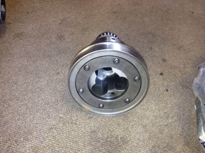

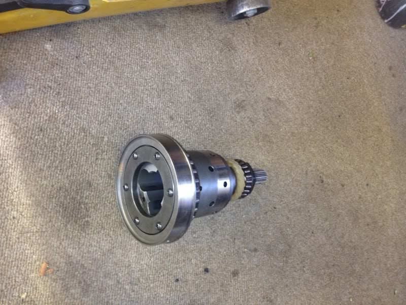

Only way to tell you have a quaiffe easily is to drive it and feel how well it lays the power down, or to pull the shafts out to check.
What would I be looking for, if I was to pull the shaft out, are they massively different to standard? Genuine question, as I bought a Cup a while back that ''supposedly'' had a diff and I wasn't 100% how different it would look over the standard item.
Cheers.
  182/RS2/ Turbo/Mk1
Cheers.
Yes mate, they look massively different.
you would know in an instant if you had the pass side shaft out.
  182/RS2/ Turbo/Mk1
Nicked from another thread:
Couple of pictures I've just taken of one of my quaiffe diffs to answer the question about how they solve the problem.
Im getting another box back with one fitted at the weekend so if you remind me I will take a picture of the quaiffe when its in the box.
