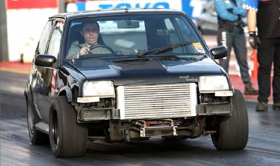

just a quick note congratulating scoff on breaking his P/B time at santa pod yesterday in his turbo'd F7R powered R5GTT..
his best time of the day was a 11.28 @ 124 mph with a personal best 60ft of 1.73
this time means its the quickest 5gtt in the country and i for one am proud for him
i can tell you this car isnt far of 10's now...with the minor fix of a misfire in 3rd he'll be there im sure

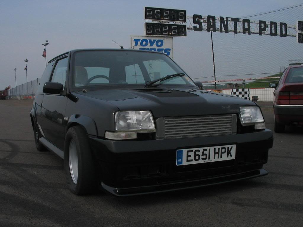

What are those front wheels on it in the top pic ?? They banded wheels or something ?? They look proper odd.
there an M&H drag stick mate...25" tall mounted on a wheller race rim....infact there the same wheel as posted in the last picture, only differance being the smaller 13x10 rims:)
Wouldn't pass it's MOT.
funny, it passed just fine last month :) Ok, not with those front tyres, and maybe it had the front bumper fitted ;)
the car is 100% road legal, looks oddly. rough in that 1st picture, its actually in pretty good shape.
the tyres are FWD M+H drag tyres, they're about as good as it gets for FWD drag. The rims are my own concoction, they are made from 5" steel rims banded out to 7.5J. The original wheels are the wellers, which are the black ones in the 1st pic, they had a silly offset on them and caused alot of drag - they also prevented me from fitting the front bumper, as you can see.
If anyone cares, the engine is from a clio 172, with 83.5mm crank from a volvo 480 giving it 1800cc and low compression. the 1800cc gives the gearbox a fighting chance, which is only a standard 172 JC5, but still lets me make good HP but at higher RPM ofcourse. Its making around 360hp at 1.6bar boost from a cosworth T34 normally found on a group-A escort and is managed by an Adaptronic ECU mapped by myself.
