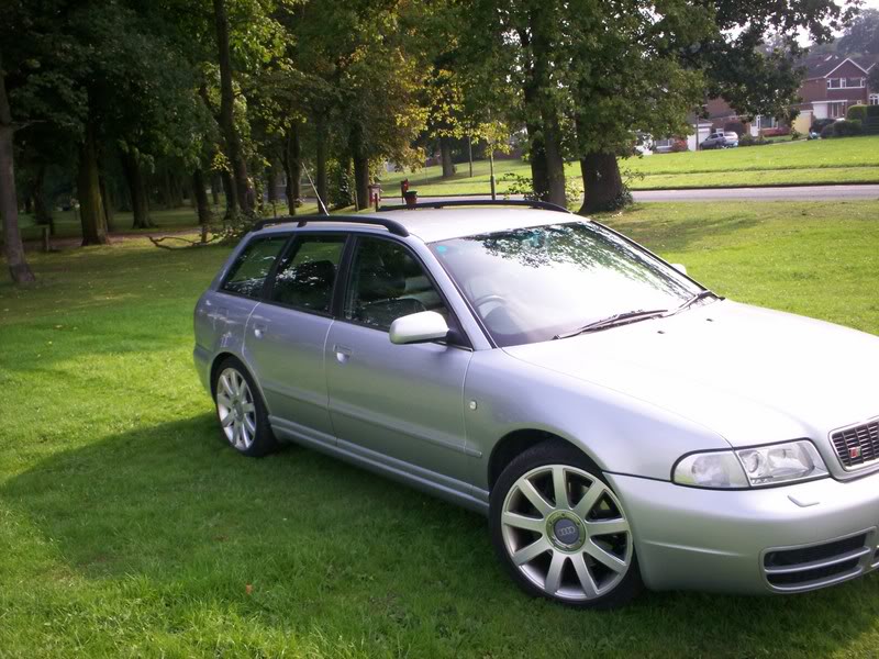

Great cars, i had a 390bhp avant, total wolf in sheeps clothing, full AMD conversion, frightened quite a few porsches, not too mention some others who got a fright, the torque was amazing, well over 400lbs/ft.
This was mine.

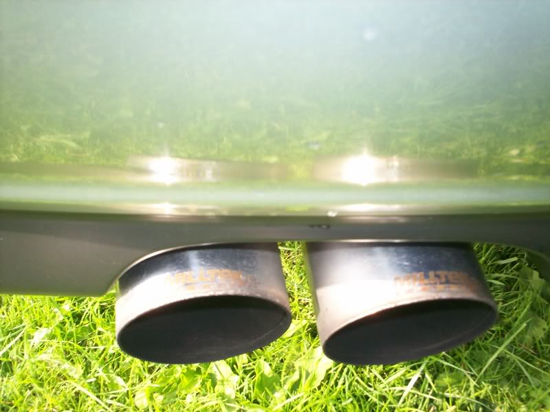

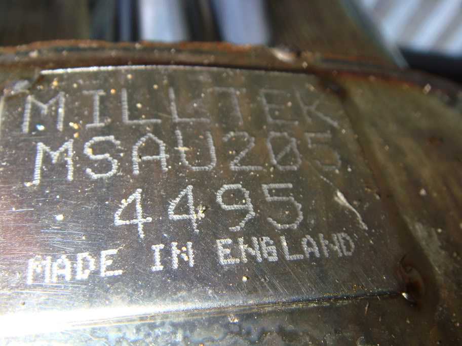

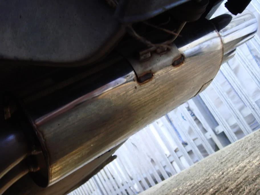

Full Milltek system sounded lovely.

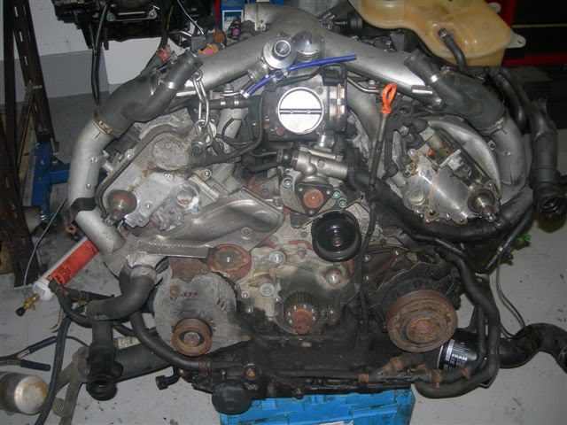

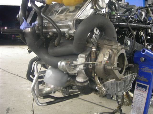

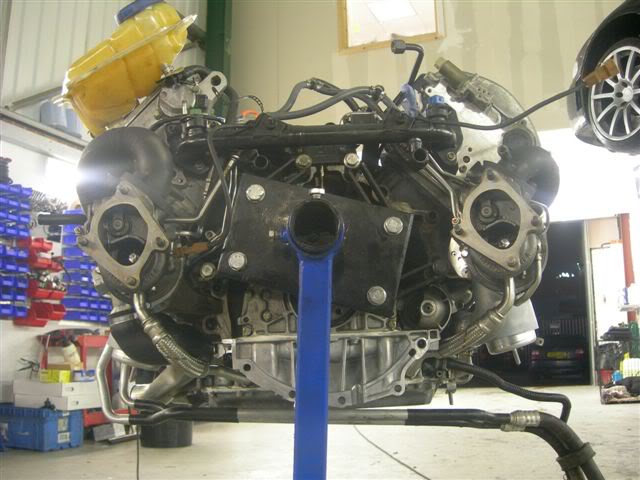

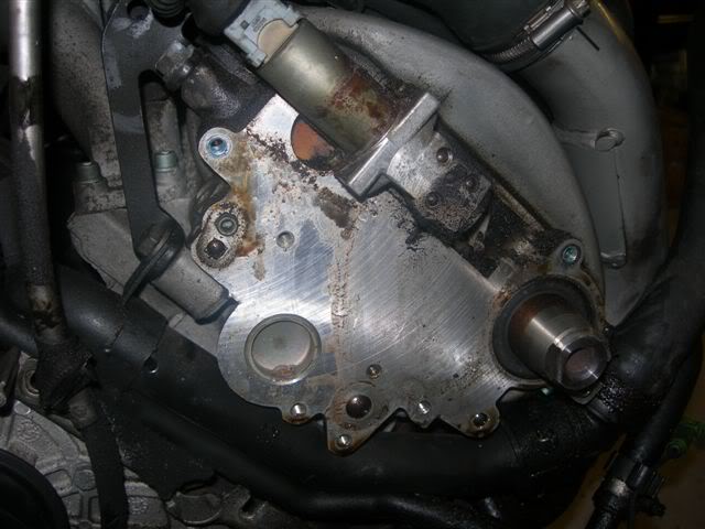

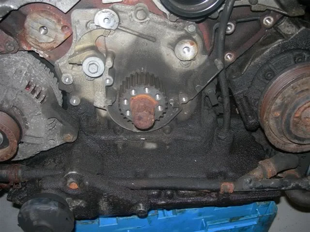

Meanwhile the guys in the garage stripped the engine out to check it over:

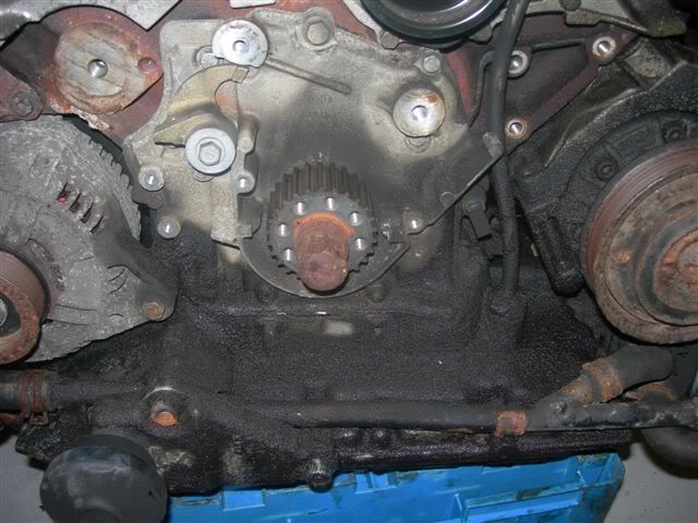

Engine out

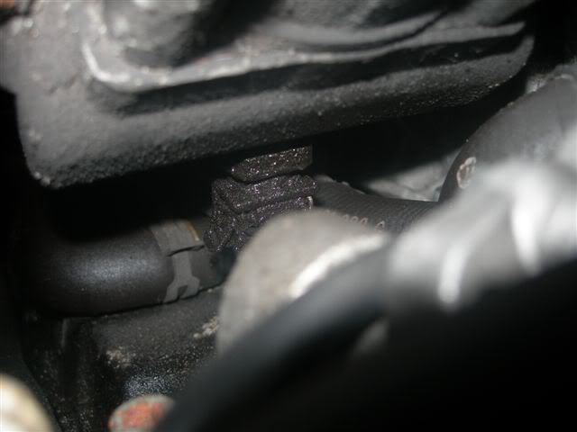

Oil behind cambelt
Again, looking suspiciously oily, and corroded
Oily hoses :/ not entirely sure of what they are

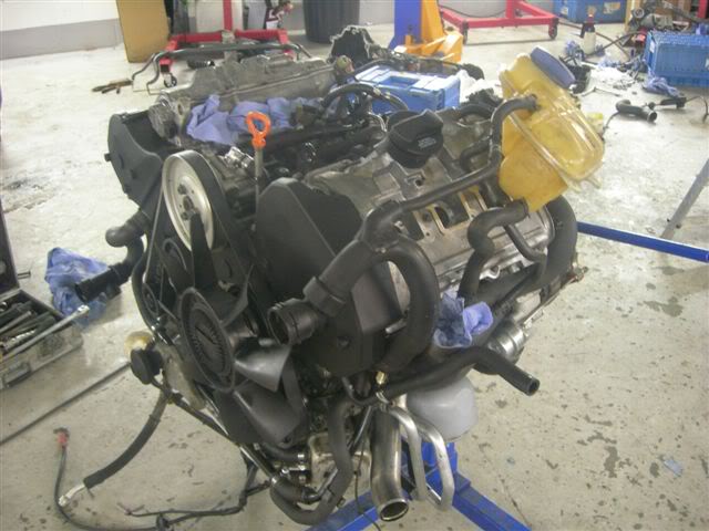

The engine was then completely stripped, cleaned, inspected, then rebuilt.

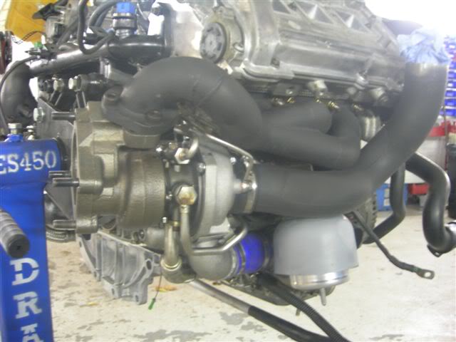

Sourced a set of relatively new but refurbed RS6 turbos, had them modified to fit the S4, and hot side housings swapped for RS4 units for a better spool up time.
MRC intake pipes and tubular exhaust manifolds.
Engine rebuilt with uprated rods, rings, bearings, honed bores, full new cambelt and water pump service.
Difference speaks for itself really doesnt it!

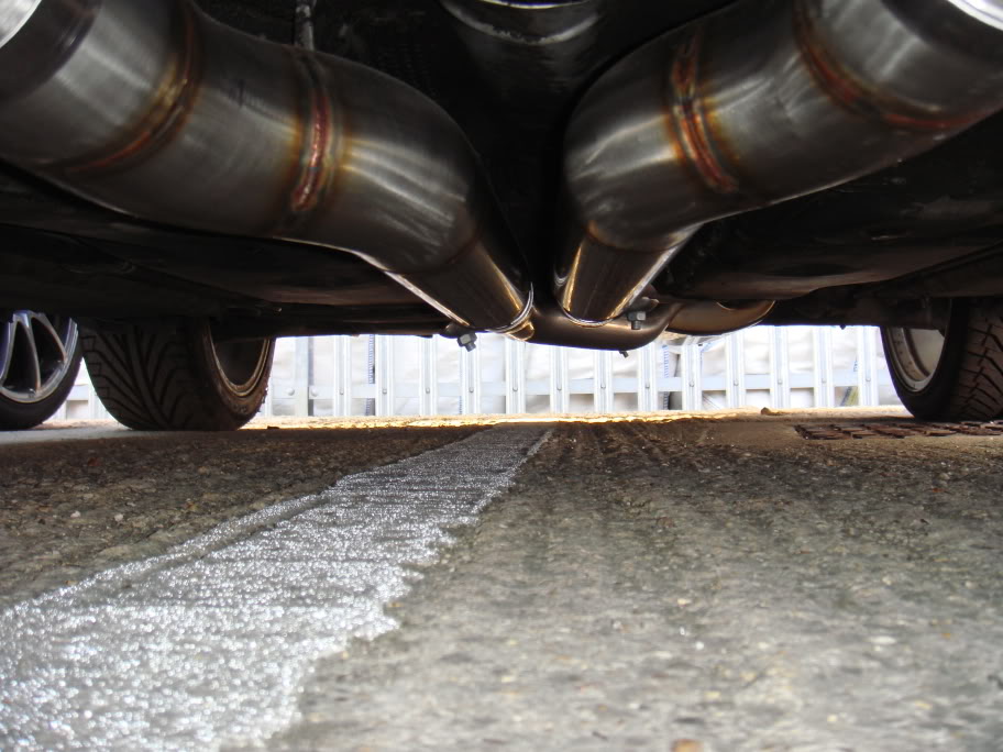

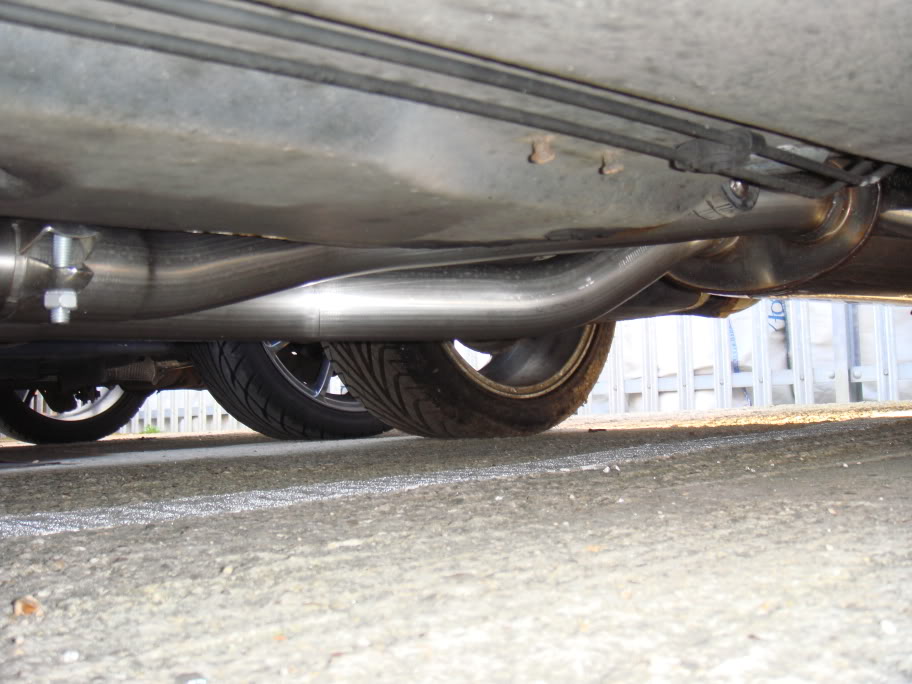

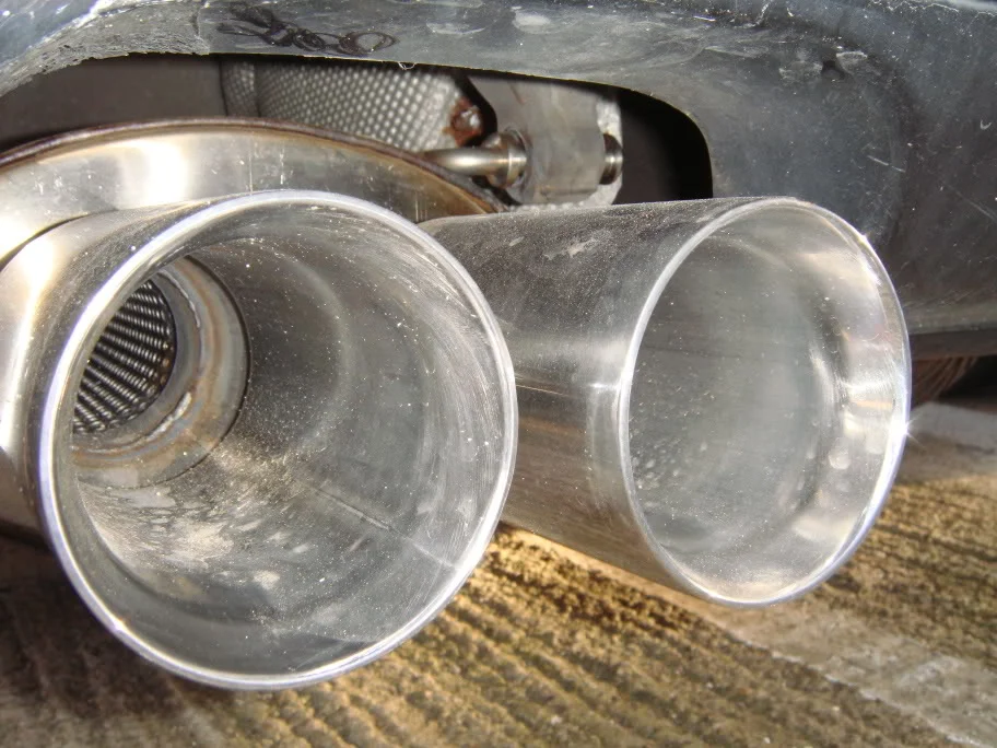

3" catless downpipes, link pipes and true dual Milltek which tapers to 2.75 at some point and ill be using middle and back boxes,

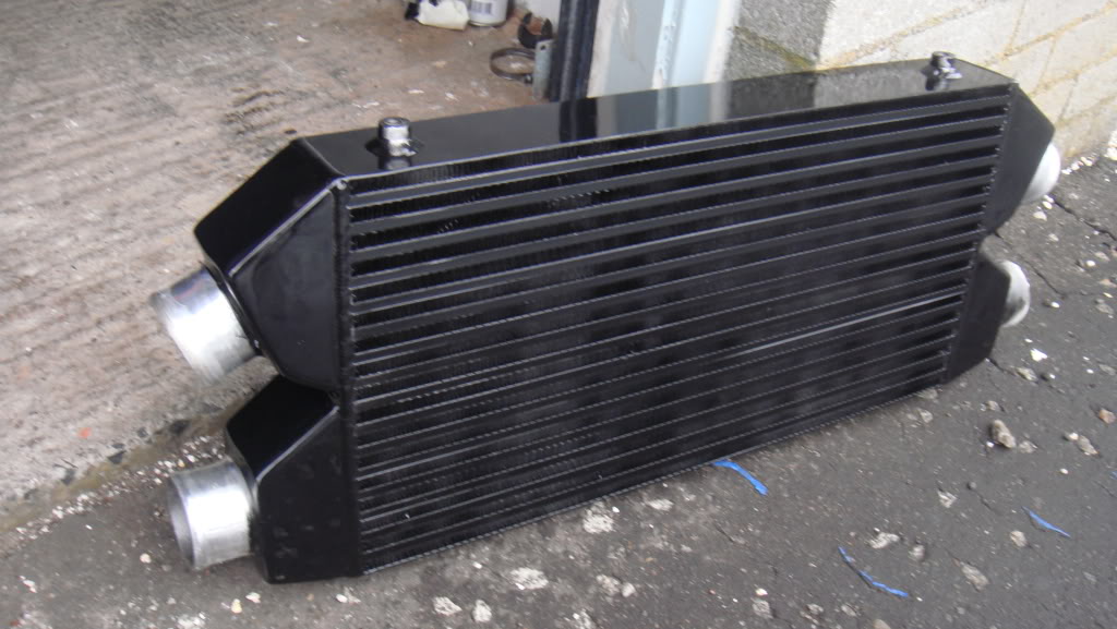

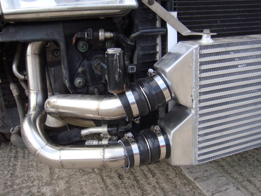

MRC front mount intercooler,

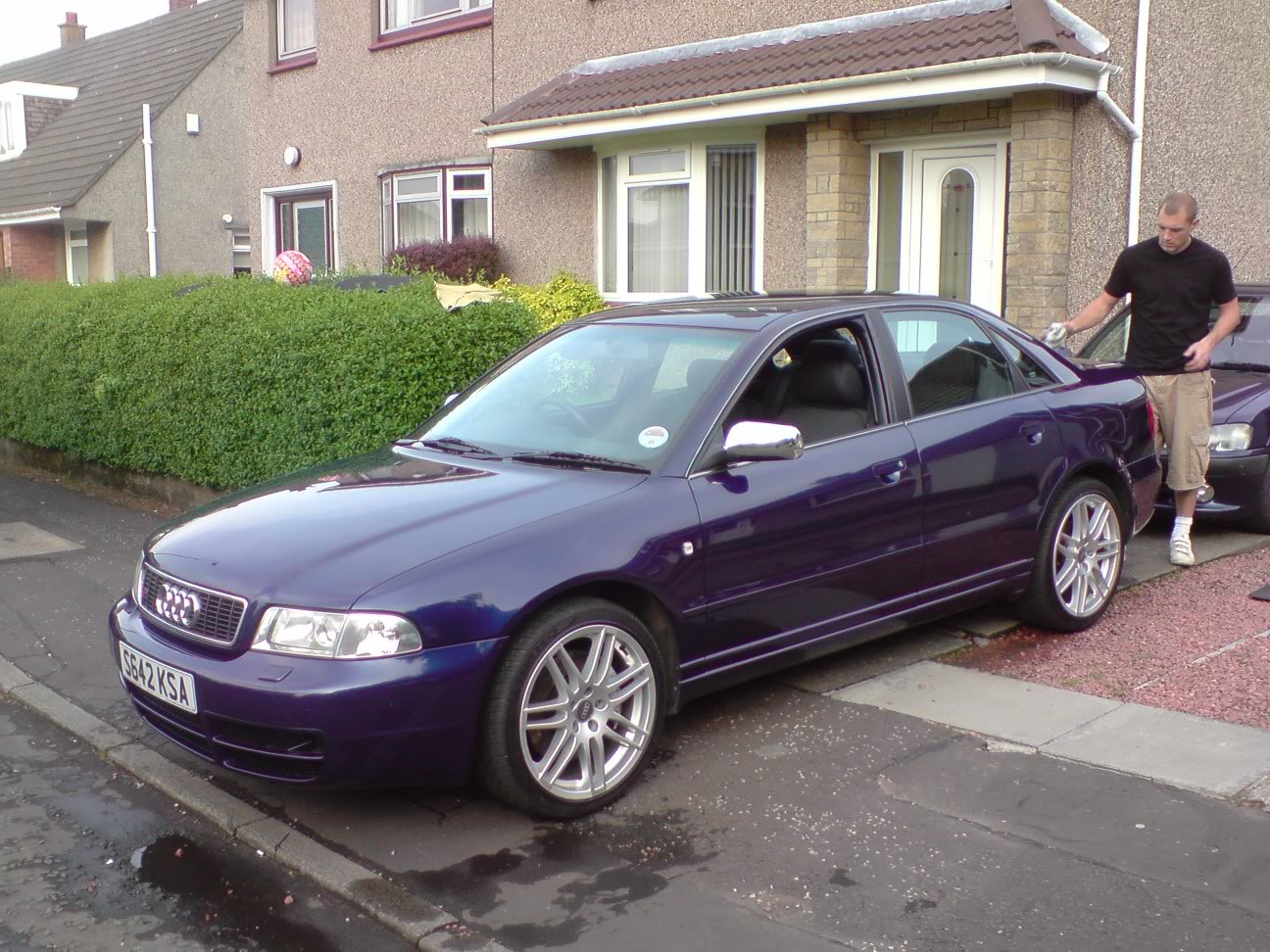

This is how the car looked when I got it home after buying and then valeted.

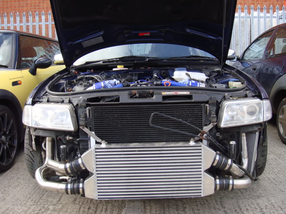

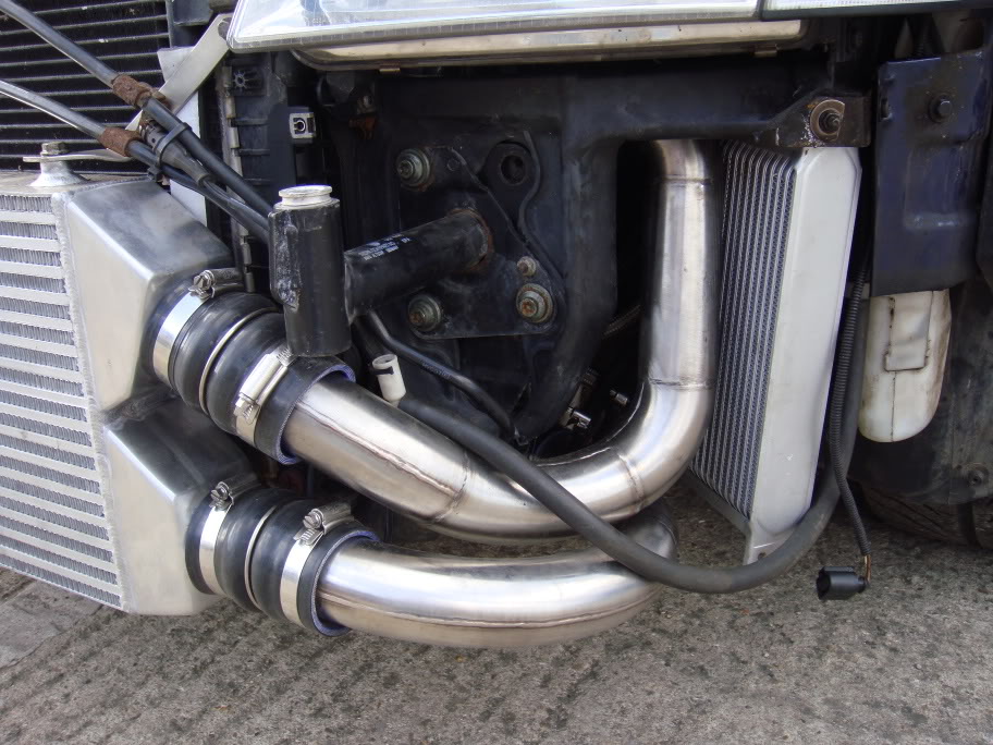

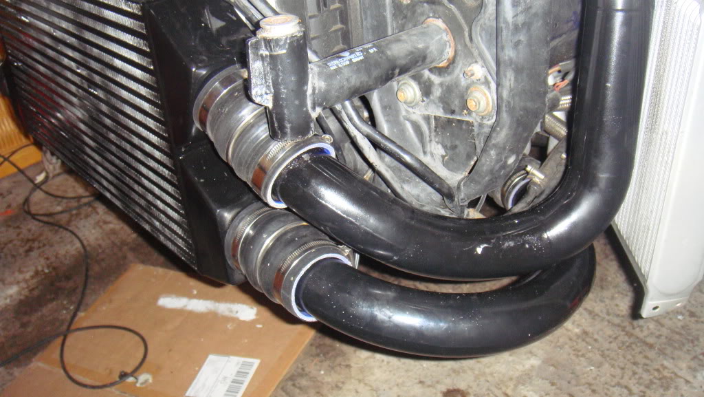

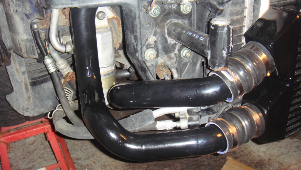

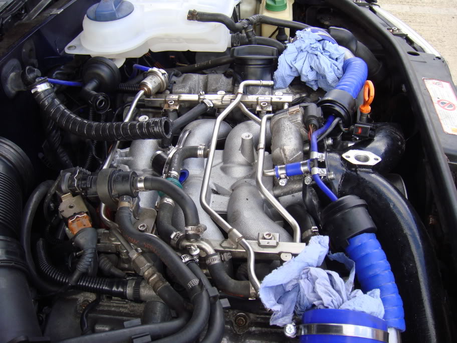

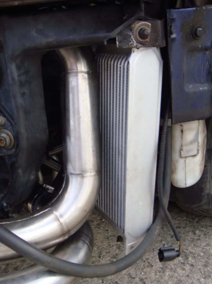

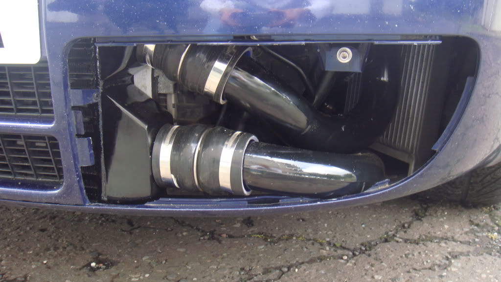

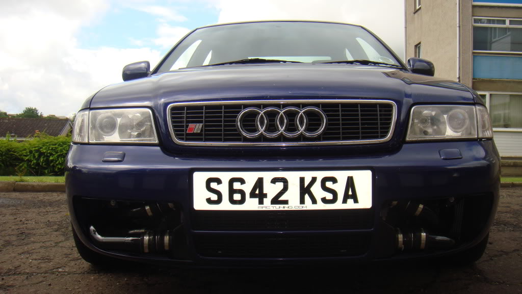

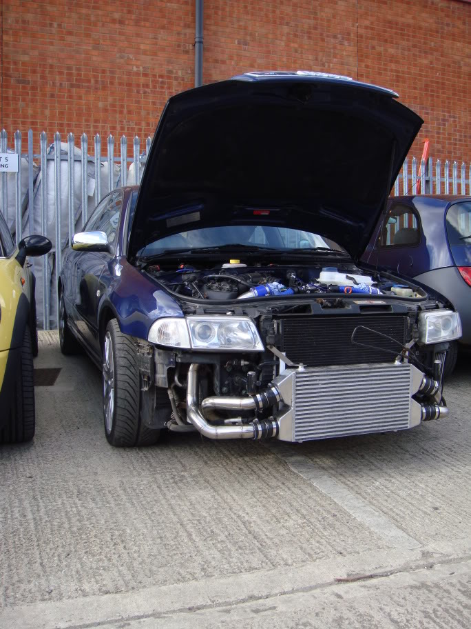

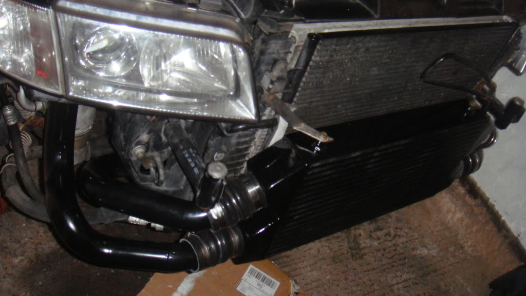

FMIC mounted up
FMIC Near side pipework
FMIC Offside pipework + oil cooler
Oil cooler in place of IC

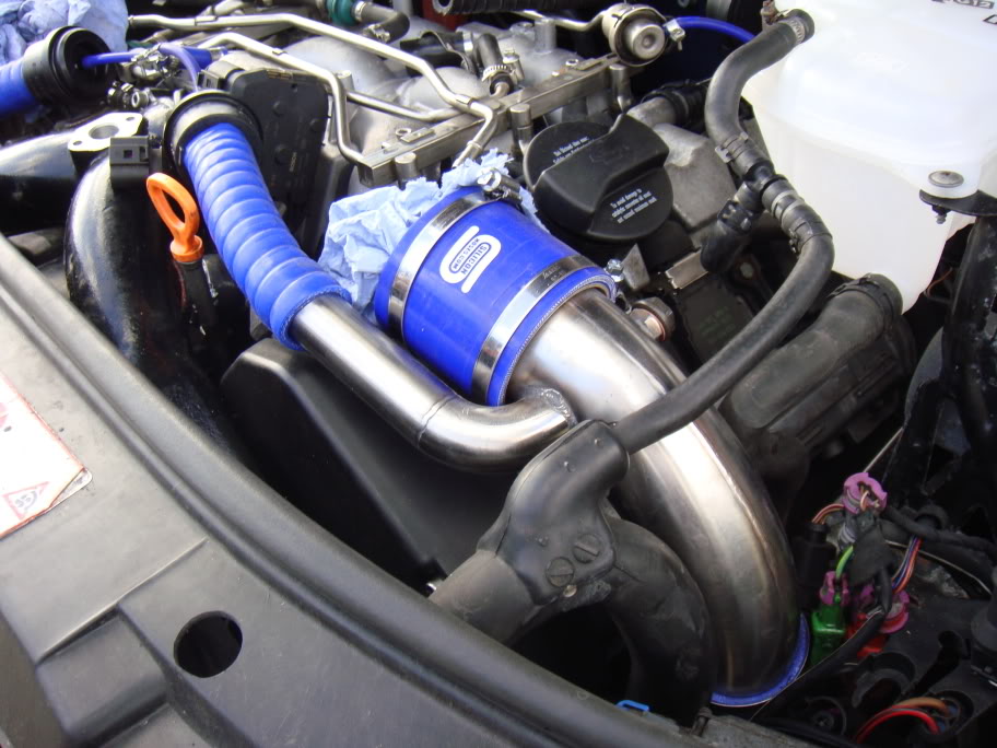

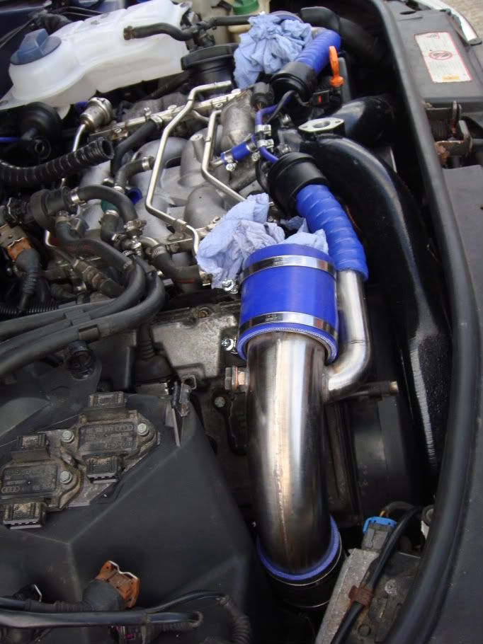

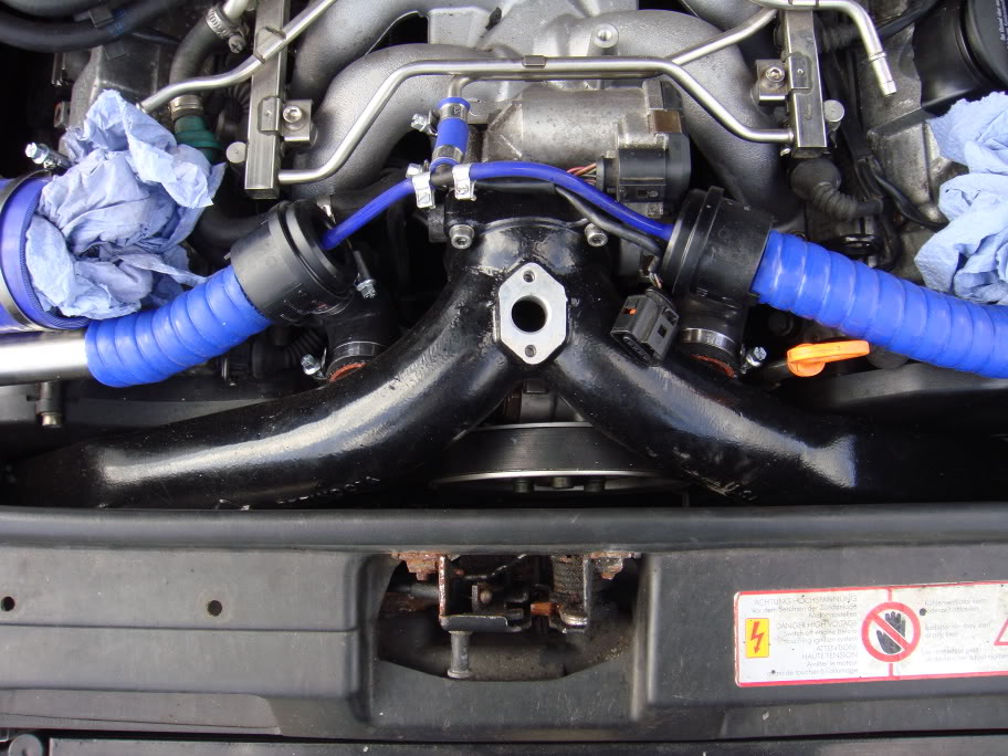

OS intake

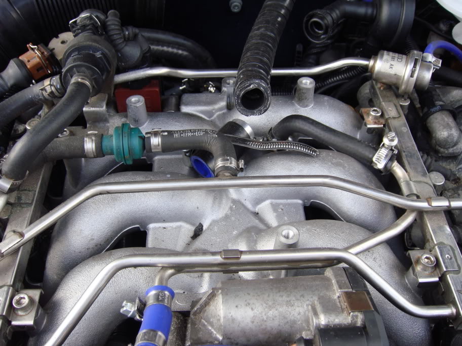

New Fanimold
APR Bi-pipe
Side on
NS intake

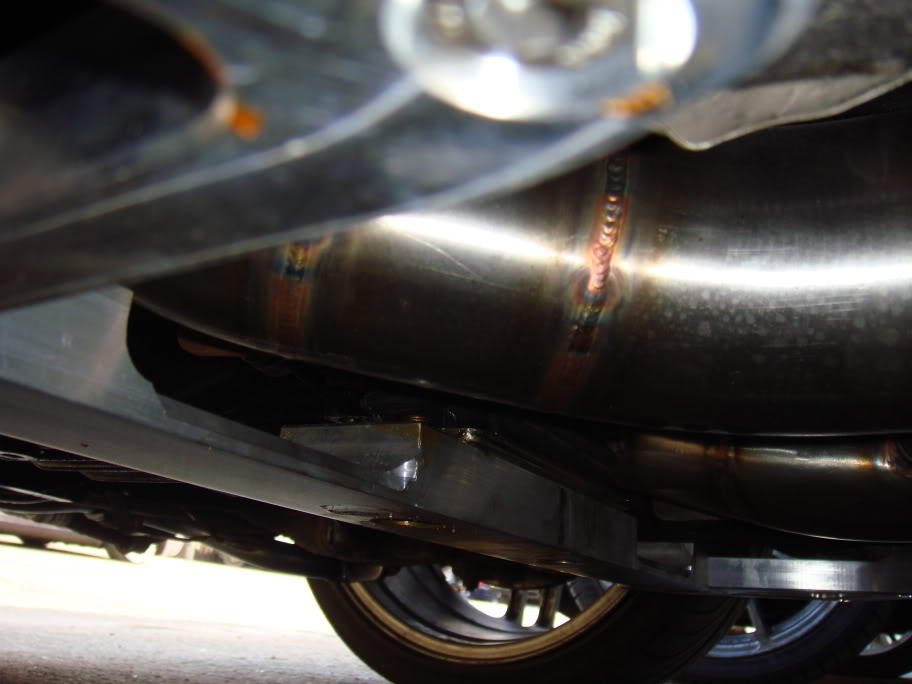

DTS

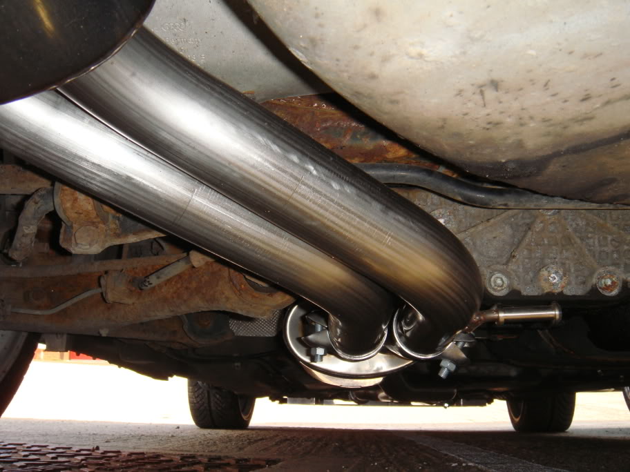

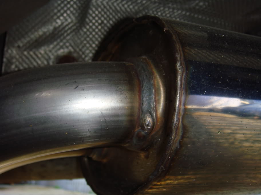

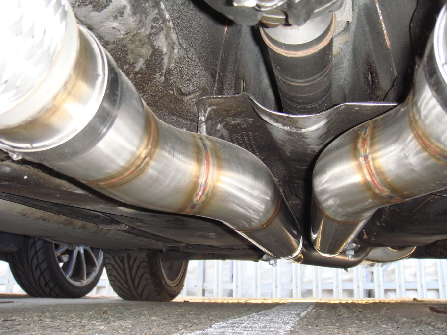

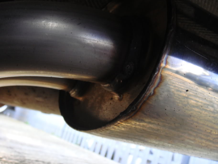

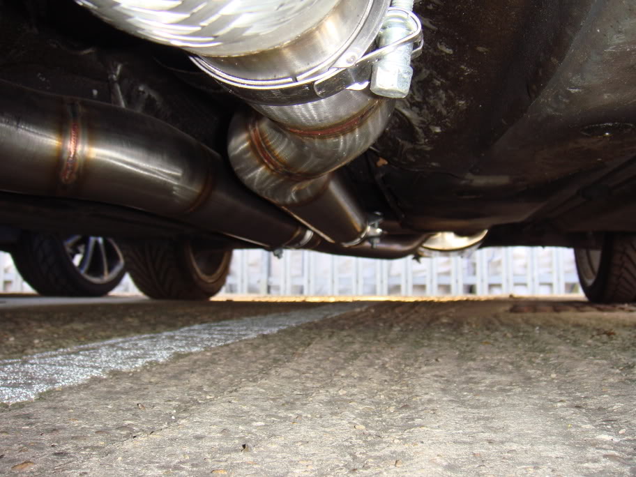

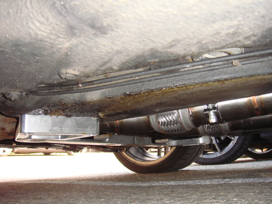

Welds on exhaust

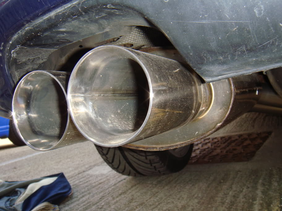

Flexi back
Awkward photo to take
Relatively clean for a 10yr old car I think

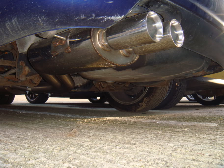

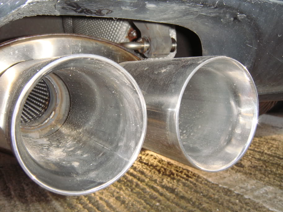

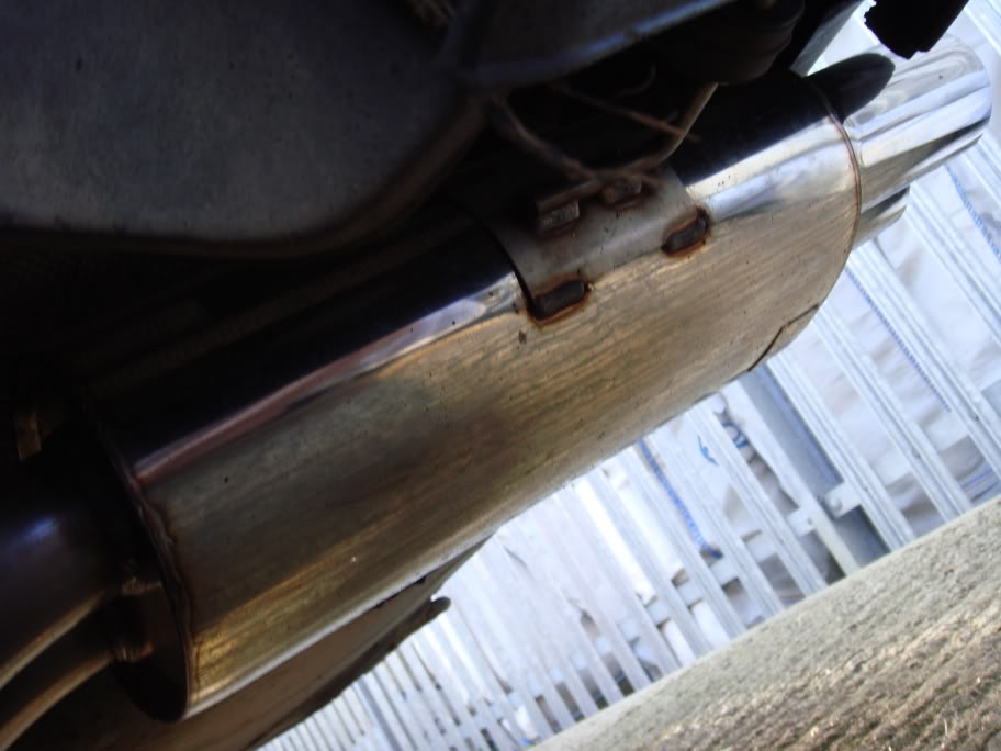

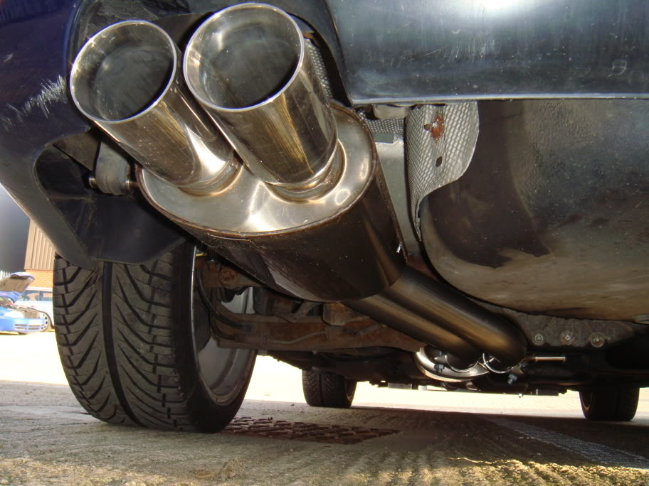

Milltek

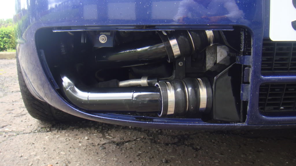

FMIC and pipework will be painted black and bumper regrilled, not sure with what yet though.

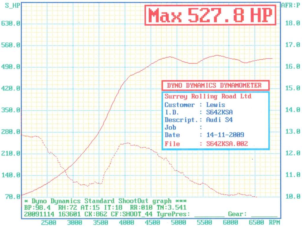

Wee update not done any work on the car yet but picked up my MRC filter today, will fit that tomorrow morning.
Also having the passenger side turbo pipework changed on tuesday, going to try welding a 90deg bend onto the hard pipe between the turbo and IC at the turbo side and fit a silicon 90 between, hopefully stop it from popping off!

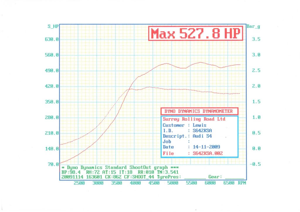

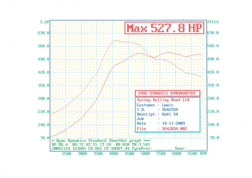

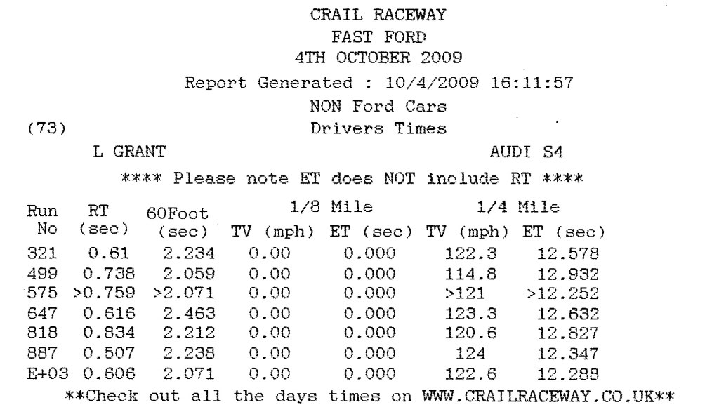

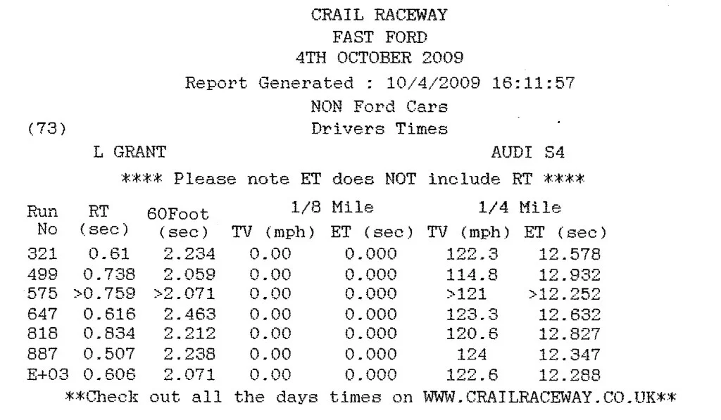

Crail times from my last visit:

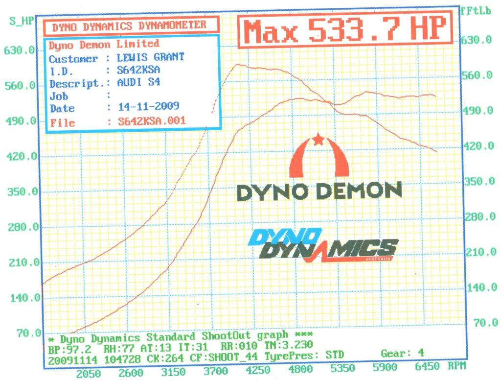

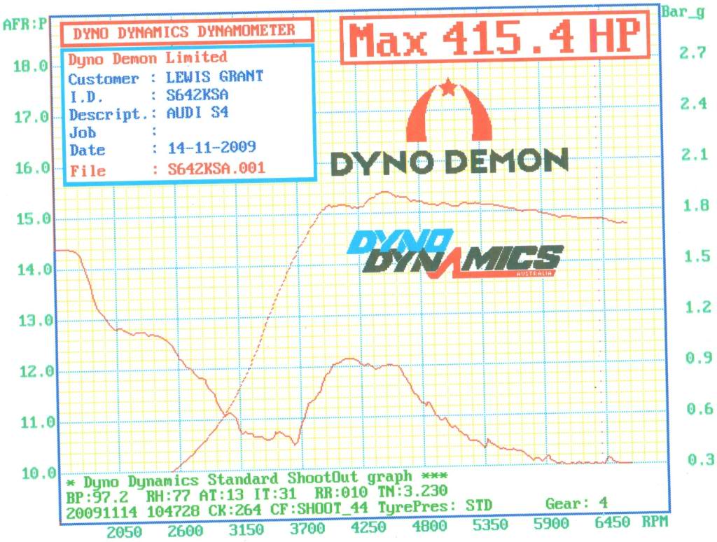

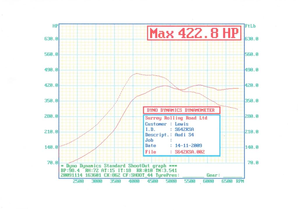

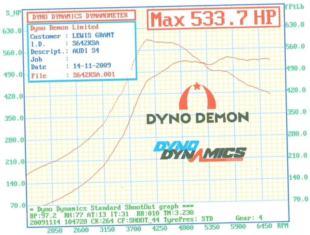

Printouts from todays RR day.
North
Flywheel:
Crank:
South
