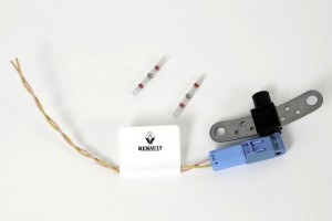

Last mine sat and clicked, the loom to the TDC was fubar - Water and all, it's worth a try replacing it before going down the new lump route.
Said sensor, it's on the top of the gearbox where it meets the block. 2 Bolts.
Try replacing the crank sensor if not change the engine ?!? That's good advice!!
