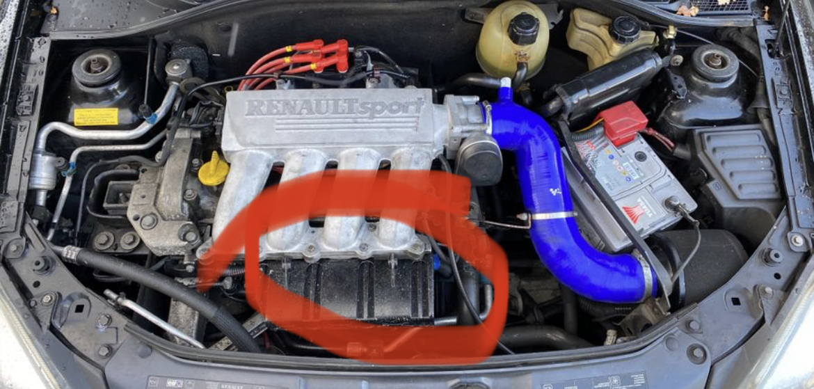

J jody391 ClioSport Club Member clio 182 Sep 28, 2022 #1 Daft one maybe, what’s the purpose of this aluminium block? Attachments E9C454C9-F4BC-49C0-A58C-7323E83B361A.jpeg 679.3 KB · Views: 53
Sir Nancy Flowers ClioSport Club Member M140i Sep 28, 2022 #2 jody391 said: Daft one maybe, what’s the purpose of this aluminium block? Click to expand... Its a cover for the injectors essentially. In the event of a front end crash, it stops the injectors dismounting the block and squirting fuel all over a hot engine. Lots of people remove them, I did when i had my 182, but with hindsight I should have kept it!

Bankrupt_drunk ClioSport Club Member Clio 172 Sep 28, 2022 #4 People remove them to save weight and for easier access to the oil filter. But they are there for a good reason.
