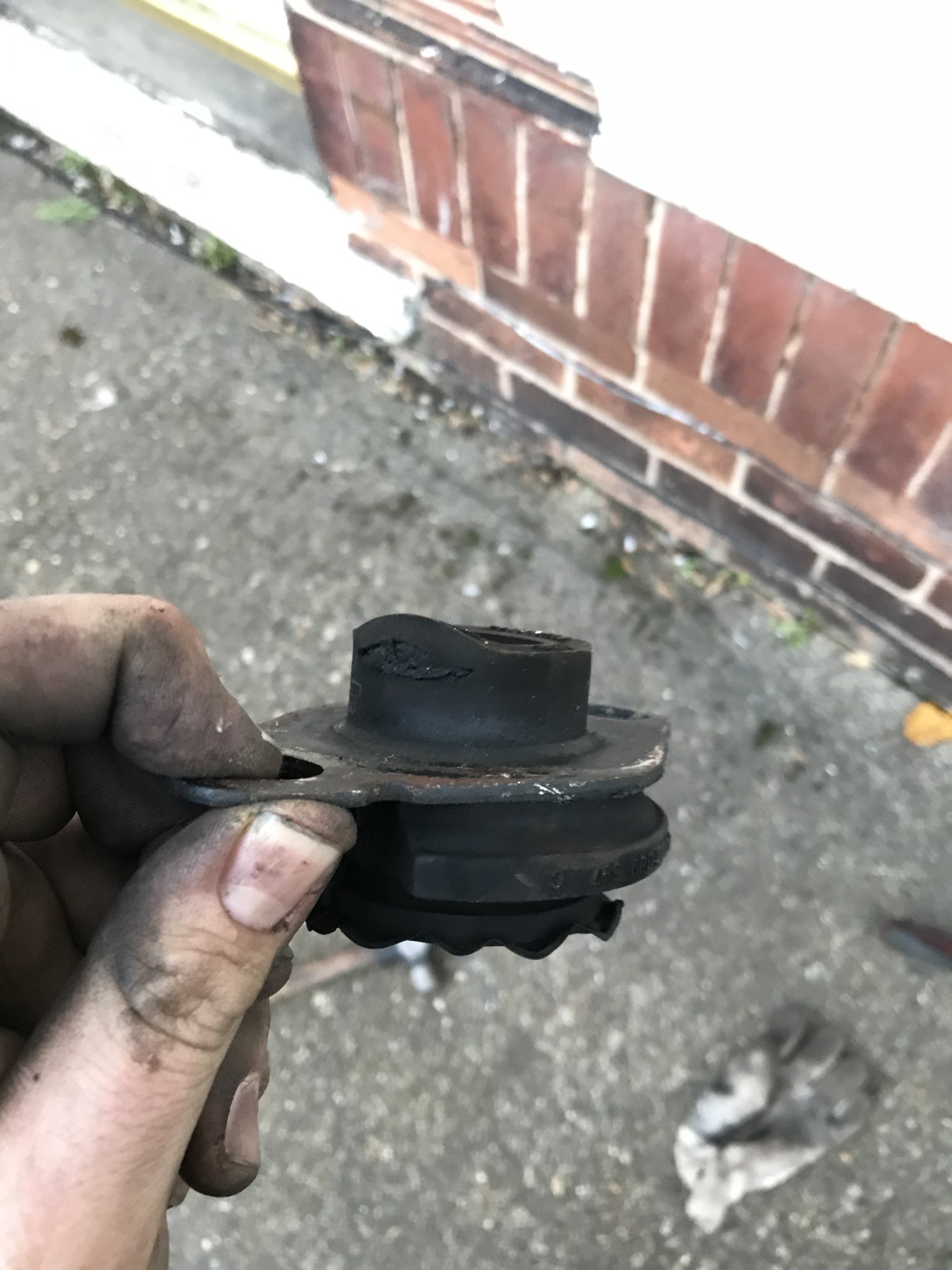

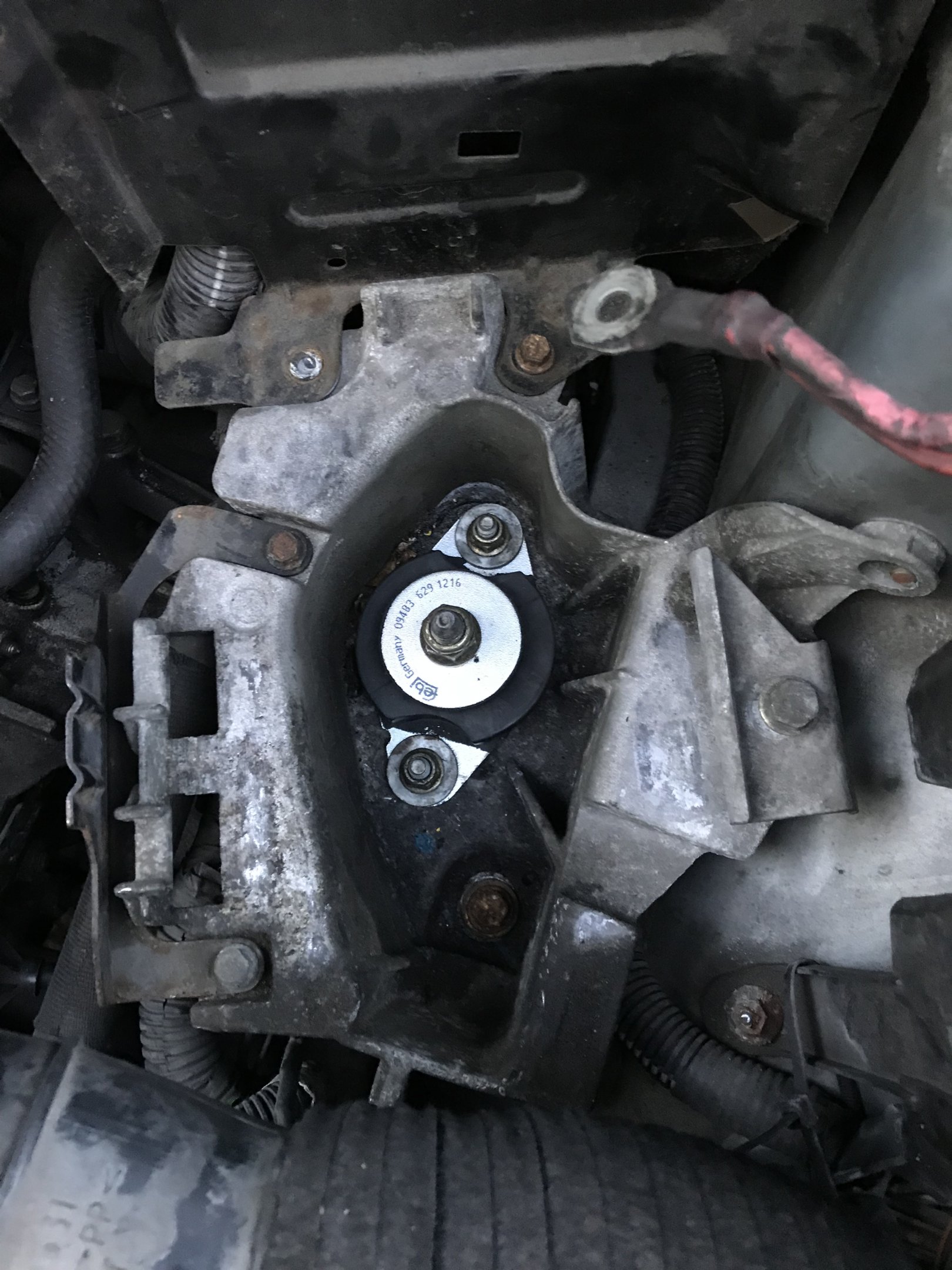

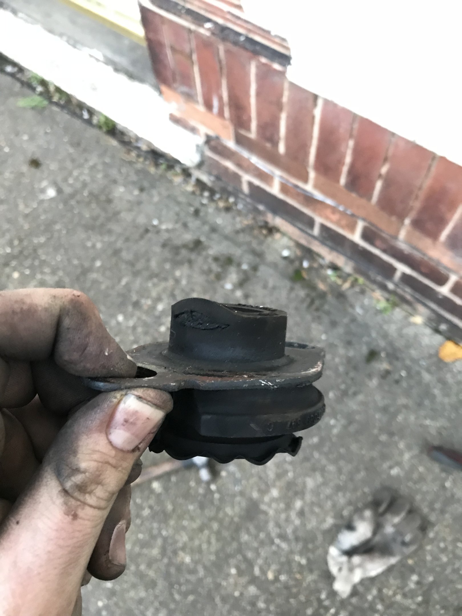

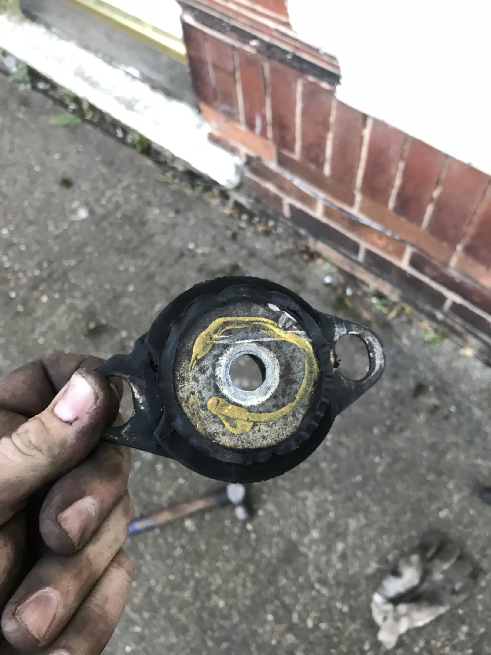

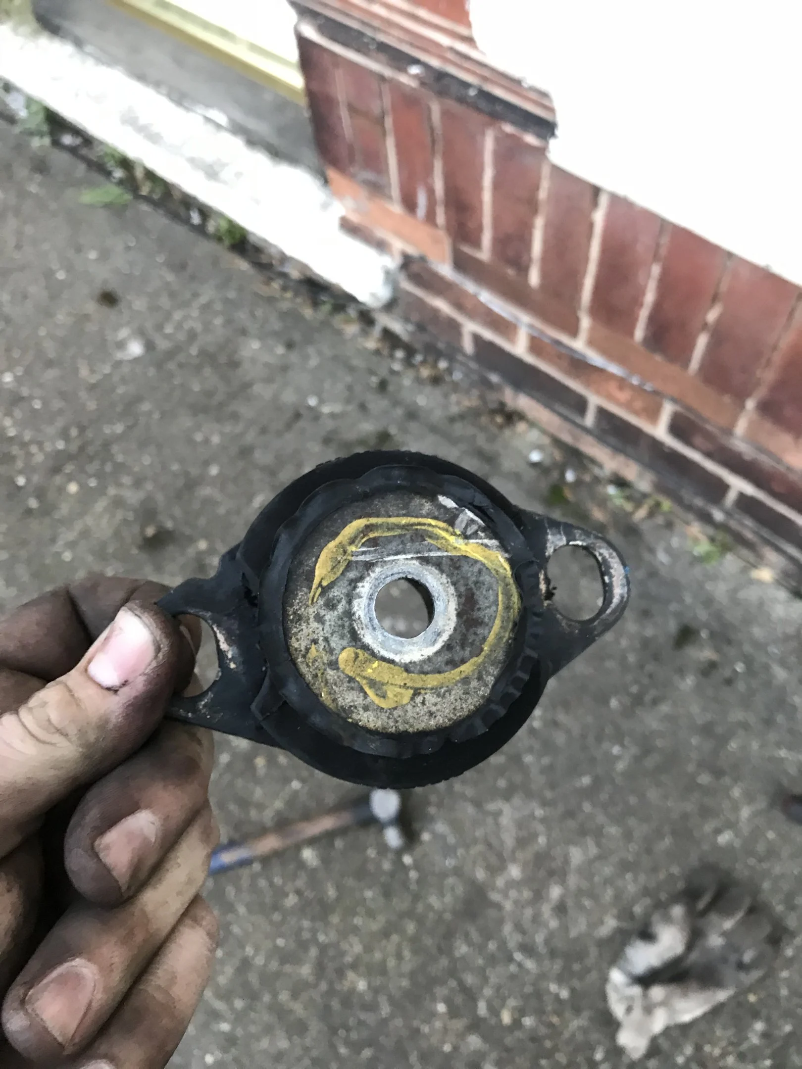

I’ve replaced the bushes on the lower mount but it’s still popping out of 3rd occasionally...any ideas?
So I’ve swapped both the top gearbox mount and the dogbone bushes. Fingers crossed. If it still pops out then I’ll drop the gearbox oil this weekend and check for metal flakes...
