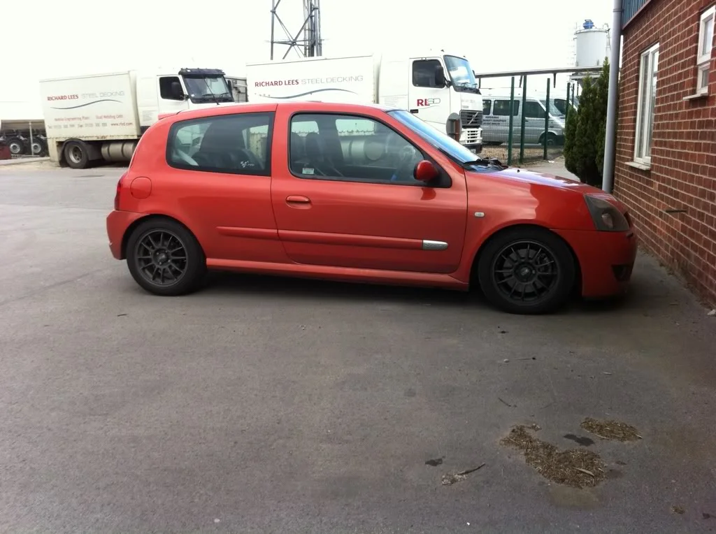

This is my 182 when I bought it;
That has 15mm front rake believe it or not.

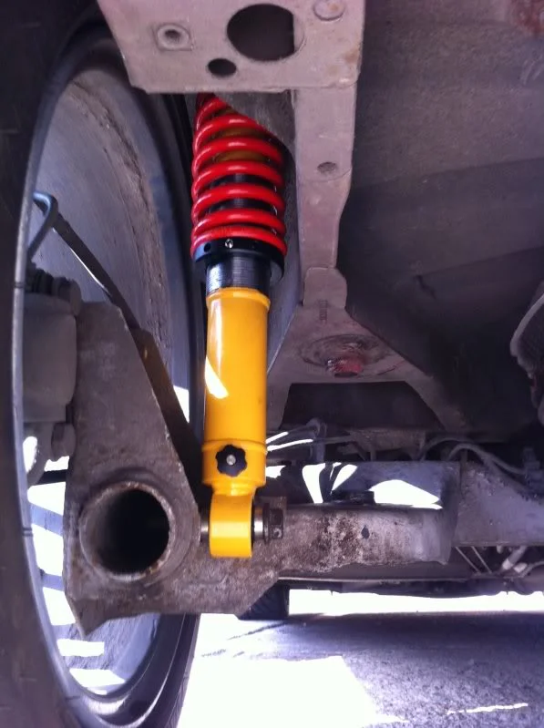

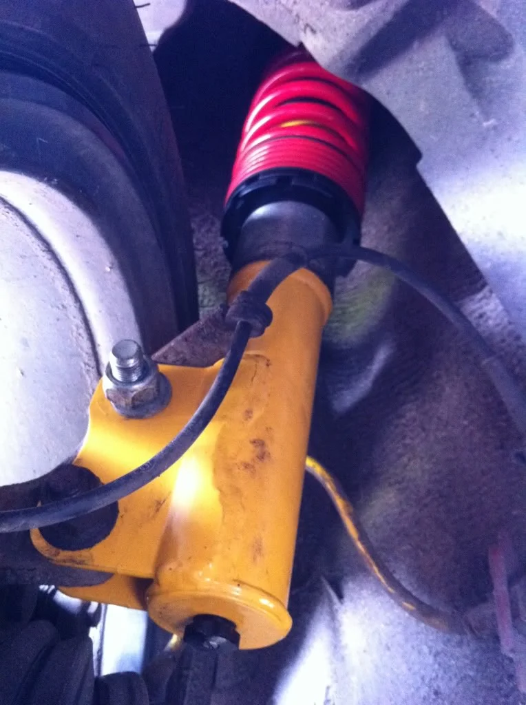

Well this is how Dave's sits on 15s with Spax coilovers
and this is hom much more adjustment there is on the rear
and front
the car is setup for handling and ride more than cosmetics
