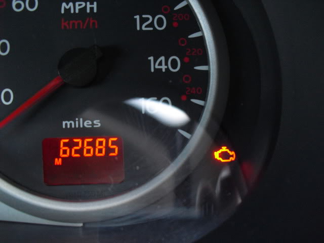

what does this little blieter mean???
started her up just and this is on, cant see or feel anything wrong, drives the same???

Engine management light.
If it drives ok its nothing to panic about (yet) but it will need plugging in to a diagnostic machine to find out whats wrong.
If it starts to misfire or play up at all, don'tdrive it as it will bugger up your cat.

ive been up my mates today, hes got some sort of plug in jobbie, paired it up with the laptop and it came up with PHASE 1 OXYGEN SENSOR! so its a cheap fix, i'll get one tomorrow and throw it on. thanks for the help everyone,
