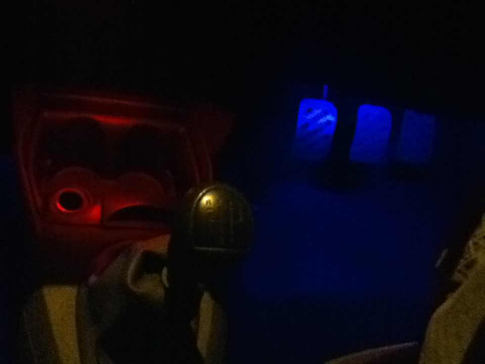

Excuse the poor iPod Touch quality, but here it is. The red, looks more orange with this camera, strange.
