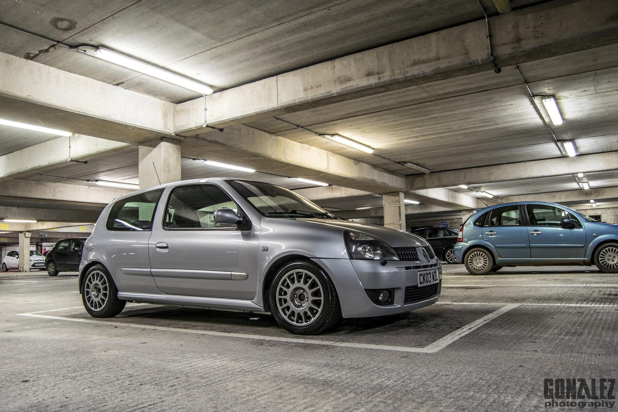

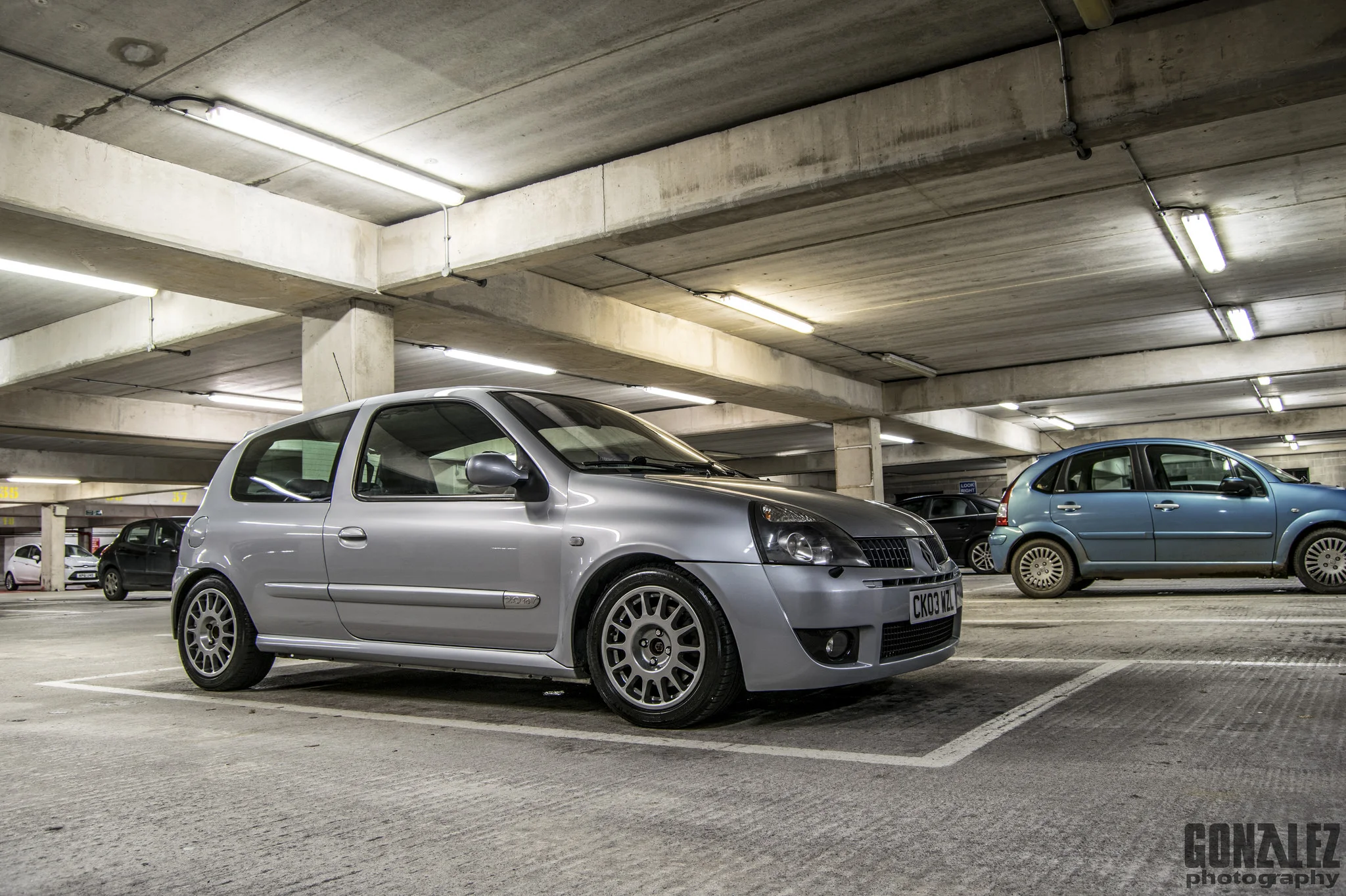

Well managed to fix the damage, and the car is now back on the road again... Had the local wheel alignment specialists check all the alignment, which was then adjusted but nothing has bent or broken which was lucky. Also replaced the exhaust mount as the backbox was cable tied on as the rubber mount insert was almost non existent. No more rattling when driving (crashing?) along.
Spent the whole day detailing it, as it was in a pretty bad state and clearly hadn't seen any polish or wax in a long time. Two stage machine polish using 3M Green/Blue compounds, Auto Finesse paint sealant applied and allowed to cure followed by Poorboys white diamond and two coats of WaxAddict Vitreo that I managed to buy a few weeks back when it was on sale half price (£30 instead of £60 a tub). Really pleased with how it's come up, still needs a few bits sorting but for a weekend/track toy it's a great starting point. Future plans for the new year (and probably beyond) will be to strip the rear, cage, better tyres, smaller steering wheel and probably some bucket seats.

Well that looks bang on that need 2118s in my life

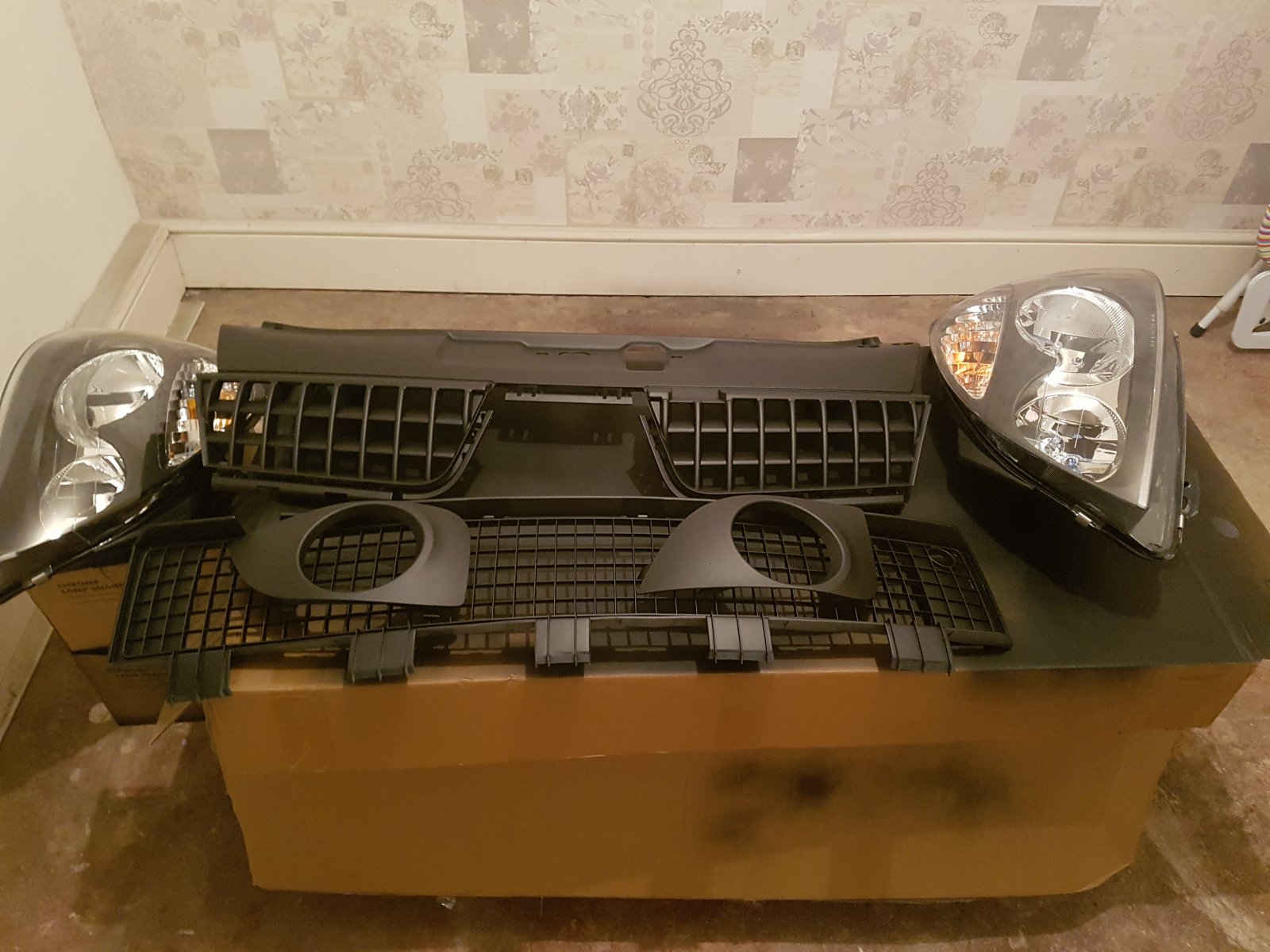

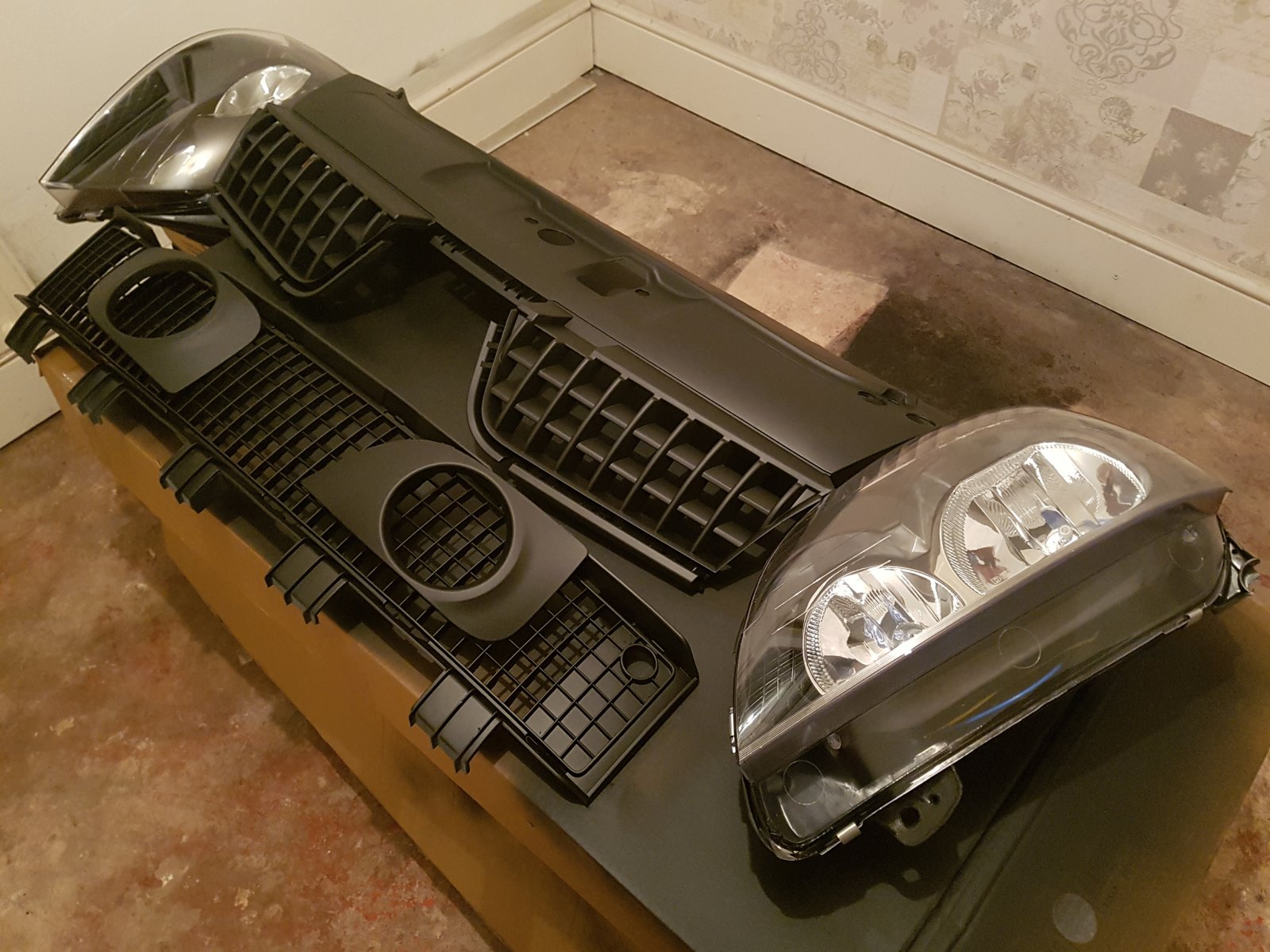

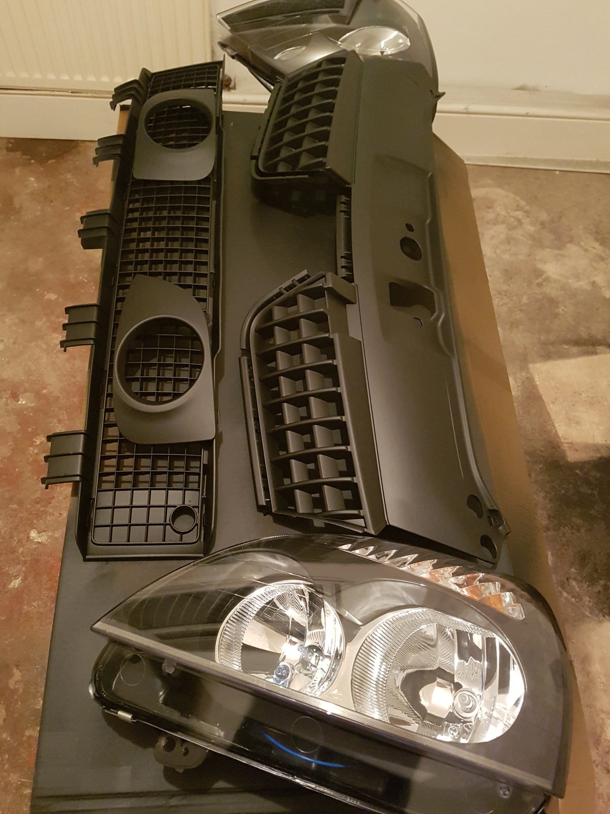

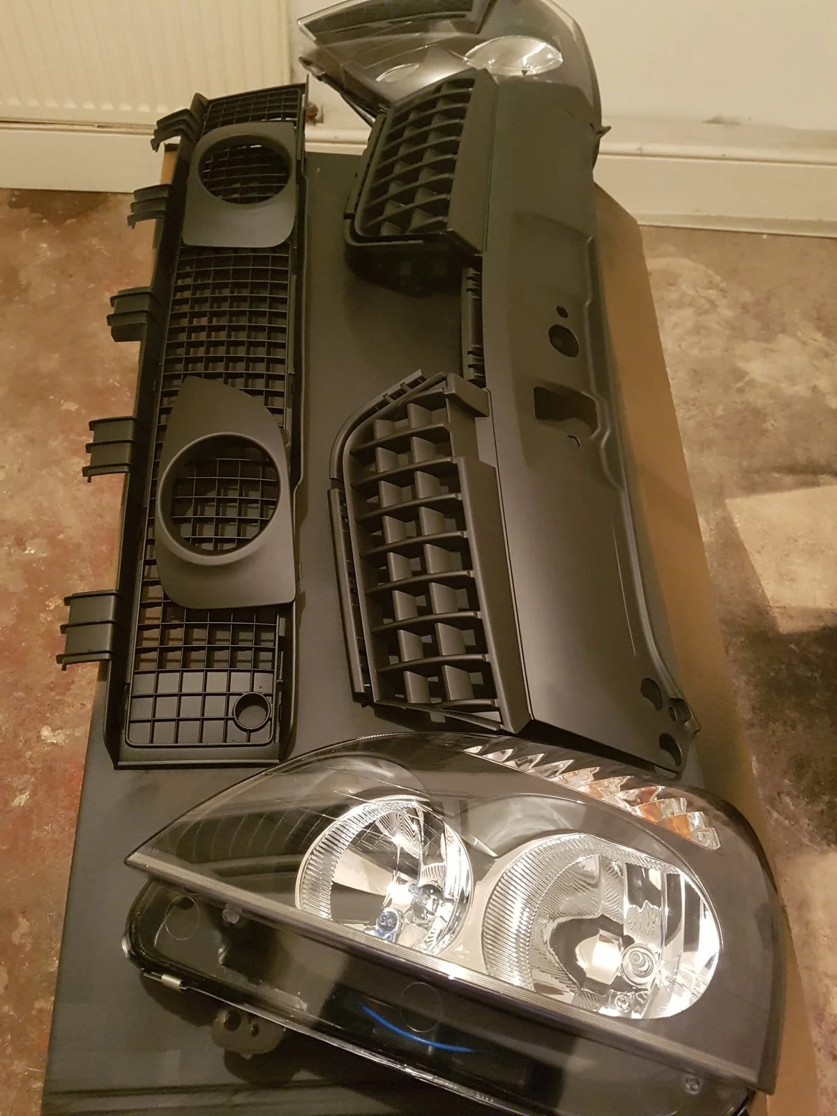

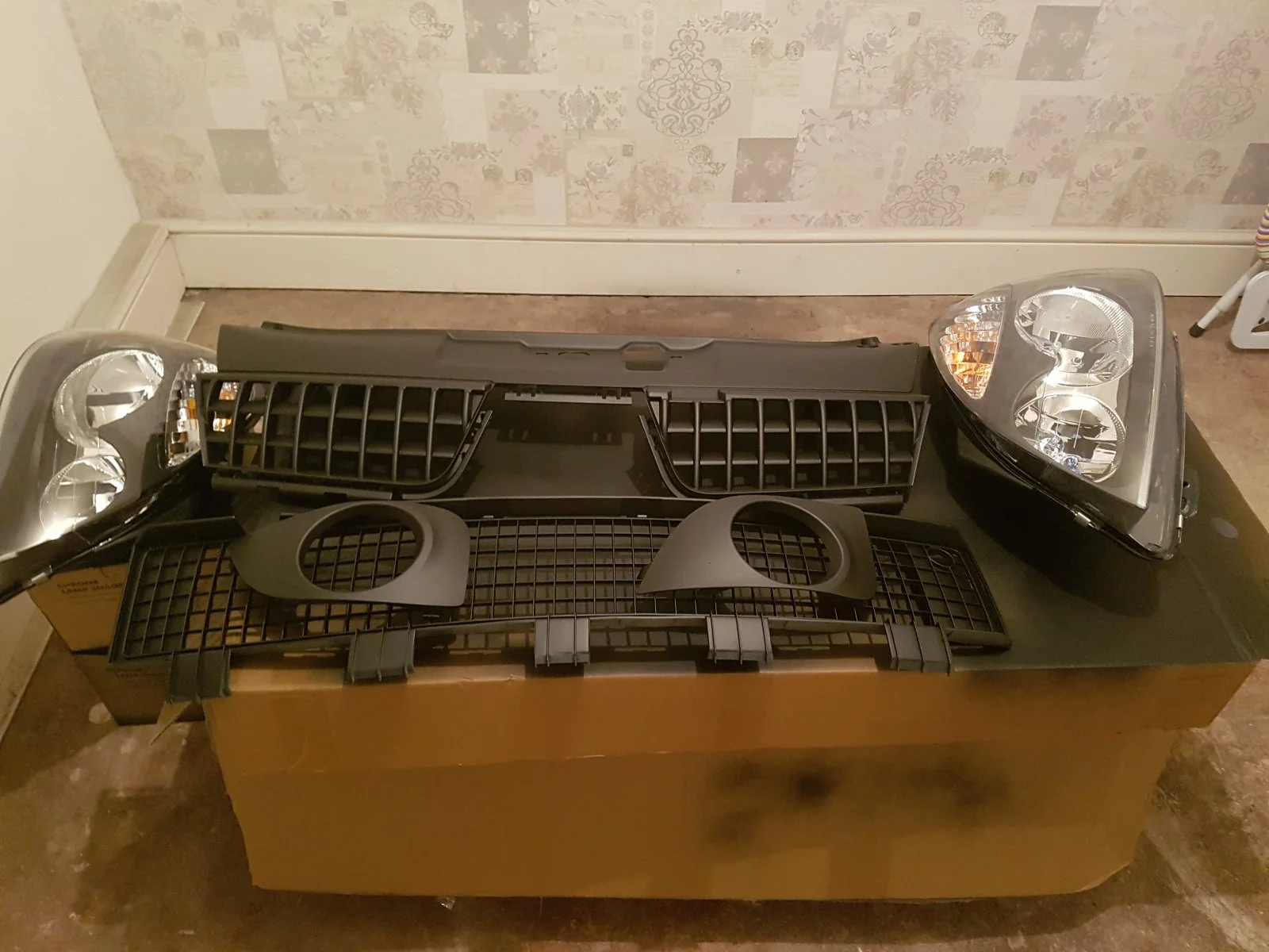

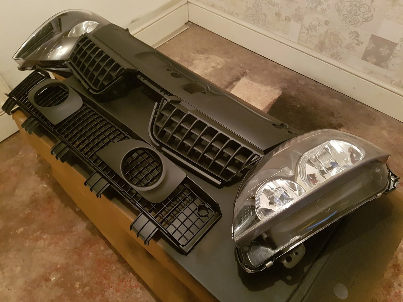

That looks great mate. Any chance you can tell me your prep and what paint?
Cheers mate, good clean first an decent degreaser. Then some plastic primer from halfords an 2 tins of Matt black cost about 20 quid all in bud. I normally use auto Glyn trim restorer but doesn't really last that long.
