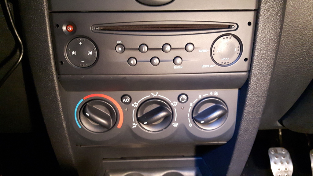

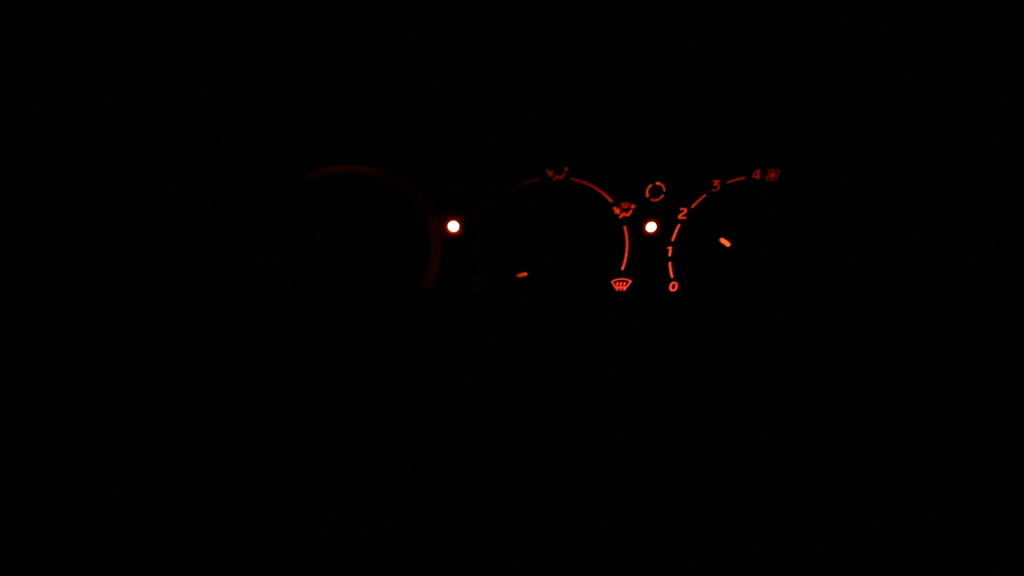

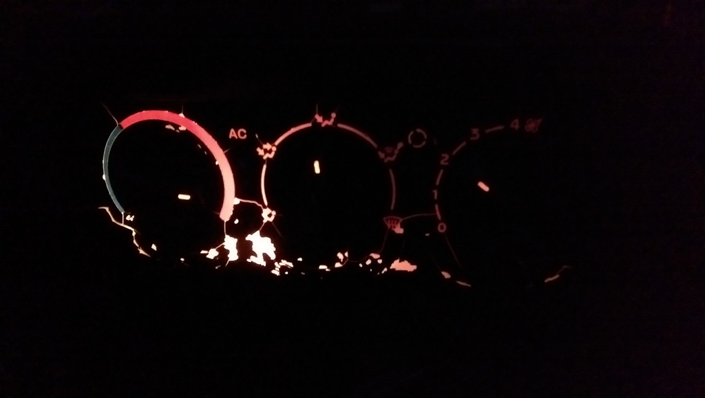

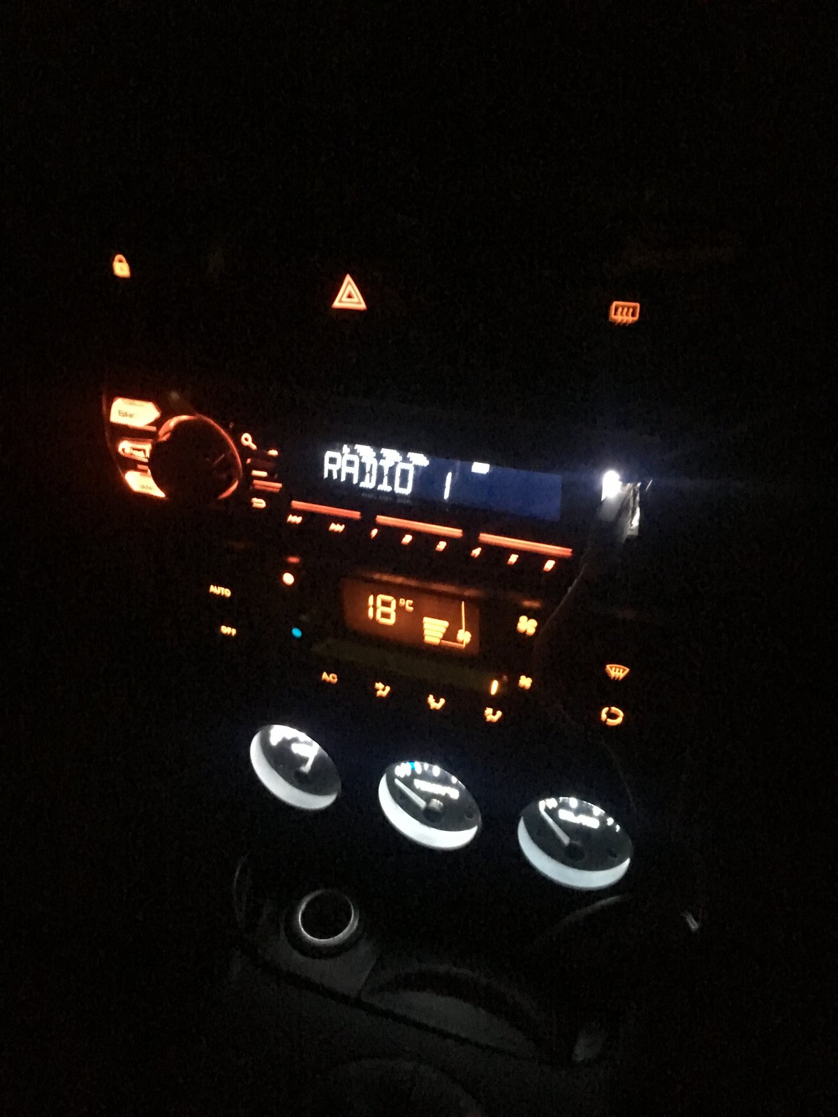

Replaced my flakey heater control panel face and replaced the dead right hand bulb from behind it. Now it's all together though it looks like the bulb the other side is dead (or just not as bright?), bit disappointing after all that!
Before:
After:

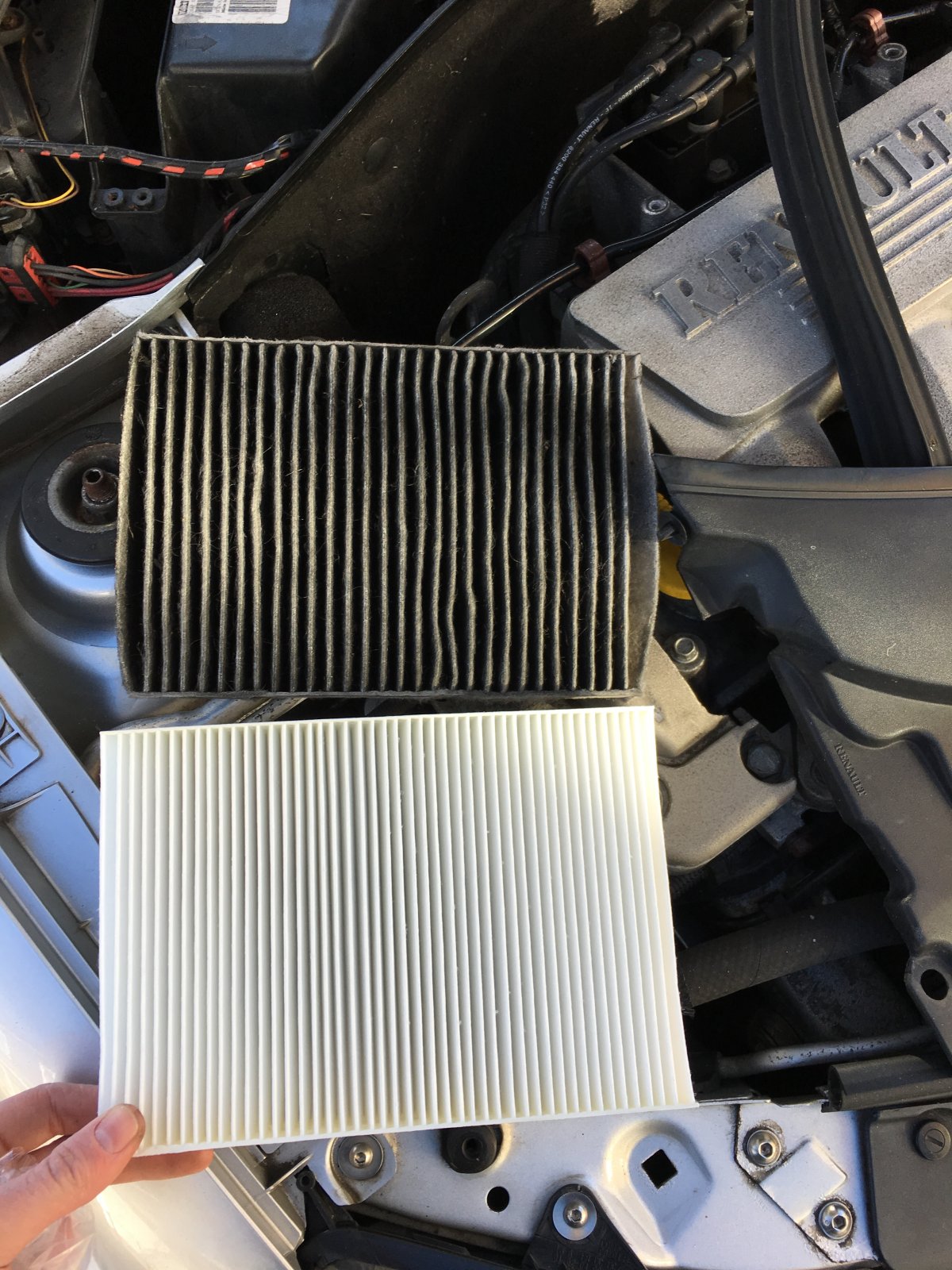

  • Change pollen filter

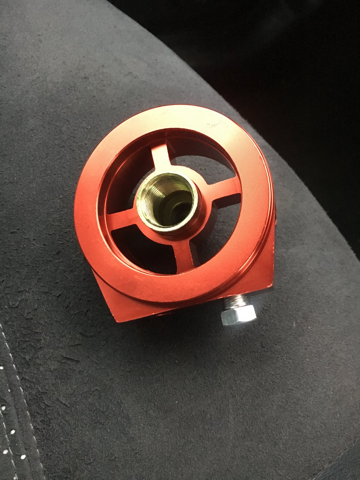

  • Install my pre-cat lambda

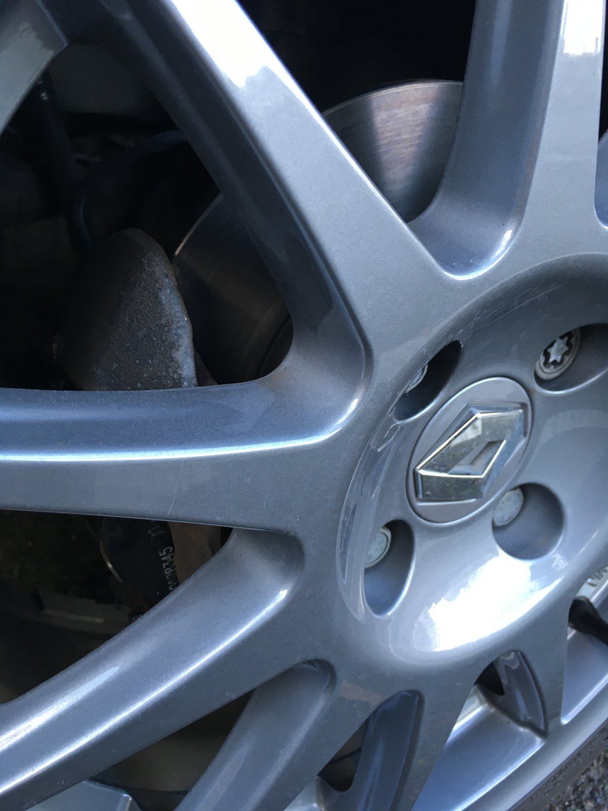

  • DS2500 pads on front
