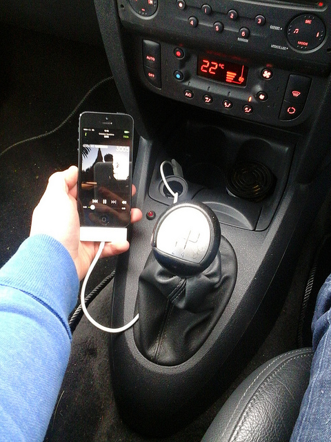

Aux Setup by Simon_89, on Flickr
Got a few things for Xmas to allow me to listen to my iPhone a bit easier in the car, this cable utilises an aux cable and charger into a dock.
I removed the cigarette lighter, covered any exposed metal on it to prevent any possible short circuits. I then fed the cables through the hole, rerouted the original aux cable down behind the head unit and to the area beneath the cup holders. Using a twin female audio connector I simply joined the wires up that attach from the aux cable that plugs into the back of the head unit and the aux cable from the iPhone dock and hey presto an audio solution that charges and plays music whilst not having cables all over the place

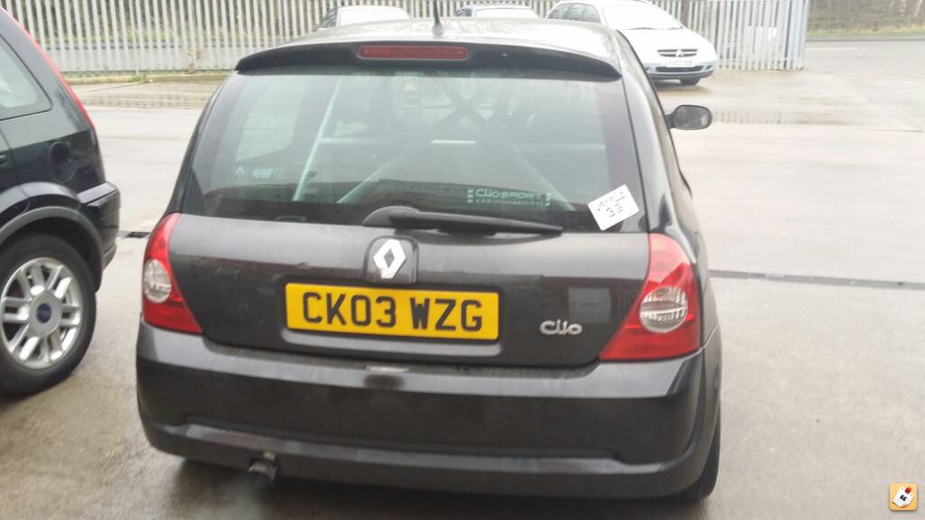

Took it out yestersay and it came back with a new addition:
Track filth = Grinning

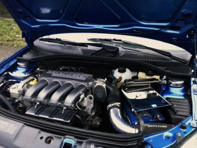

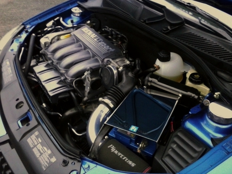

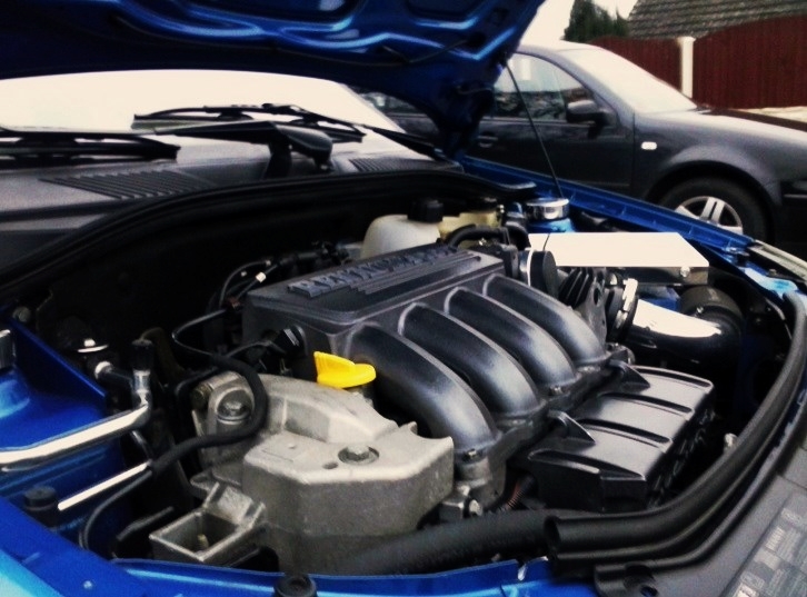

How did you get the engine looking like that? Looks smart.
Not that hard tbh mate.
Sprayed inlet manifold and fuel rail guard bmw sparkling graphite with polished writing
New coolant tank
Aluminium strut covers
Aluminium battery cover
90 degrees alloy induction bend
Polished the aircon pipes/aluminium parts etc
Hoovered/cleaned the engine carpet at the back of the bay
Sprayed engine bay with de greaser, used a small brush to remove dust/dirt
Sprayed engine bay with a q/d then wiped everything down clean
Treated all rubbers/plastics/wires with bumper/plastic dressing
Give the bay a final wipe down with a q/d
Think thats about it mate, i did have an engine cover fitted which i removed the other day due to me loosing the clip with holds the oil filler part to the cover, it looks crap without that part fitted so i have removed it for now, i think i am going to leave it off tho tbh.

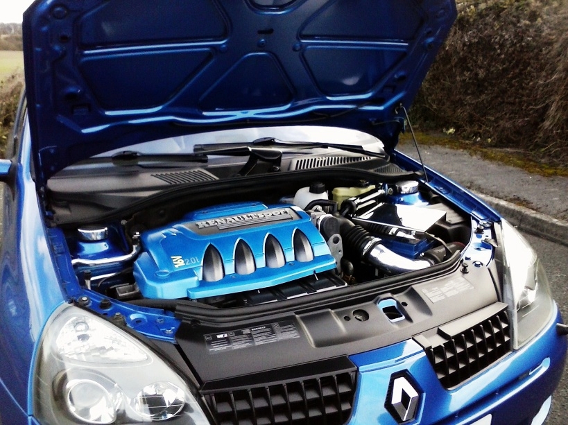

I did spray my engine cover arden blue with a yellow/blue 2.0l 16v sticker, heres a pic with that fitted for a comparison
