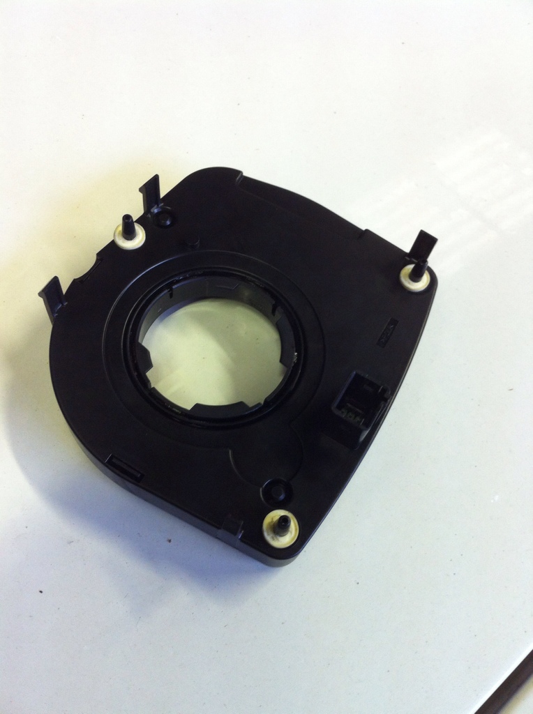

What is this part?!
Daniel
Car  Whichever has fuel
I need one of these for a 182 Cup.
But I can't find one because I don't know what it is or what it's called.
It sits on the steering column behind the steering wheel, and rotates inside itself.
I've typed that into ebay but nothing comes up like that.
The whole unit comes up (With the stalks still attatched) but I can't find that actual part and it's driving me mental!

Yea angle sensor, I touched mine in my 182 cup ONCE.
£200 later it was fixed ! All the insides unwound them self and threw up a couple of lights, had to get it plugged in to a Clip system to finally remove the faults.
I've changed one before, no programming required when I changed mine.
Make sure it's centred while fitting it (indicator window shows this) and it should be ok. You might get some TC/ABS lights but they disappear after a short drive ime.
Both myself and Jon.G needed it programming as it was a few thousand degrees out.

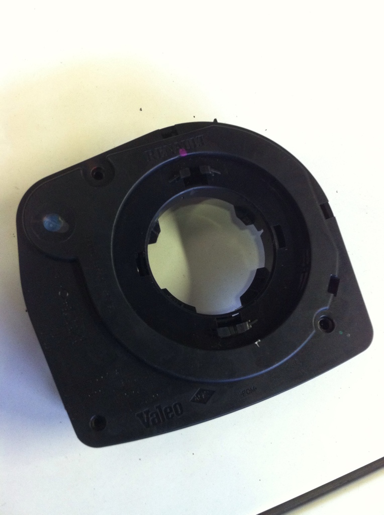

I know it as a steering angle sensor but some of the old boys at work call it a airbag clock sensor / squib.
needs to be an esp one only dan they are a right pain if you move them then it confuses them and they have to be re programmed! Think we should have one if you need one let me know and Il have a look for you :)
Aw hiya.
BTW, mines doesn't have that white wire coming out for the airbag(like that ebay link). Has it been chopped or is part of something else on the 182?
Aw hiya.
