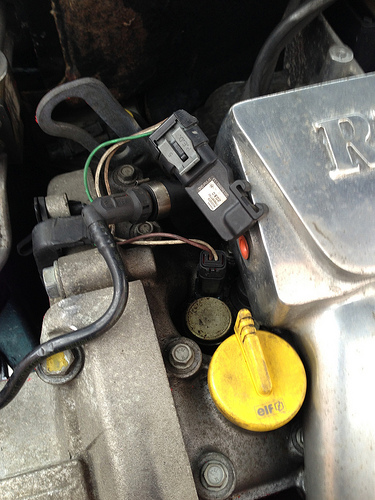

Pearce ClioSport Club Member Car 172 cup Mar 24, 2013 #1 This sensor is broken off what does it do It's the biggest one that looks like its snapped off out the inlet ? image by Pearce8, on Flickr
James ClioSport Moderator Car Clio 220 Trophy Mar 24, 2013 #3 Air pressure sensor, or temperature sensor I think. Someone will know for sure
Pearce ClioSport Club Member Car 172 cup Mar 24, 2013 #5 Would the car not start an would the engine management light come on if it was broke ?
172Ben Car BMW M3 Competition Mar 24, 2013 #6 When mine snapped off it wouldnt start, i glued it back on as a temp fix and it was very rough running. Not to expensive second hand
Pearce ClioSport Club Member Car 172 cup Mar 24, 2013 #7 Ill try that mate an get one ordered tomorrow cheers
MicKPM ClioSport Trader Car Clio16v/Zoe Z.E.50 Mar 24, 2013 #8 The MAP Sensor is pretty essential and ithe ECU shouldn't allow the car to run without it. if it did you could expect it to rev its nuts off to.
172Ben Car BMW M3 Competition Mar 24, 2013 #10 http://www.ebay.co.uk/itm/Renault-S...arts_Vehicles_CarParts_SM&hash=item3f0549e41a clio spares, £17.50 delivered. Think they were about £80 isn new from renault, but that was about 2 years ago and my memory is s**t!
